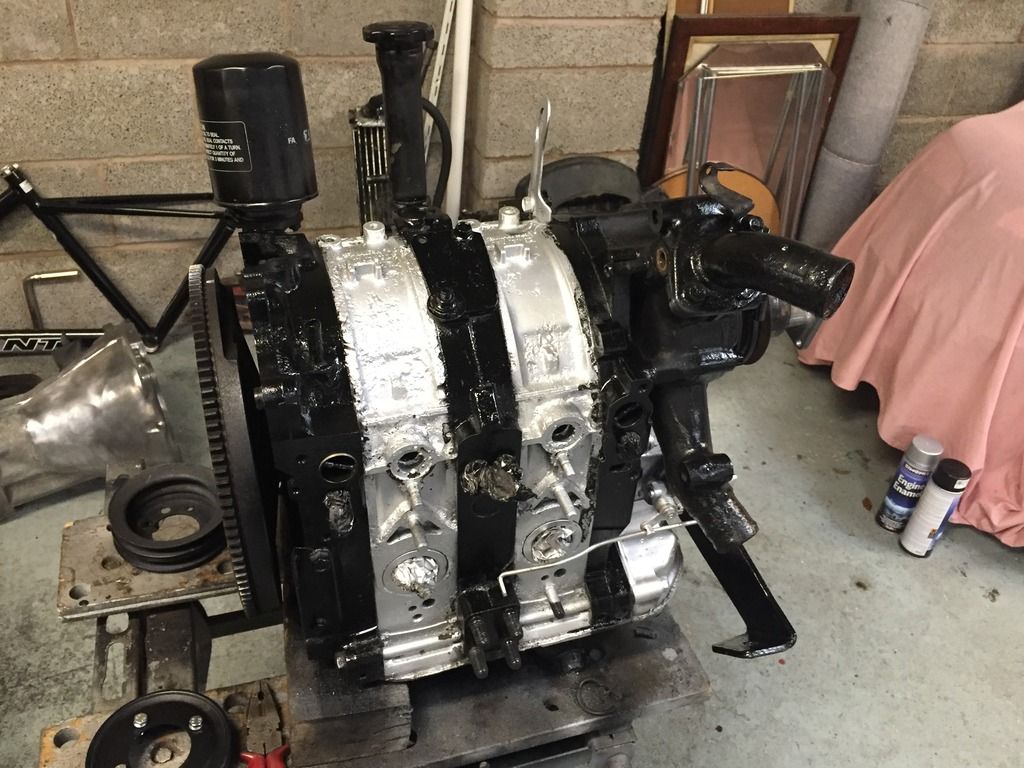

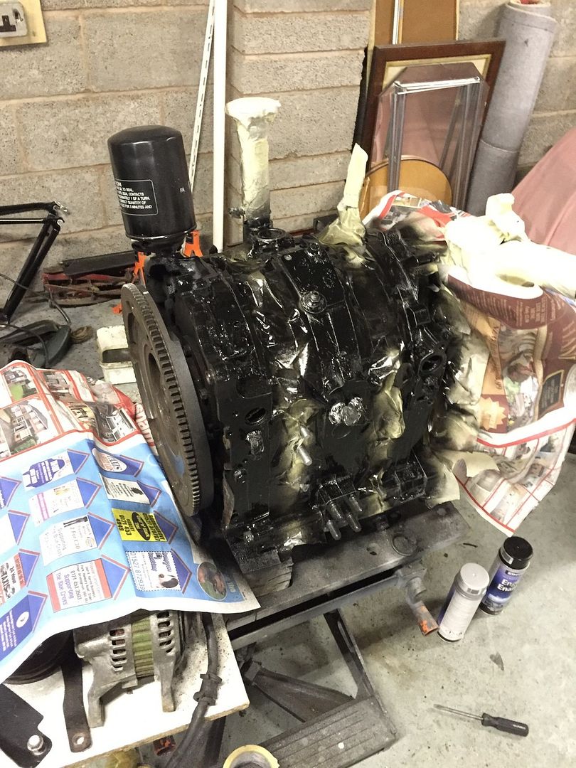

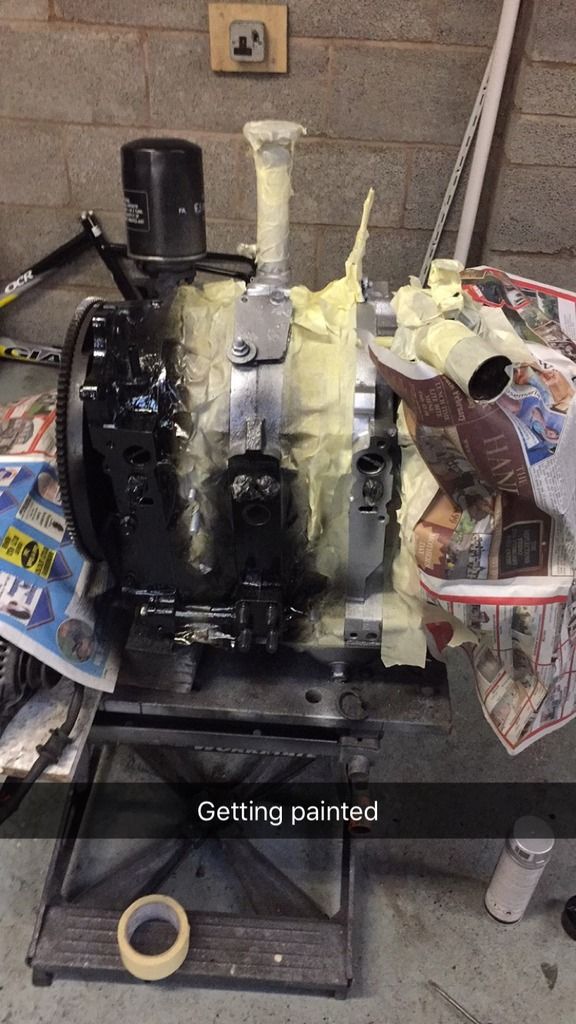

After cleaning up the block as much as I could I masked it up and got busy with some engine enamel
Then I flushed out all the coolant, lots of manky stuff came out, I took a while doing this until the water coming out of the block was nice and clear.
I think the scabby old block came out pretty well

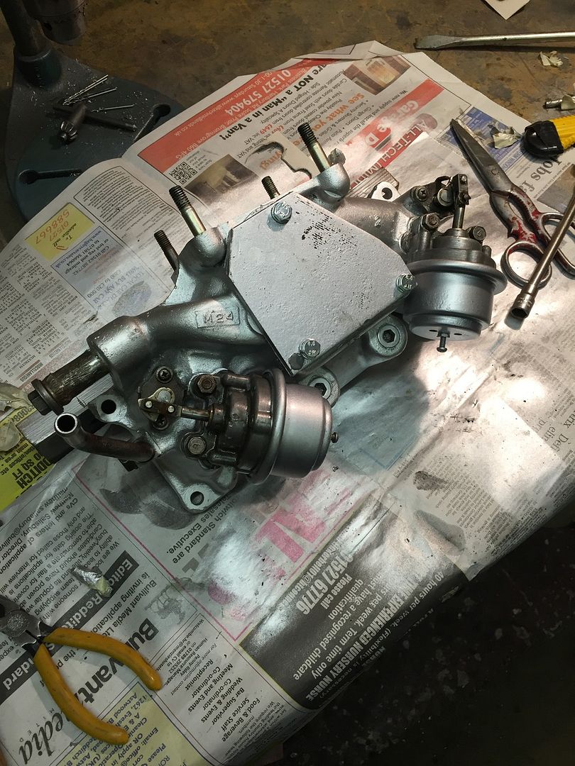

The inlet manifold needed a lot of work, I tidied up the inlet manifold, again more wire brushing and painting. I took the vacuum actuators off, freed them up and leak tested them, then removed the blanking plate off and had to de coke all the channels with drills and stuff, and opened them all out. I then had to free off and adjust the linkage for the actuators.

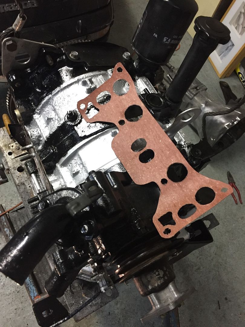

The inlet manifold gasket is very DIY. I just got some gasket material, made a paper template then punched out the shape.
I got the inlet back on

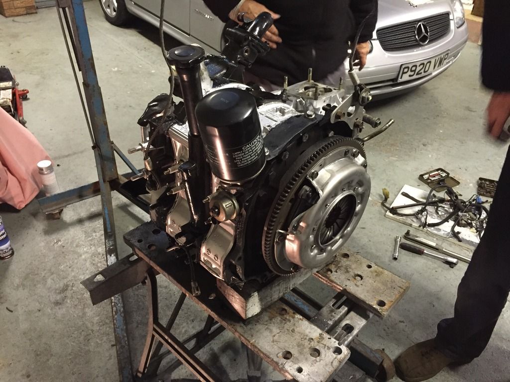

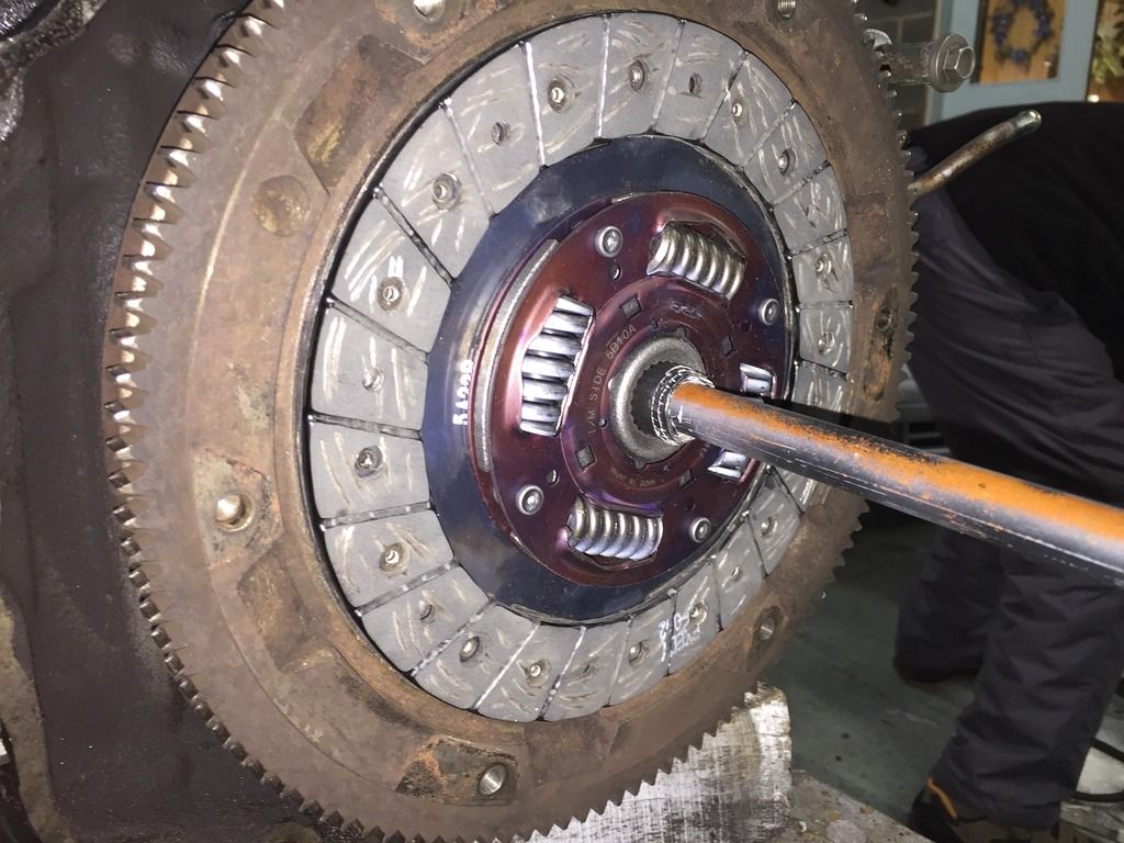

Fitted the new exedy clutch.
Bolted up the gearbox

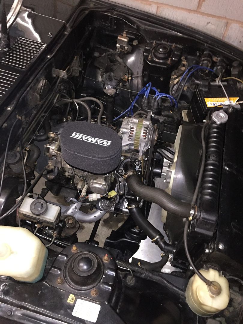

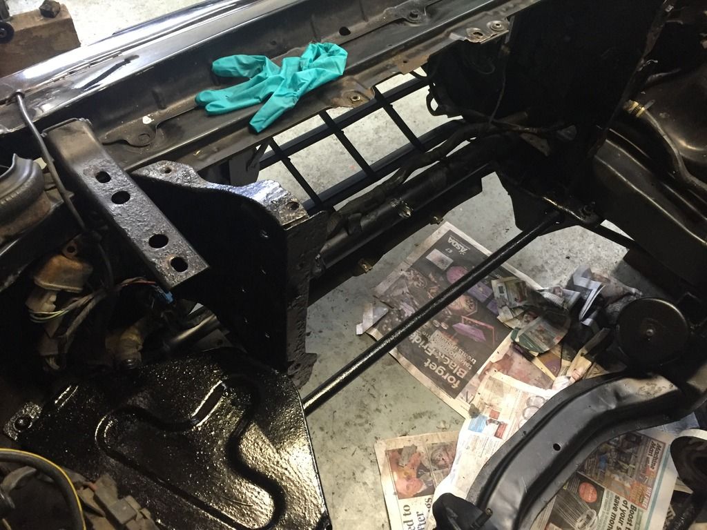

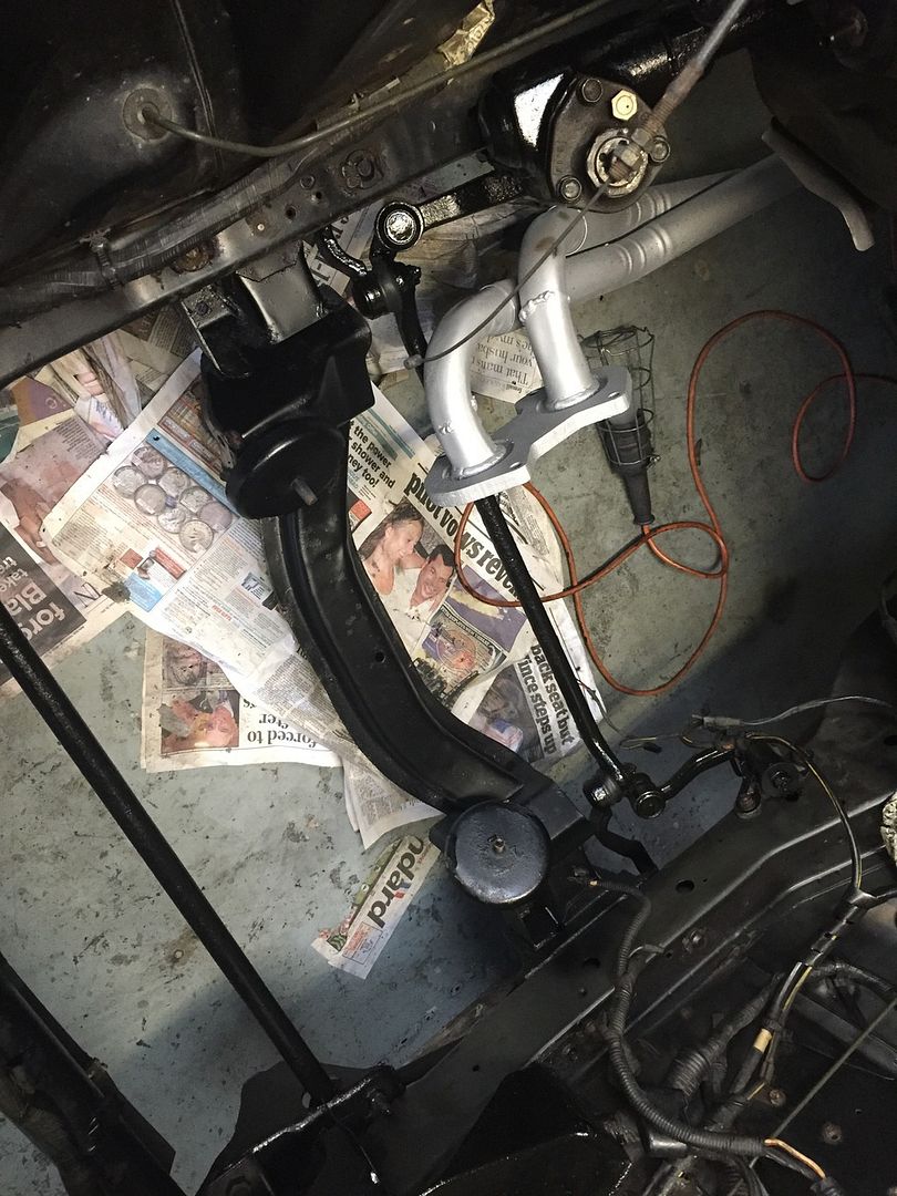

I spent some time cleaning up the engine bay, de greased it and repainted the cross member, painted the steering box, the roll bar and the steering linkage.I also repainted the gearbox cross piece, the propshaft and painted the exhaust shield in VHT all up the car.

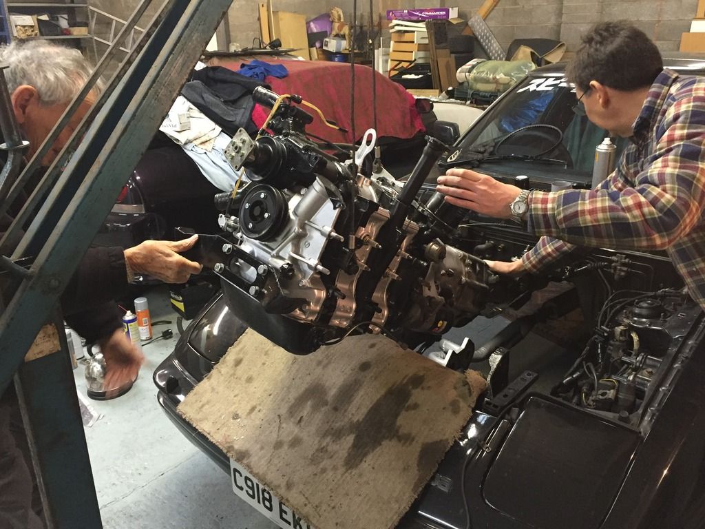

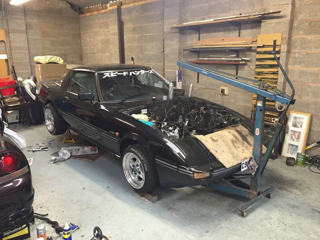

Then chucked the engine back in
I chucked this stuff in. It’s dutch and some people on the internet swore by it, so I gave it a go
I’m quite happy that the car is much tidier under the bonnet now.
I’ve got this air filter to replace the awful blue thing. I need to cut out the base plate to suit the nikki. Ill also get a catch can.

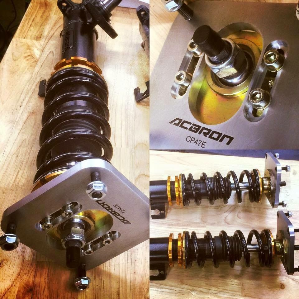

I’ve ordered a rather lovely set of coilovers from ACBRON. I’ve wanted coilovers since I’ve owned the car, and it’s taken me far too long to order any. The new ACBRON ones really look good, I know GAZ and T3 have been done, and it’s good to try something new. I don’t think they will arrive for a while 

The variabe induction is now working, which is great, but it only seems to open up at around 5500-6000rpm, which isn't early enough. the Actuators must have become more stiff over time, so the system needs a higher vacuum to operate. I think I may run it open all the time, or even figure out a way to operate the sleeves with electric servos instead of vacuum actuators, either wired to a switch in the car or use an arduino controller on an RPM switch.
Kroon Oil ... your engine should be singing with that -haha-
Also, my 'understanding' of the 6pi actuators is that they operate off exhaust back pressure. So maybe, since you are running headers as opposed to the factory 6pi manifold, you're generating less back pressure? Just a theory ... anyone can debunk this as they see fit ;)

Great update. The coilovers will really make a difference.

I understand the 13b 6 port actuators run off exhaust pressure, but my 12A actuators definitely run of vacuum, not positive exhaust pressure.
I can't wait for coilovers!
