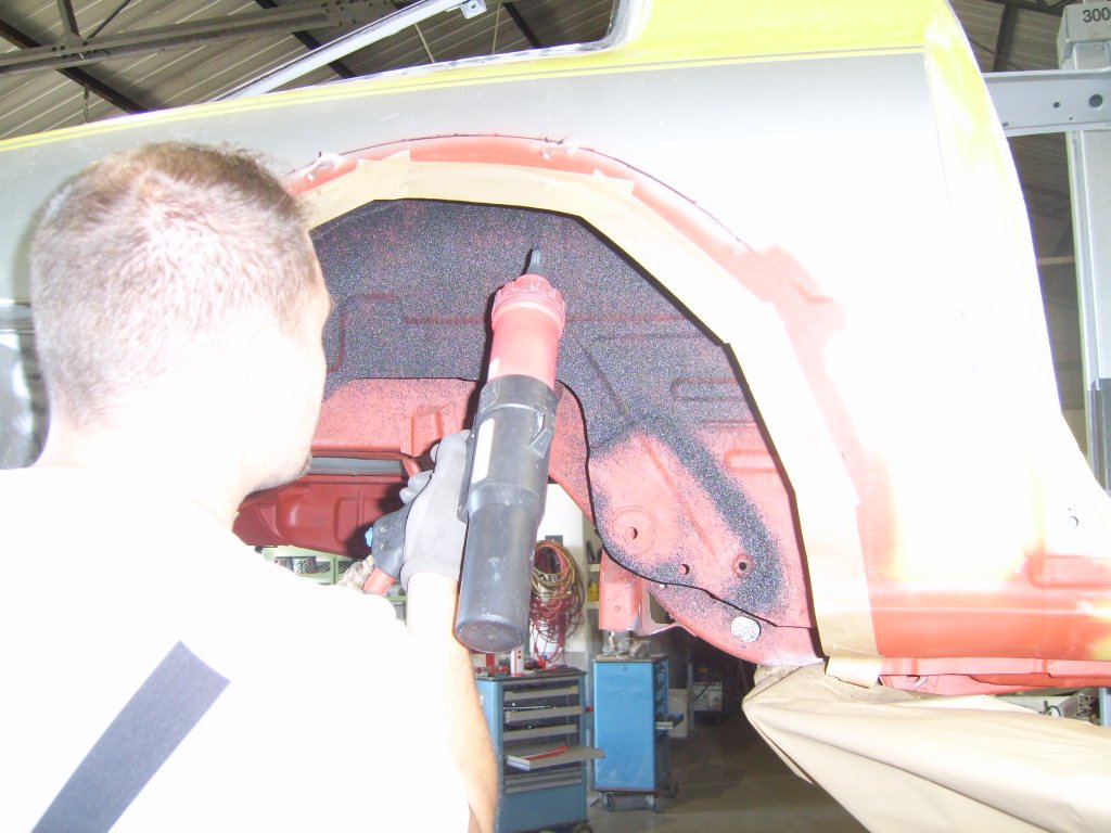

sprayed some würth body sealing compound and built the rusty part new.
