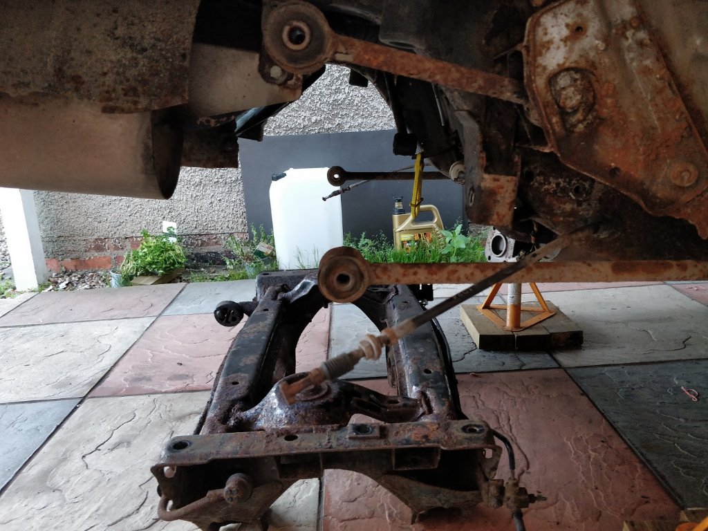

Also in a side not the IRS idea I had 99% sure won't work without cutting, the actual amount of space under the rear of the FB is very little. And while I suspect it could be made to fit without cutting the rear seat back, the frame rails would have to be sectioned almost back the floor itself which would be a big loss of strength without engineering suitable additional reinforcement to transfer the loads.

Yeah I don't think it will fit. Not even with my biggest hammer. :thumbdown:
