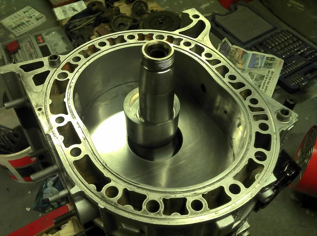

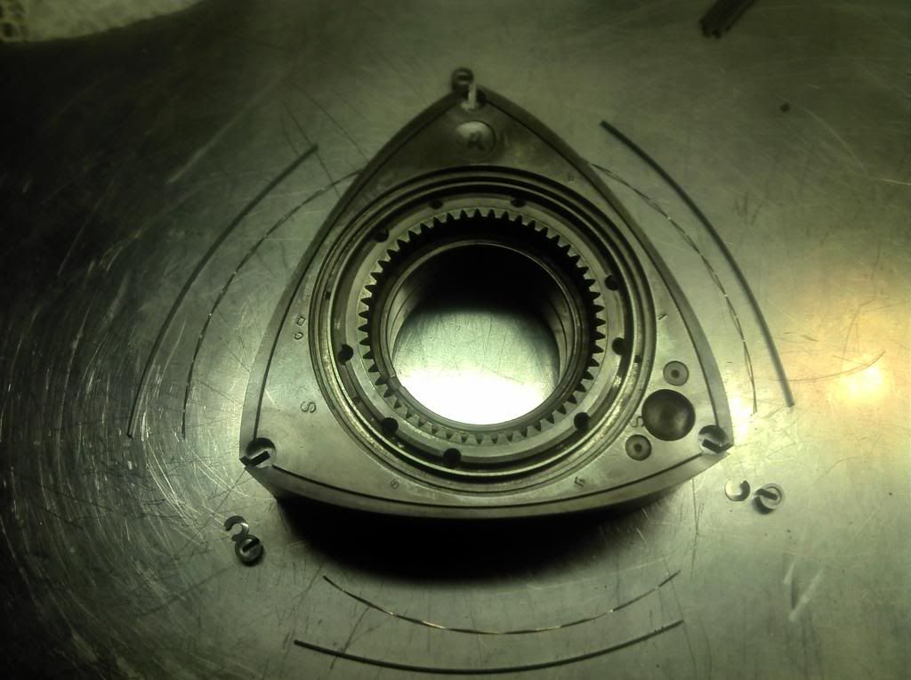

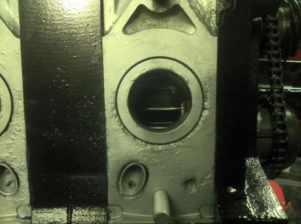

that's very impressive Adam.... I'm looking forward to hearing this run. Who actually cut the ports and as Damon says, what templates did you use?
Great work mate 0-0
Rexi84
Posts: 180
Location: West Midlands
Post by Rexi84 »
Thanks. All the plates are full bridge ported, the templates we used were xtreme rotories templates and all the porting was done in house by my dad.
'Dont fear the rotor'
BO0557
Posts: 363
Post by BO0557 »
Ohh nice one Adam - I was planning on going something similar on my new motor as the other plates I have weren't done to how I wanted..
Did you get a 12a or 13b template?? Ever thought of making some copies for a fee ;)
Rexi84
Posts: 180
Post by Rexi84 »
The template actually comes with 2 different sized bridge ports on it. We could be persuaded to make some templates up for a small fee. :)
I'd be up for a template if you decide to make any th:
Rexi84
Posts: 180
Post by Rexi84 »
When i get a bit of free time il look into transferring the templates onto some steel and see what we can throw together.

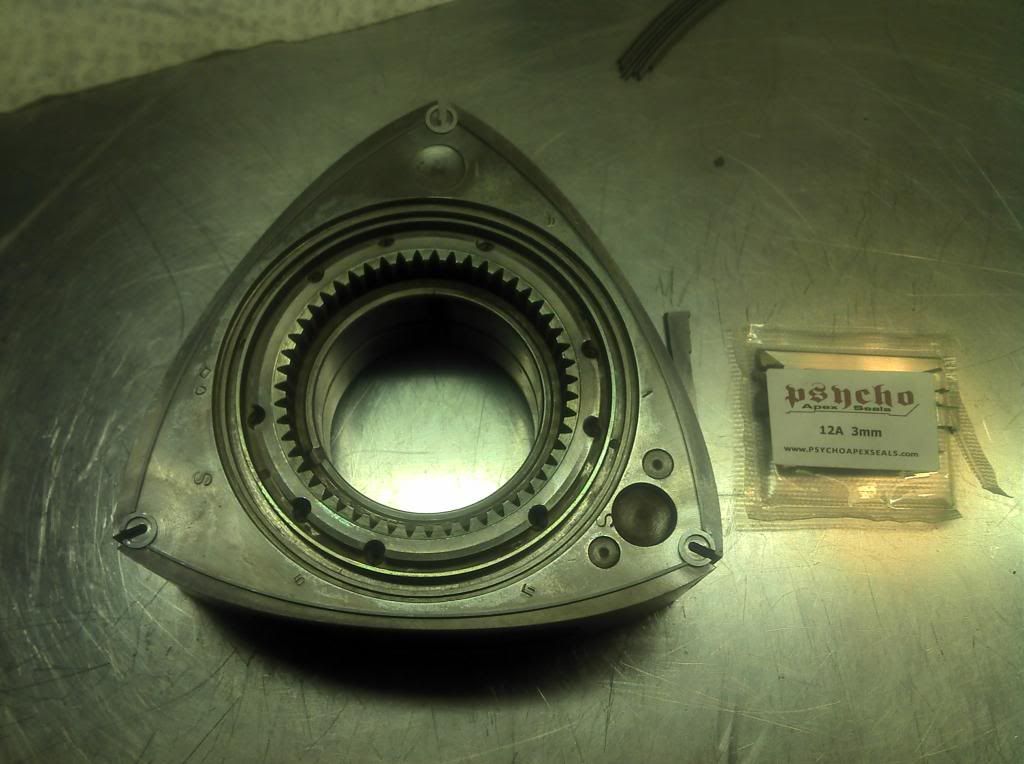

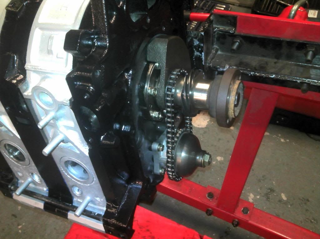

Rotors nearly ready to go.

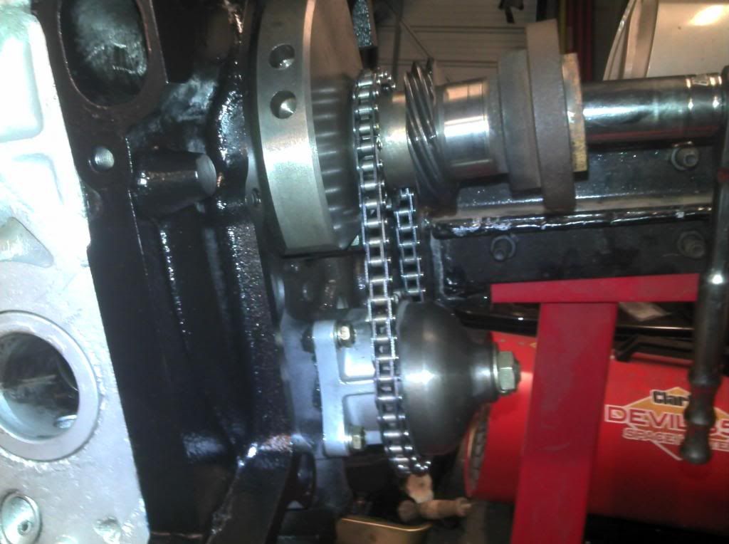

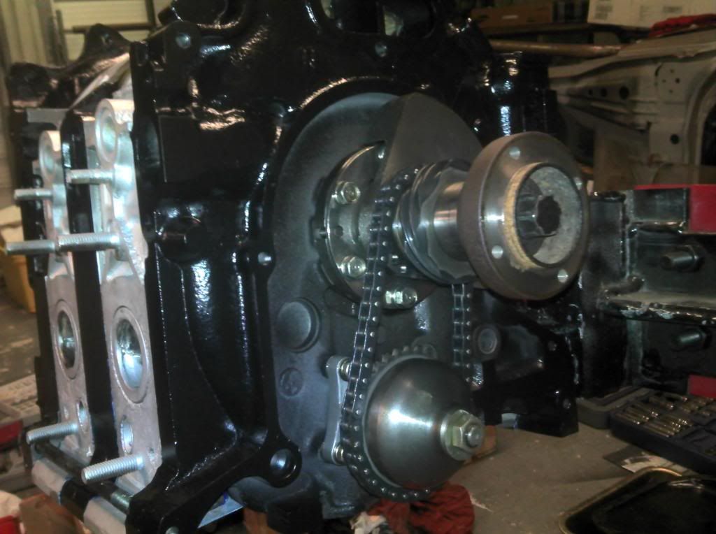

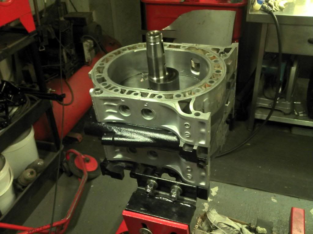

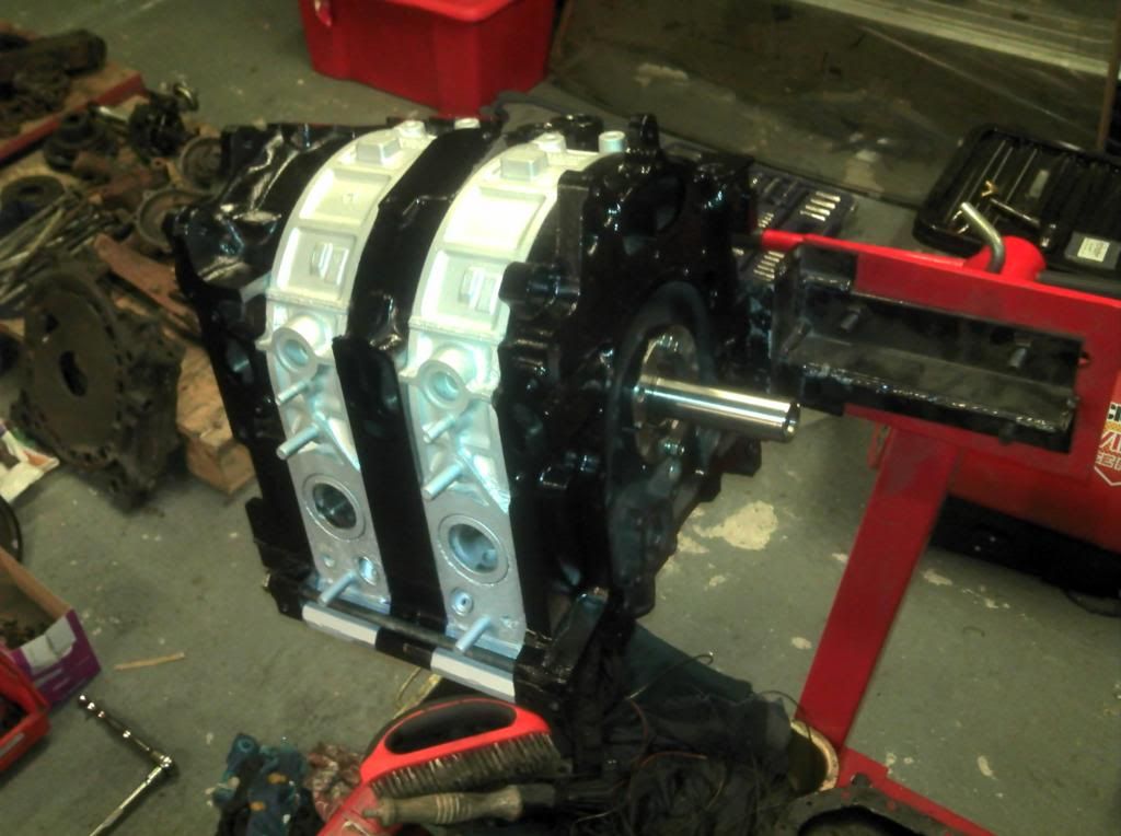

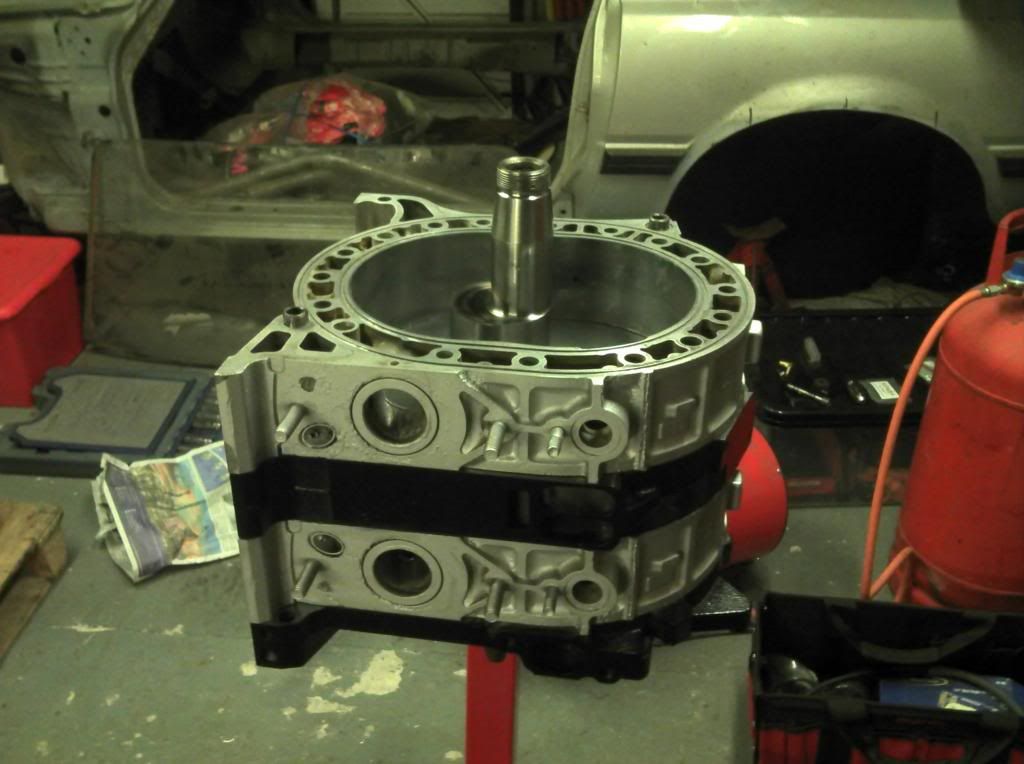

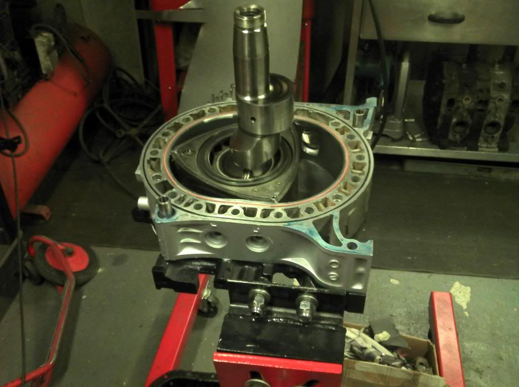

Engine going together nicely. :D
Looking good bro. The inner water seal join normally goes on the cold side though. Should be fine.
Rexi84
Posts: 180
Post by Rexi84 »
Thanks for pointing that out tool, momentary lapse of concentration. Luckily we didnt torque anything up so it was stripped back down tonight, seal join moved to cold side, built back up, torqued up and end float set.
