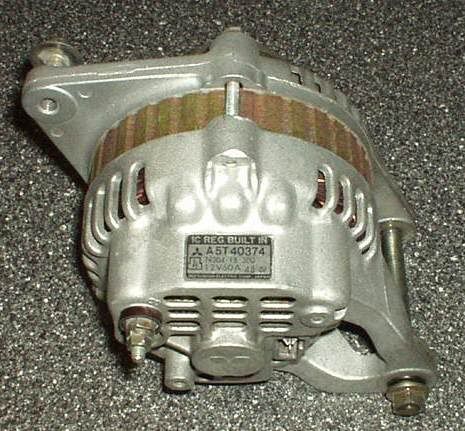

Pictures of various Rx7 alternators across all generations...
Series 1 / series 2 N221 50Amp

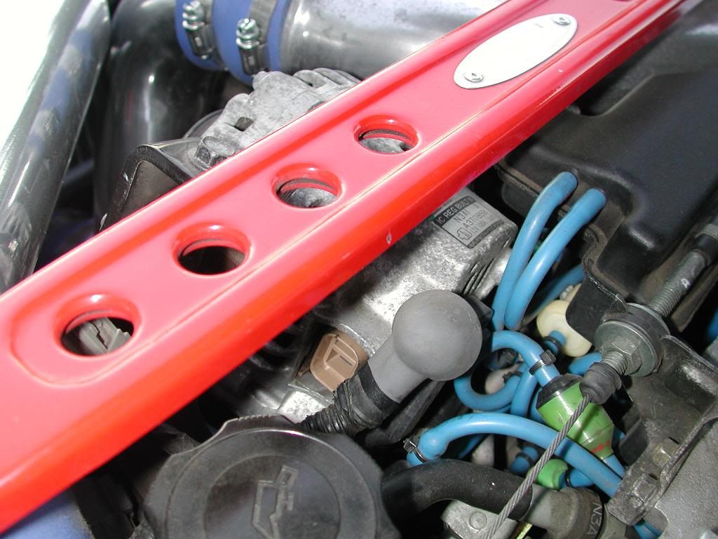

The following alternators are from later model RX7's... the use a different charging system and have a different connector....
They can be discounted really for use in a 1st gen RX7...
Series 5 '91 n/a N350 80 Amp
'91 Turbo N370 80 Amp
3rd gen N3A1 100 Amp
After series 4, they use a different connector plug to the white plug found on 1st gens....
