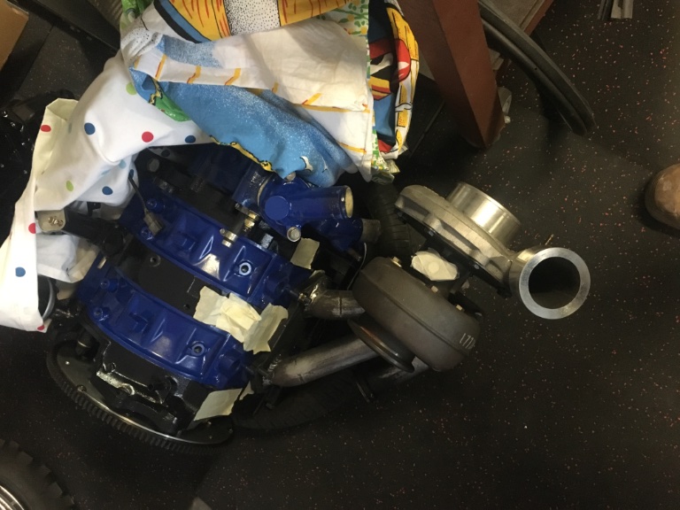

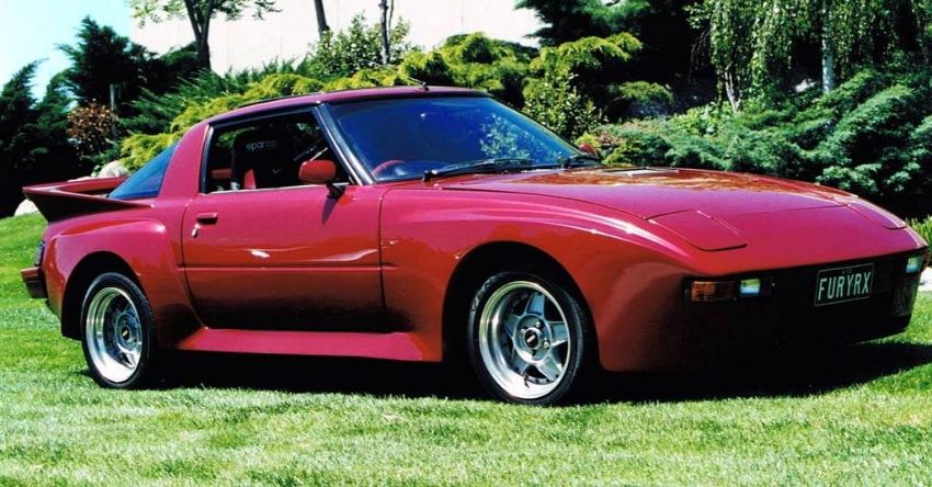

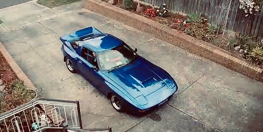

Hi my names Allan and I have owned my Daytona RX7 close to 20 years it has gone through 2 major rebuilds and is nearing completion of the 2nd one. For those that don't know what a Daytona RX7 was I'll post up a few pics that will help explain what the hell it is. Far as I know the kit was only produced and available in Australia and maybe NZ.

So hopefully that paints the picture of what it actually is.
Here's a few pics of how my car started life when I first purchased it and then the transformation through out the years.

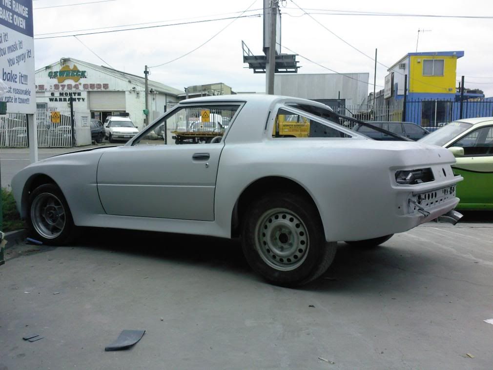

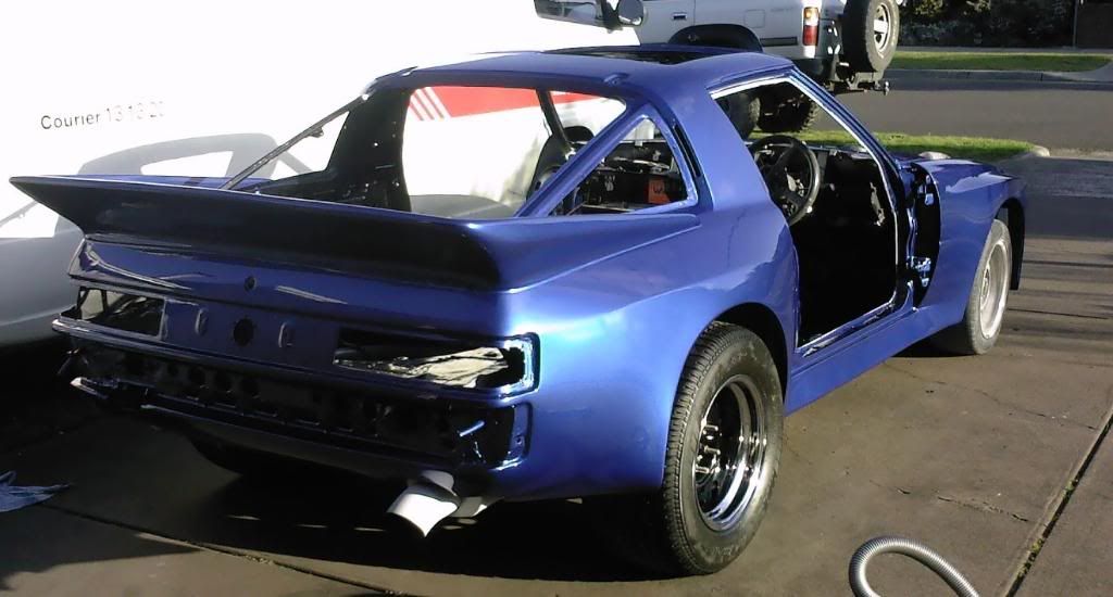

okay time to get the bodywork going-
remove the old wing
shaping the rear guards

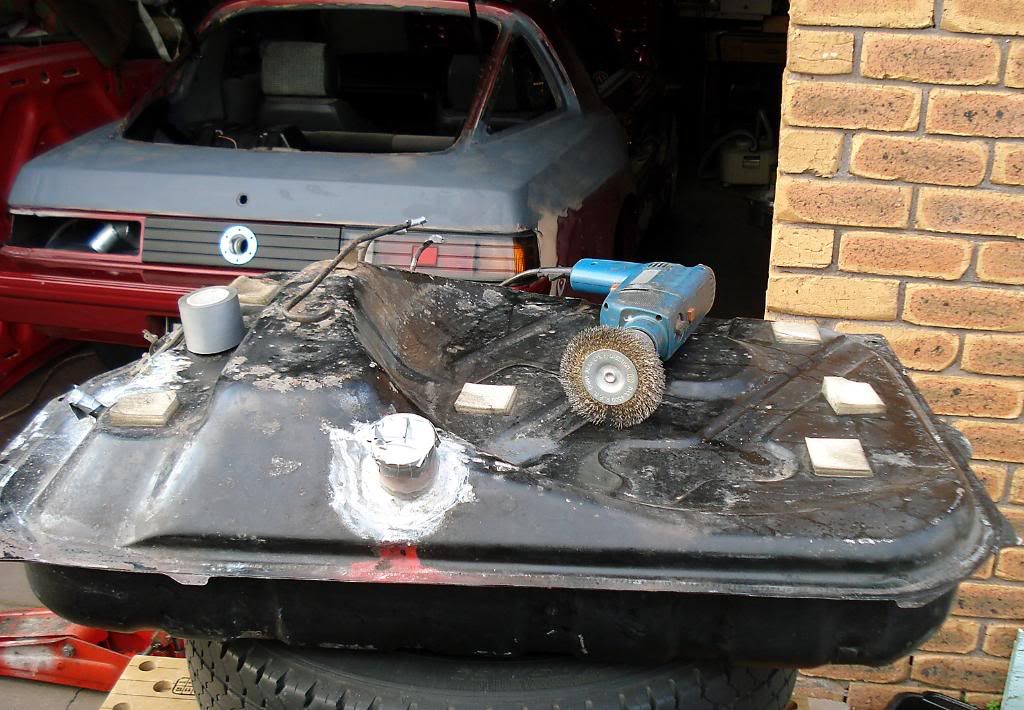

move petrol tank pipe to rear fill

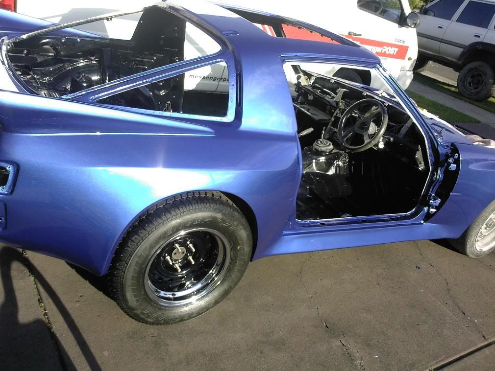

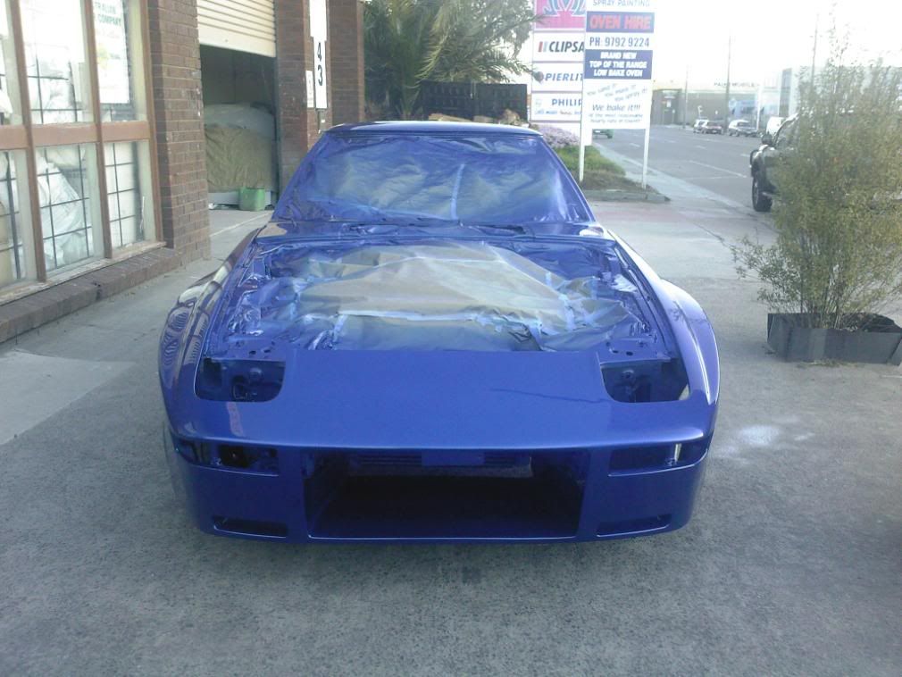

car at the panel beaters- came to an agreement with the owner that he would teach me to do the bodywork on my own car and he will paint it once its ready.
here's my brother inlaws rx4 coupe that gave me a heap of motivation to keep working on mine.
original daytona wing moulded back on

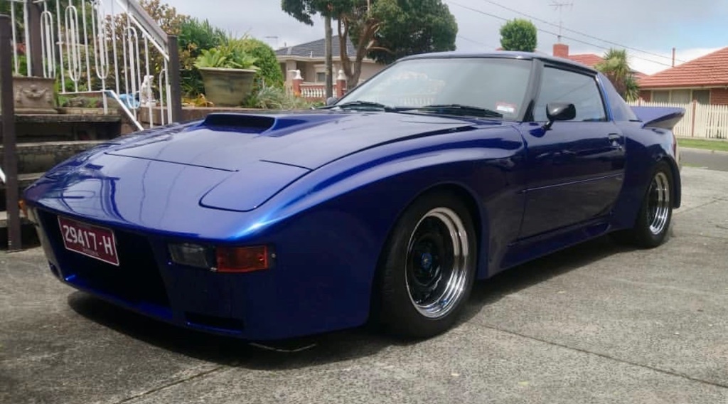

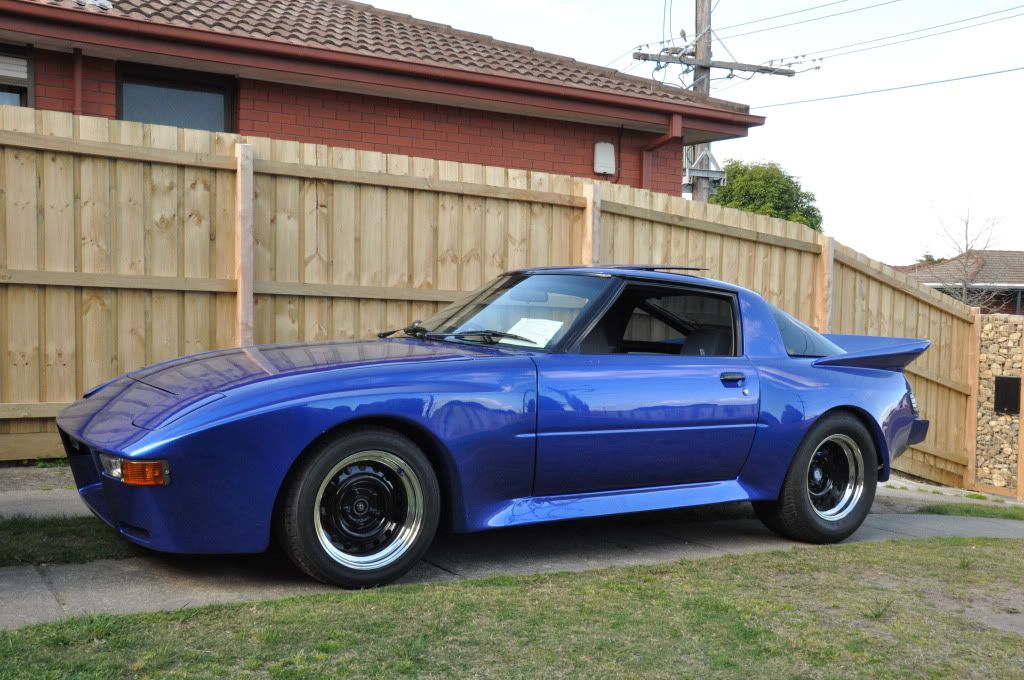

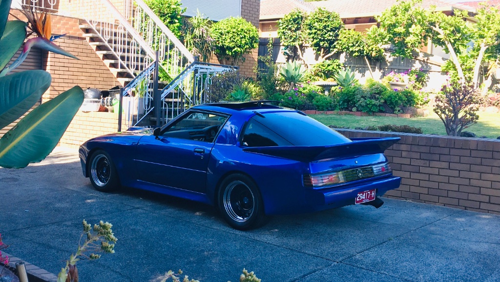

wanted to change the color so decided on B17 Daytona Blue (nissan 350z current color)

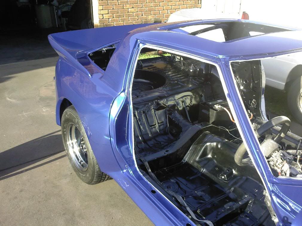

car back at home and the color is amazing it just shines and sparkles in the sun. photos don't do it justice.

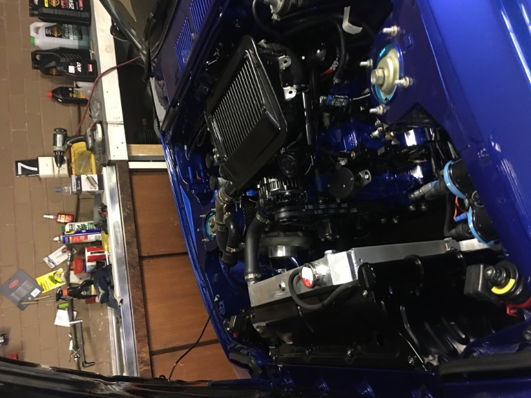

slowly putting it all back together. some new number plates to go with the new look.
planning on new brake upgrade, all new ball joints and suspension components, rubbers, some powder coating etc

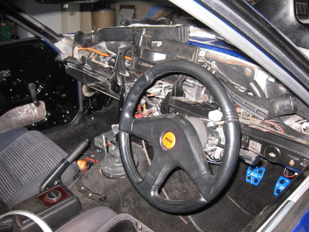

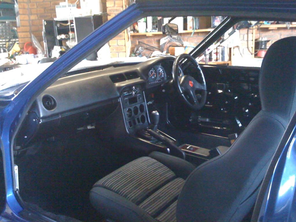

few weeks later the dash is picked up and looks better than new, couldnt wait to throw it back in. some series 5 rx7 seats fit and look right at home.
some gauges have been bought and some holes are cut in the dash in preparation. starting to look like a car interior now

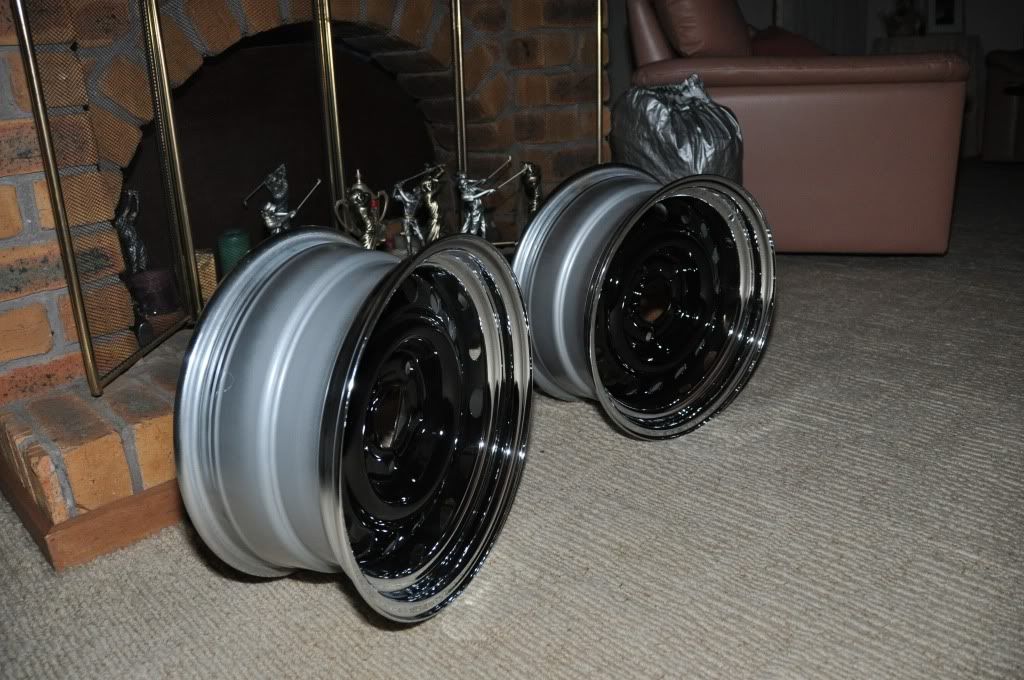

custom wheels are made up for the front. the rears were made while the car was being painted.
wheels - 5 stud GMH Holden Steel Interceptors. Centres were pressed out and hit with gloss black. 10 & 8 inch chrome dish rims were ordered from the States. Wheel company welds in painted centers as to my offset requirements.

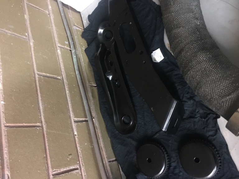

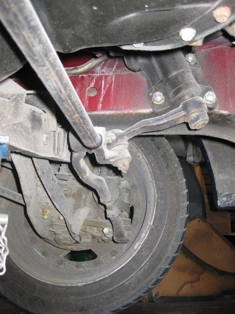

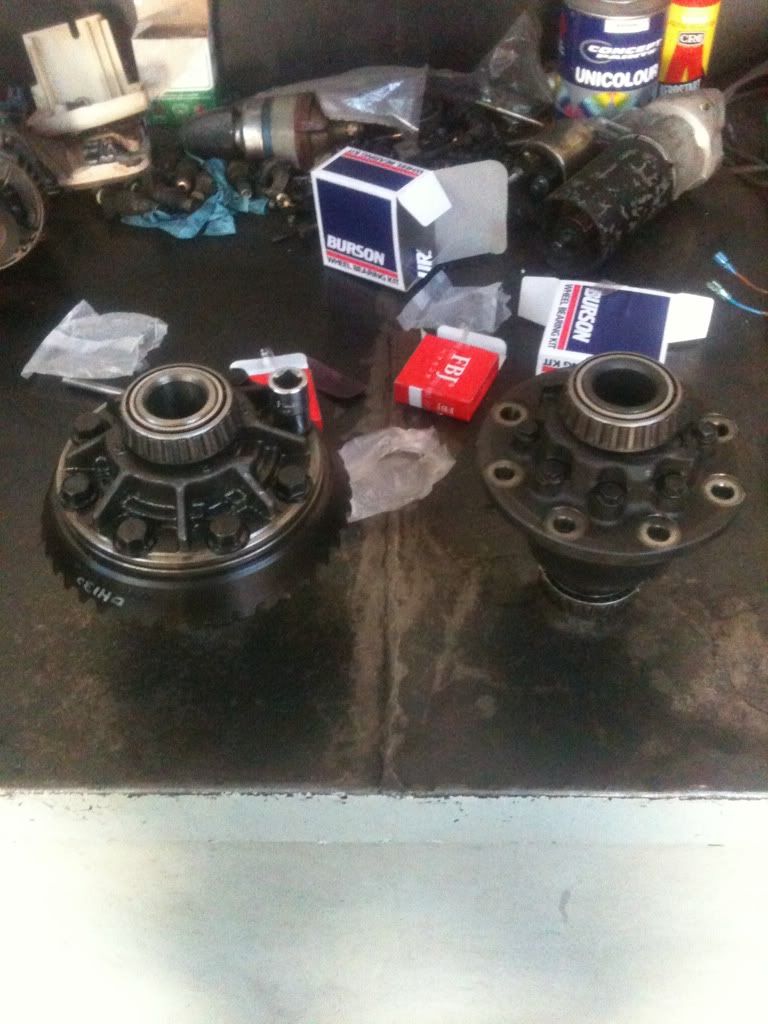

rear diff is a borg warner cut down running 28spline axles. 4.1 mini spool. saved up and purchased a rebuilt LSD and got a mate to assist in throwing it in.

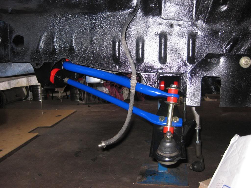

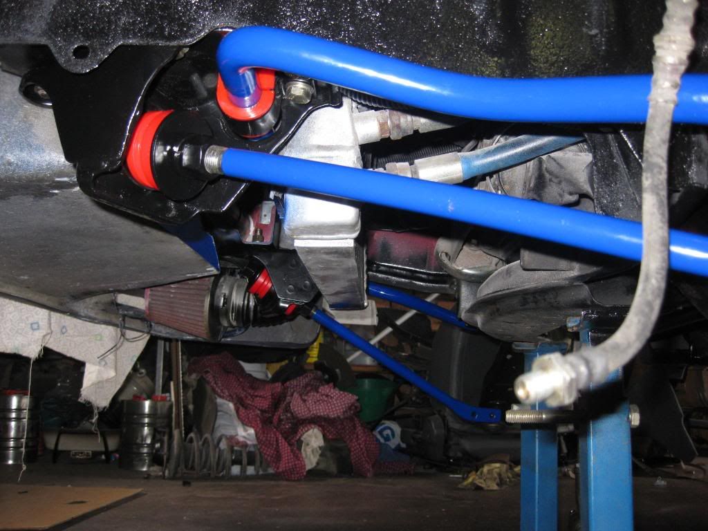

suspension painted and put back together- looks a million time better

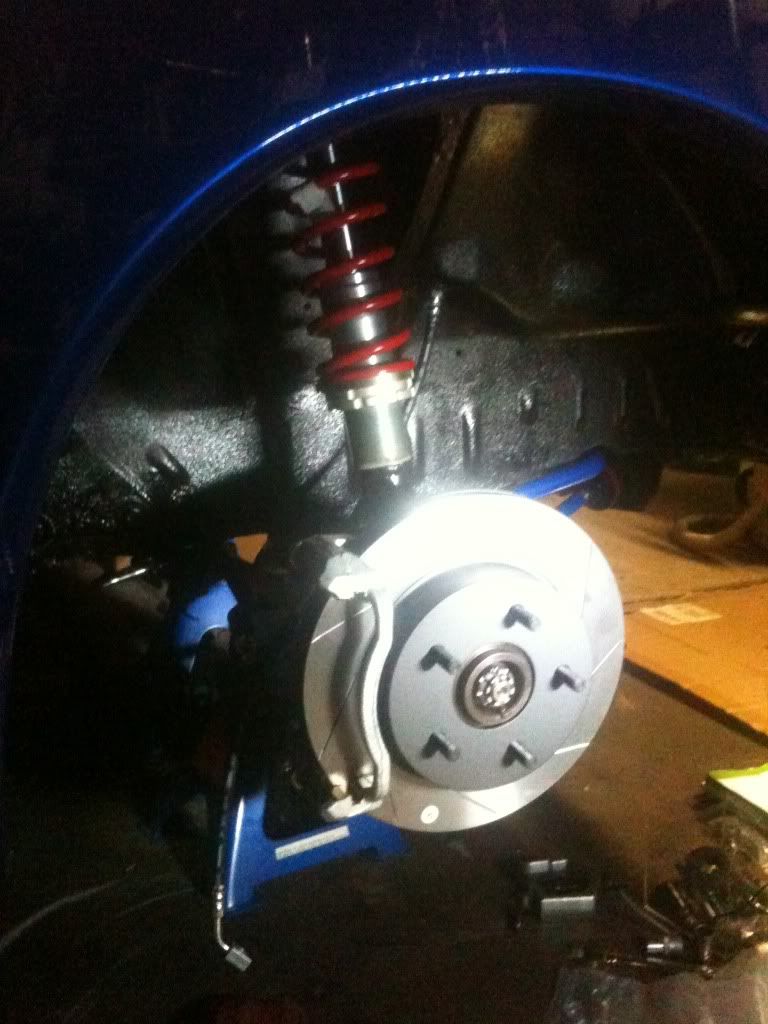

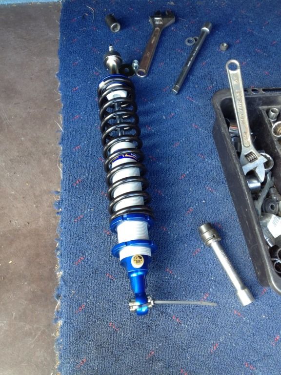

6 month wait for the coilovers to be made up- a custom bilstein coilover setup as used in IPRA RX7 racecars.

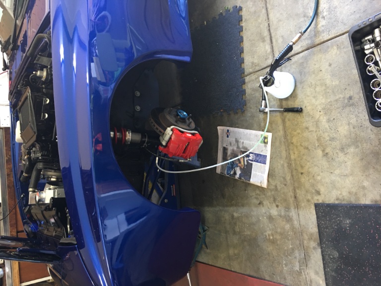

brakes a AU Ford bought as a bolt on kit made by Hopper Stoppers Brakes.
got some camber now

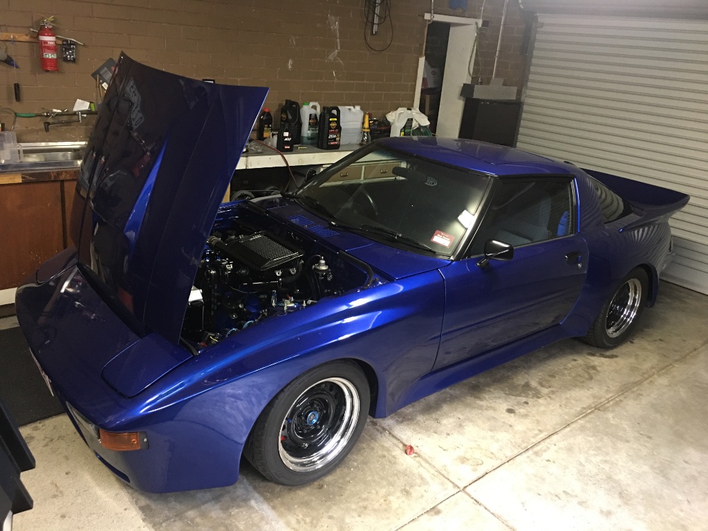

thanks goes to this forum for the info and some advice from a member on here, I purchased some GAZ gold coilovers for the rear. they look nice 8-)
