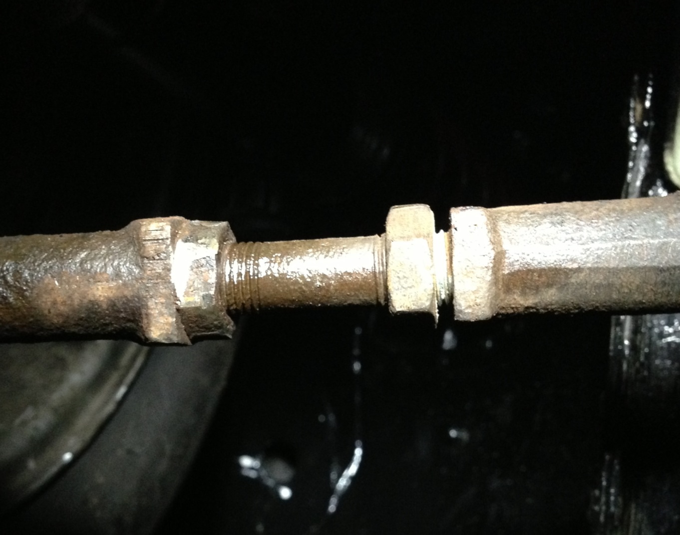

Post by BO0557 »
This is the rounded one I'm talking about...

Re: Help needed... Tie rod nut rounded / locked solid!!
Post by elwood »
Have you tried a pair of large pipe wrenches? The teeth can usually bite into rounded nuts.
Looks like a left hander to me ;)
Did you sort it ?
