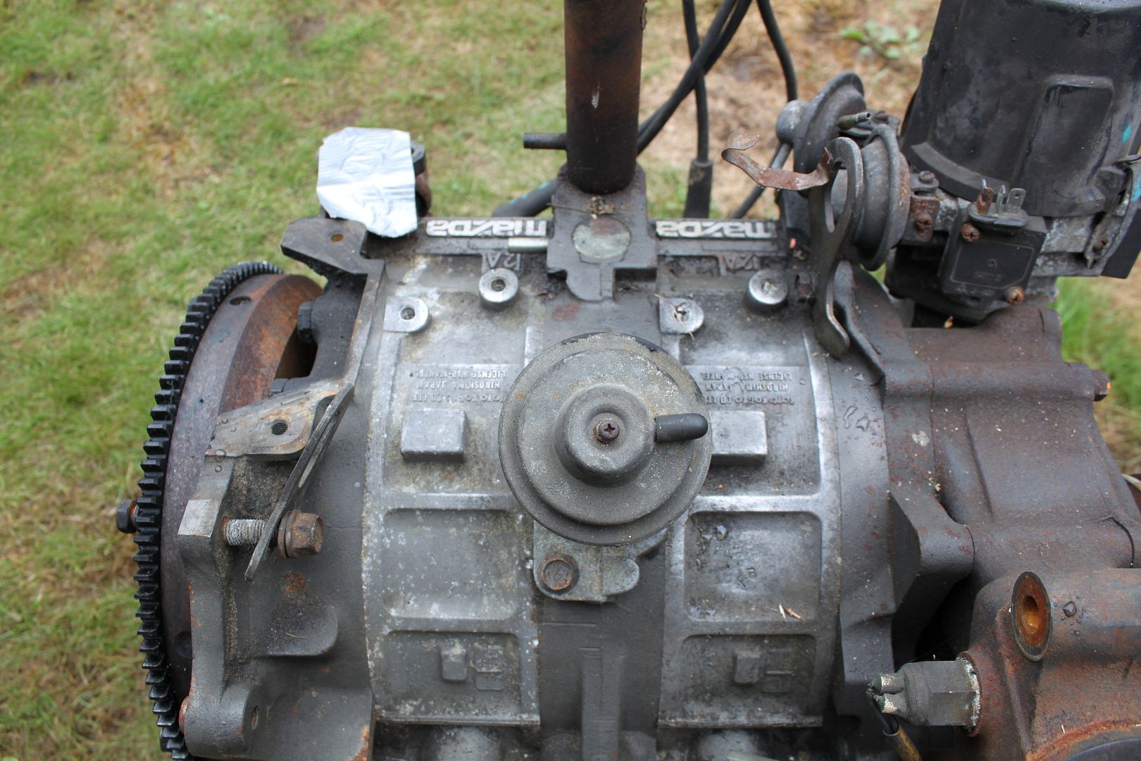

top view showing the EGR...

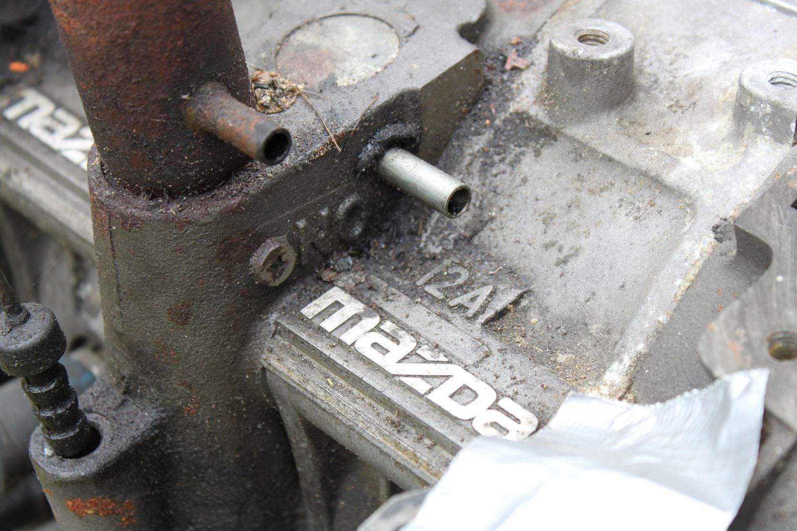

the tell tale blank raised piece above the Mazda logo denoting its a R5, plus the NO casting on the intermediate plate

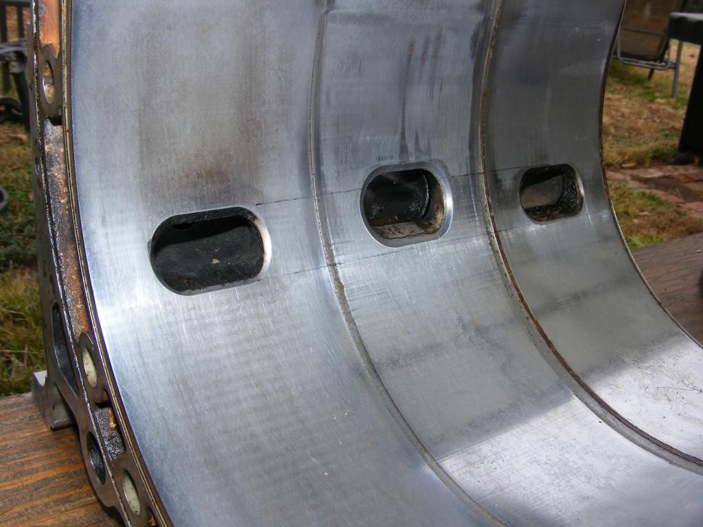

and the puny NO inlet ports...

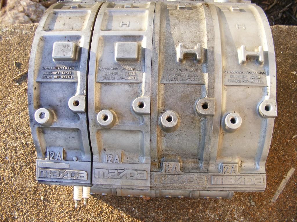

Here's a R5 housing on the left next to standard housings...
here's the R5 in the centre of 2 standard housings with a line drawn across them for comparison...
From the top, the blank raised piece above the logo identifies the R5 housings and distinguishes them from stock housings...

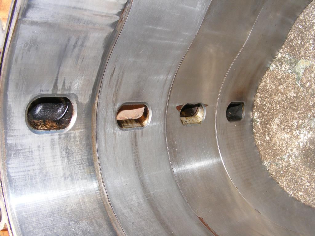

here's the NO intermediate plate ports compared to the Y plate ports....
From the outside...
and the inside...
Y plate is the way to go.
Regards the rotating assembly, I reckon you're right, keep the R5 rotors and swap out the heavy S1 flywheel and put in a lighter S2 fly.
