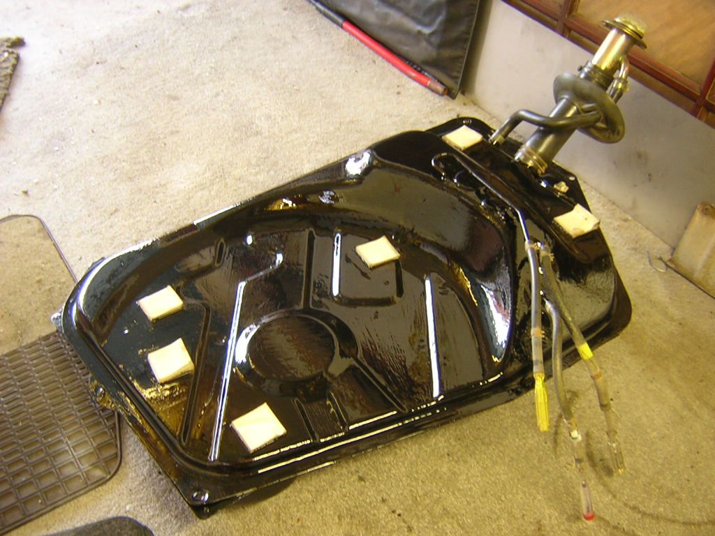

Plan was to clean up the underside/rear end. refurb the tank, (see pic its messy but solid) Flush the coolant (rad will be rebuilt at a later date) so I could start her up each week bring it up to temperature keeping the engine sweet whilst laid up for what I think could be 12+ months. Like your thoughts on this, if you think this is required/good thing to do or not. What the other options are with regards to laid up cars engine?
couple of pics....
poorly tank..

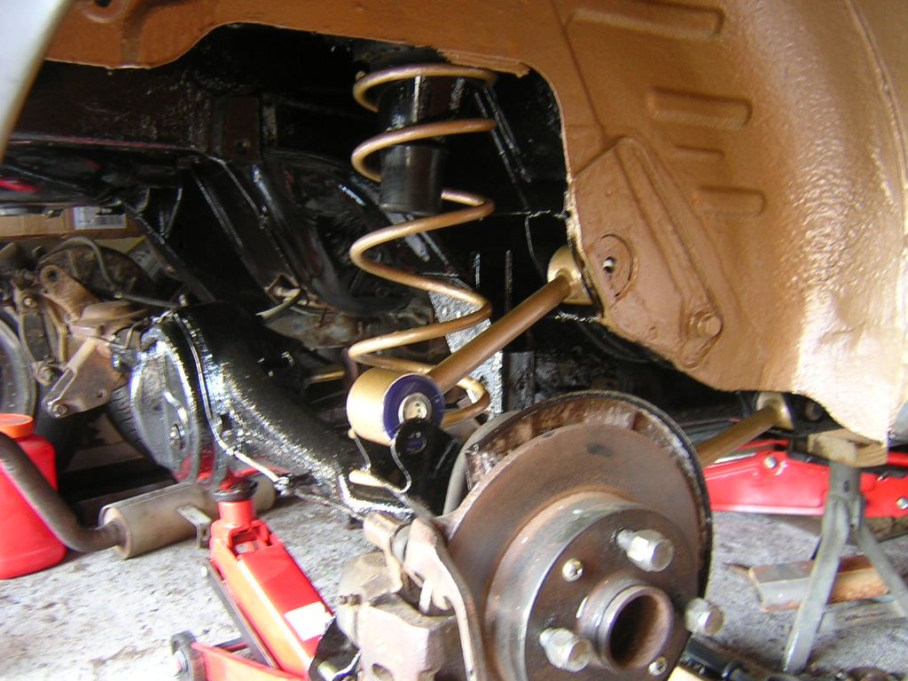

I could see someone had already coated the parts of the chassis you could see so the rear end is pretty clean. It’s all the parts attached to it which need the work, all covered in surface rust,pics actually make it look worse!
and another scabby pic, rear end needs a complete strip down and replace shocks/springs/bushes and complete brake rebuild. Chassis/axle will be cleaned and por-15’d. nothing like a challange!!!

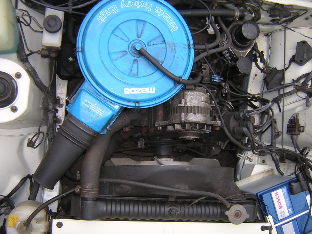

Front end not started yet but as above stripped all body work/bonnet to get a better look at the chassis legs and all the “rust points” this great forum pointed out. I did check this before purchasing but without banging the hell out of it you still don’t know truly what’s underneath. Well…Chassis legs are good throughout the engine bay area. Two patches 10p size near the steering box and think it’s the idler on the opposite side. One 10p sized patch where the inner wing meets the firewall on the nearside. Suspension struts good, one patch on the off-side about the size of a 5p. Other than that the engine bay just needs a spruce up.
So the biggest job looks to be both sides of the chassis legs kinda in-line where the wings meet the doors. May need to cut out about 4inches and replace a section. The rest of the rails are solid. So jobs for this Thursday is to get under there and see how bad it really is when I wire wheel it! Updates/pics to come Thursday night, here’s praying for no surprises!
