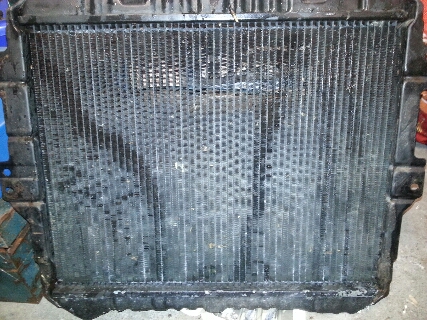

Anyway i decided to crack on and I thought the radiator might need re-cored, but once off it seems fine other than the colour of the "coolant". I think its been rebuilt recently.

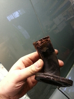

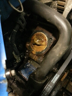

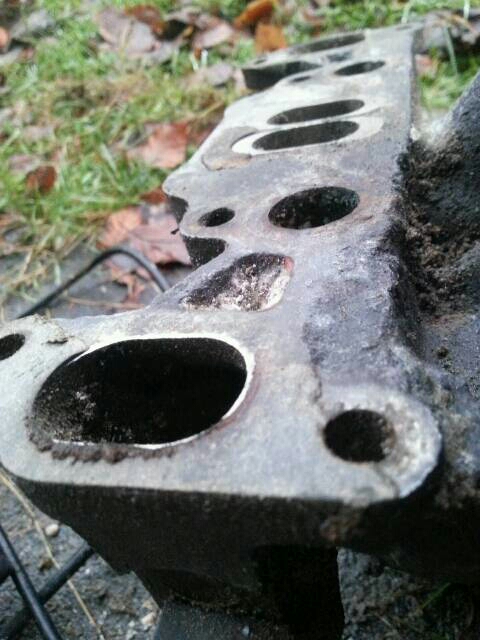

I had a look at the thermostat, and the top part, the metal hose looks past its best, but even more worrying is the crud thats blocking it all up. Clearly the coolant can still flow but I fear for the coolant passages in the engine itself.
Ive attached some photos, whats your throughts? Im thinking of pulling the thermostat and water pump too and see the mess there in. I dont think it will be pretty :-(
I am really concerned about the internal water passages, is there an easy fix. I done want to destroy the coolant seals with a chemical cleaner ( if theres such a thing) but clearly theres going to be issues in there :(

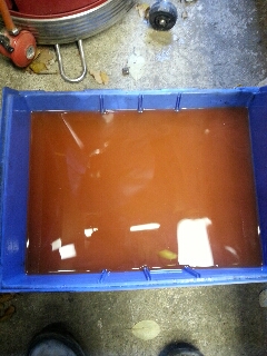

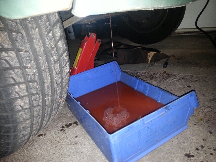

Out with the old coolant. Looks very poor condition. .
perfectly fine radiator :)

Thermostat, works fine, worryingly covered in gunk...

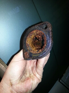

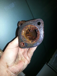

Hose feom thermostat, poor condition but this is what im worried the internals to the engine and water pump are clogged with...

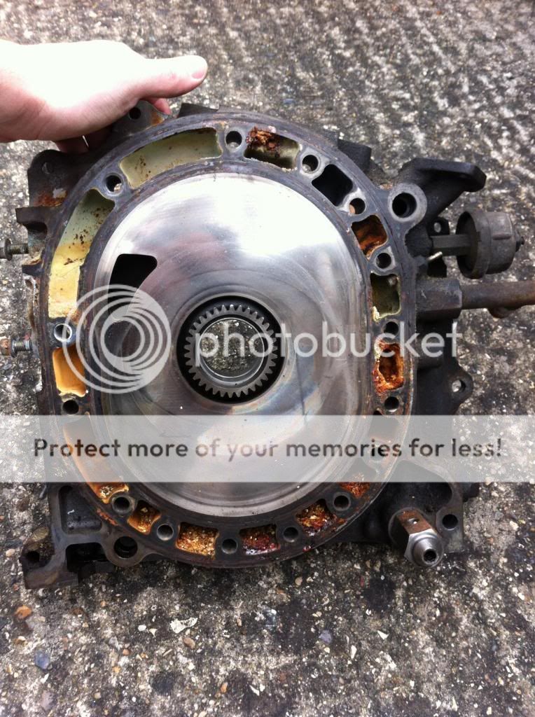

Re: cooling system refresh....
Yeah, you'll have a motor full of that stuff.

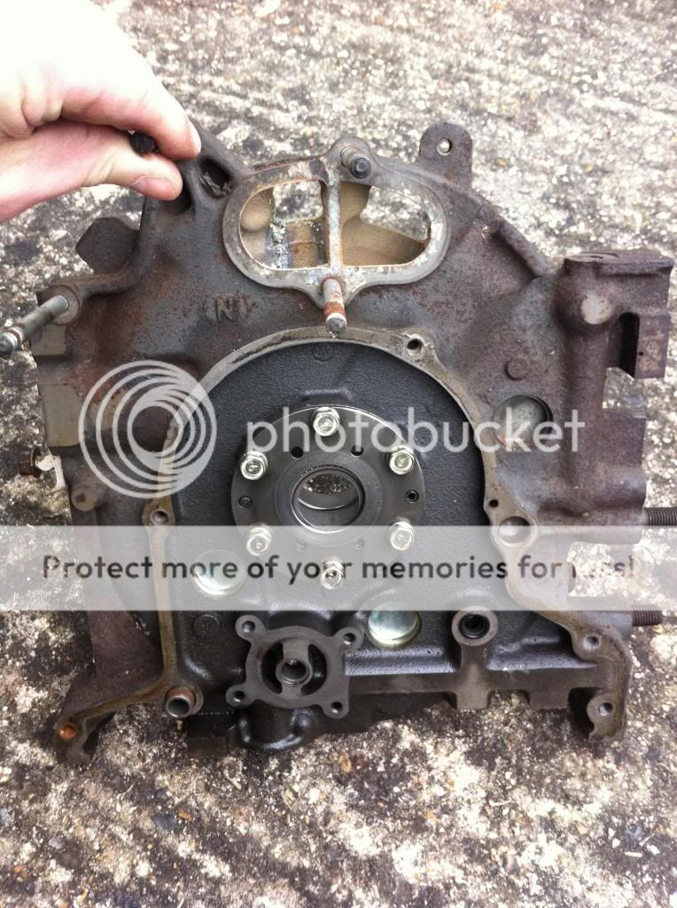

Here's an example of a relatively good motor:

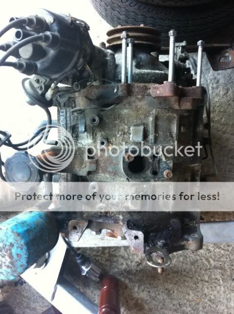

On the centre iron, on the spark plug side at the bottom you'll see a small bolt. This is the main coolant drain for the block. you can see it here:

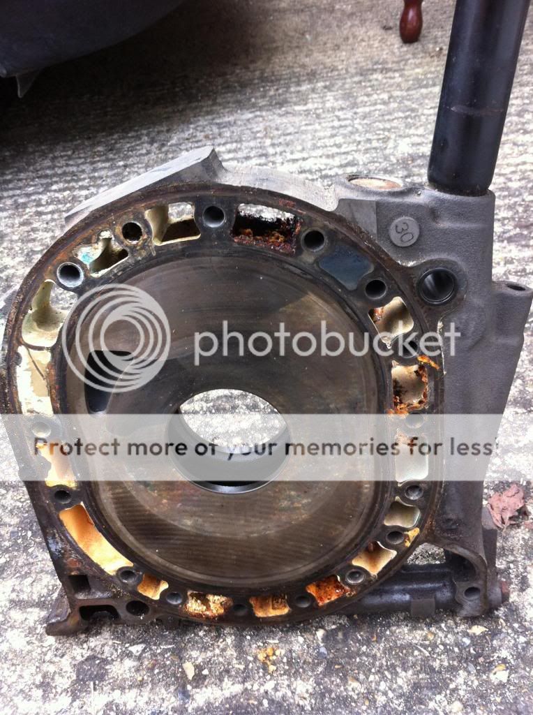

Pull the thermostat, pull the heater hose from the rear iron and pull the water pump housing too if you want (make sure you don't lose the washers which keep the housing flush when you bolt it back on). These washers sit on the 2 outlying studs as shown in the next pic (the one I'm holding and the one on the left).
I would do my best to blast water into these orrifices using a garden hose to blow out as much muck as possible. Be warned though, it's like a jelly and is hard to dislodge.
You'll need a new 82 degree thermostat (make sure it's not one of those higher temp ones claiming to suit RX7) and a water pump housing to block gasket. If you take the water pump off the housing, you'll need that one too. All available from Mazda, just quote them the part numbers. Your water pump blades might be gunked up/rusted too causing poor circulation.
The top hose joint always seems to rust quite badly and the ends decay. Hard to find good ones.
Let us know how you get on, and if you need bits, they're sure to be available on here.

Take off the alternator. Take off the fan. Take off the water pump housing. That's about it. It's held on by 4 nuts. Only remove the nuts, not the bolts.If you're undoing bolts, you're about to remove the water pump from the water pump housing.
Personally, I don't see any real advantage in taking the water pump housing off. The block, particularly the lower half is where the issue is. You need to clear that out.
