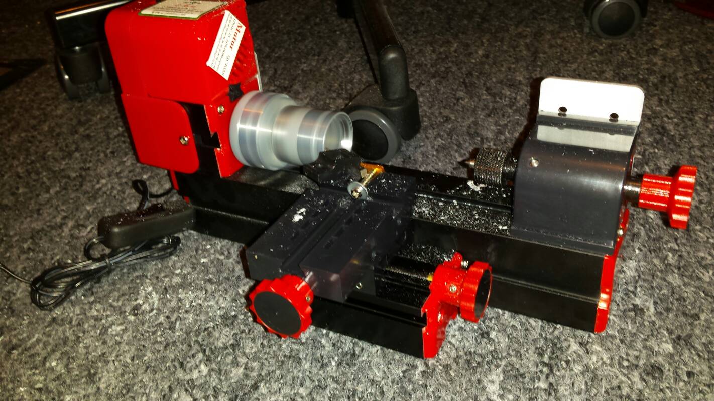

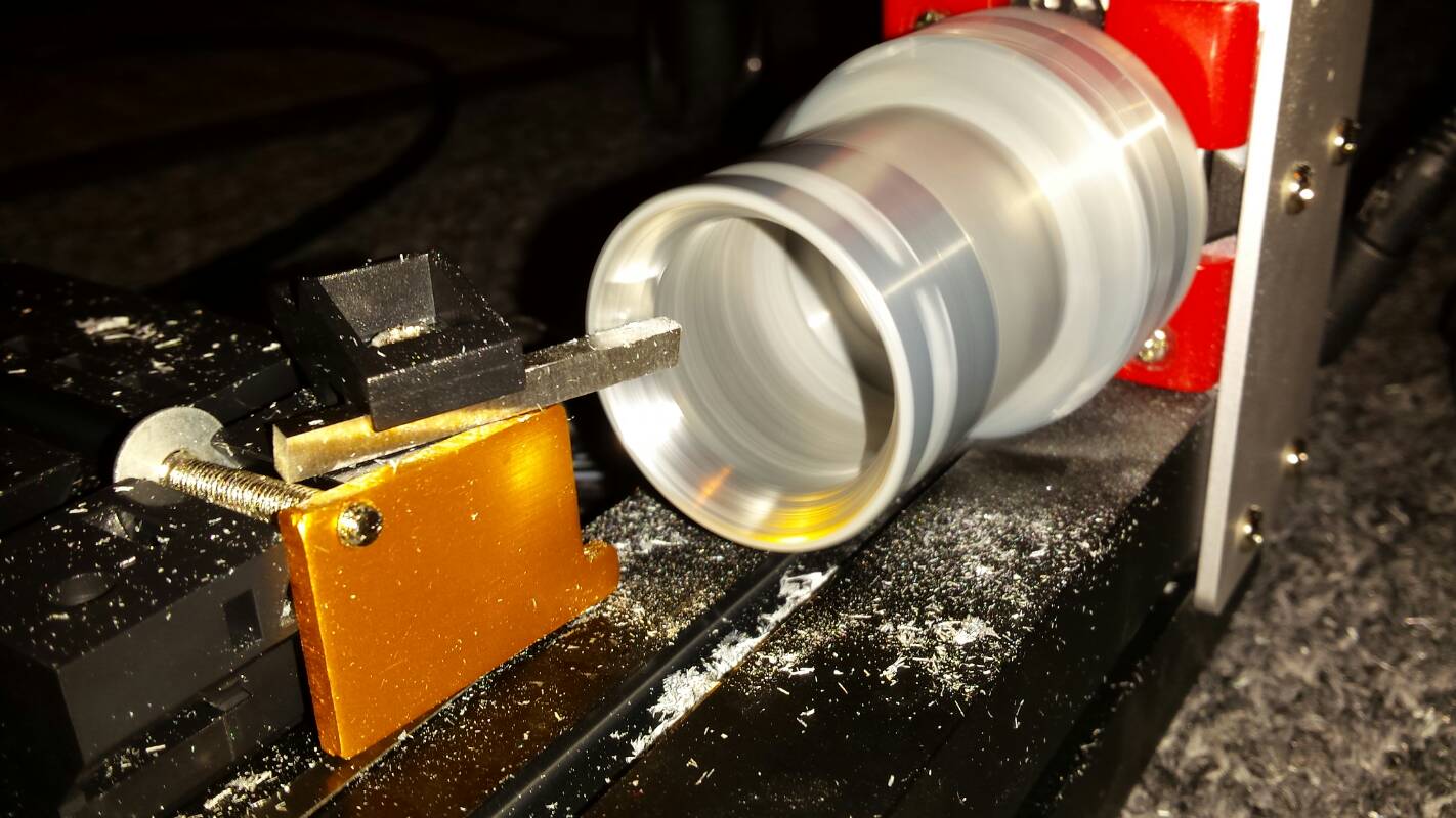

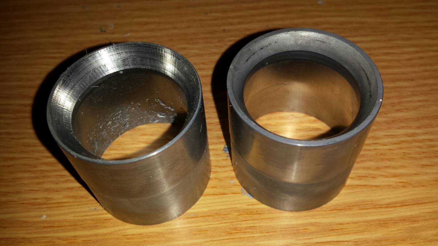

Here's an update on progress with the modified Nikki. So far i have everything modified and ready to reassemble.
The Venturis have been machined to provide an smoother inlet angle and polished to reduce air resistance. To do this i bought a mini-lathe off the bay of E, it was more of a toy than a proper lathe (as you can see in the pictures) but i got the result i wanted in the end...
I would recommend using a more precise lathe than the one i used.

Inlets were roughed out with a cutting tool first , then 400 grit sandpaper, and finally polished with 2000 grit.

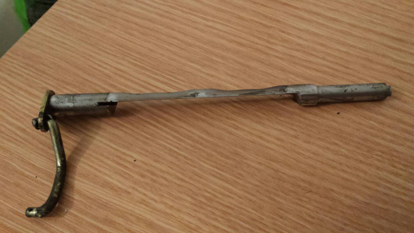

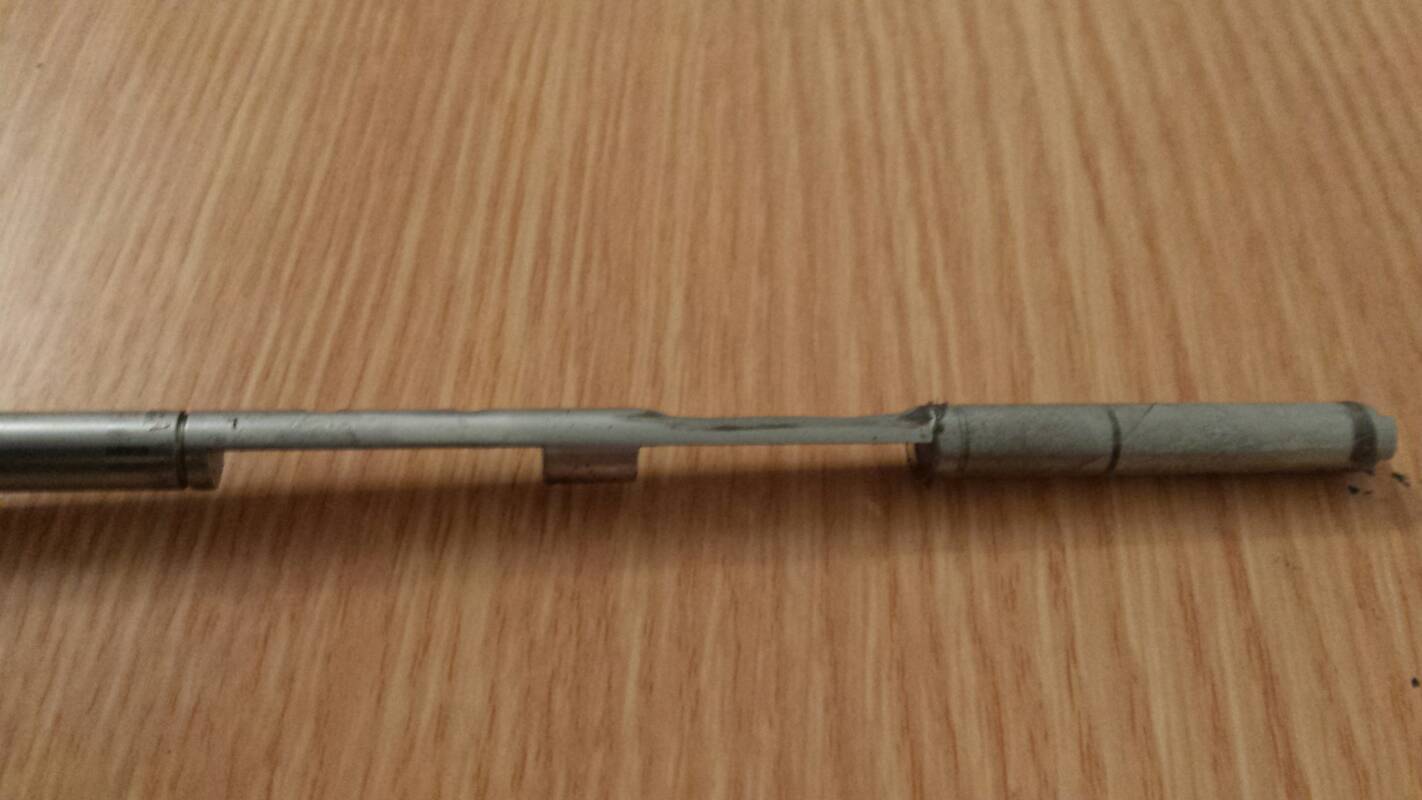

I have removed the choke linkage and butterfly, this is a big restriction to airflow so has to go.
The primary and secondary throttle shaft were cut and flied to reduce the restriction and shorted screws used.
