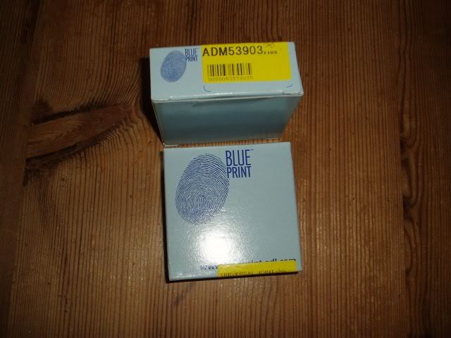

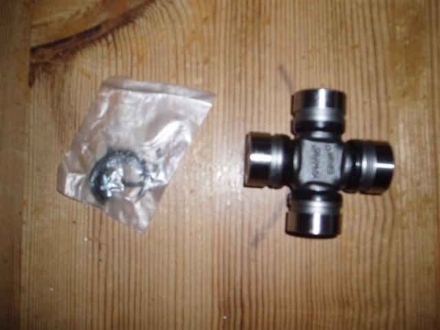

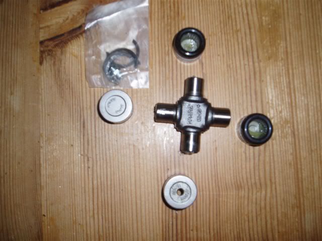

Hi Guys.
These are the UJ's I got from Unipart / Blueprint:
Note the spring clip grooves are INSIDE the mounting "ears" on the propshaft.
Also note that you can just about see a new grease nipple in the packet with the spring clips... (OEM parts do not have this feature...)
It turned out to be a good thing that I had got a secondhand propshaft from Banbury - on mine, when the bearings collapsed (they were completely solid in one plane, so the overall effect was to turn a Universal Joint into a hinge...), the bearing endcaps has started going around inside the mounting ears, so if we had put some new ones in they would probably ben a bit loose, so we used the Banbury propshaft.
The UJ's on the Banbury propshaft felt OK, but since it was on the bench and we were set up to take them out... we took them out and had a look. They fell apart. No grease at all, completely dry and a bit rusty - the only sign of lubricant was some "varnish" on the shafts. As a point of interest this was true at both ends, not just the front. So we put the new UJ's in on the Banbury propshaft and put it on. And it works. Simples!
As regards technique, I had never done this before so my friend and ace mechanic Rob showed me how. We took off the circlips (they hide on the inside of the "ears"), put a large socket (big enough to miss the UJ and support the "ears") on the one side and a small socket (small enough to press out the UJ) on the other, then tightened them up in a vice (I just held the long end of the propshaft...). This pushed the one end cap out into the big socket, so we stopped and reversed the procedure to get the opposite cap out, then the other two caps.... and by this time the central cross had room to come out. Fitting was the reverse of the above. Then do the other end...
Net result? Much quieter and no vibration. Another win.
In retrospect, I think these have been "going" for a while, and I have not recognised the gradually increasing noise and vibration for what it was until the UJ actually collapsed.
John
