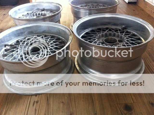

Here's an example of SSR wheels with their size and offset details labelled on them. I got these in the post yesterday.
SSR EX-C mesh wheels (Racing Hart) in 15x7 and 15x8 4x110 PCD with 0 offset front and rear.

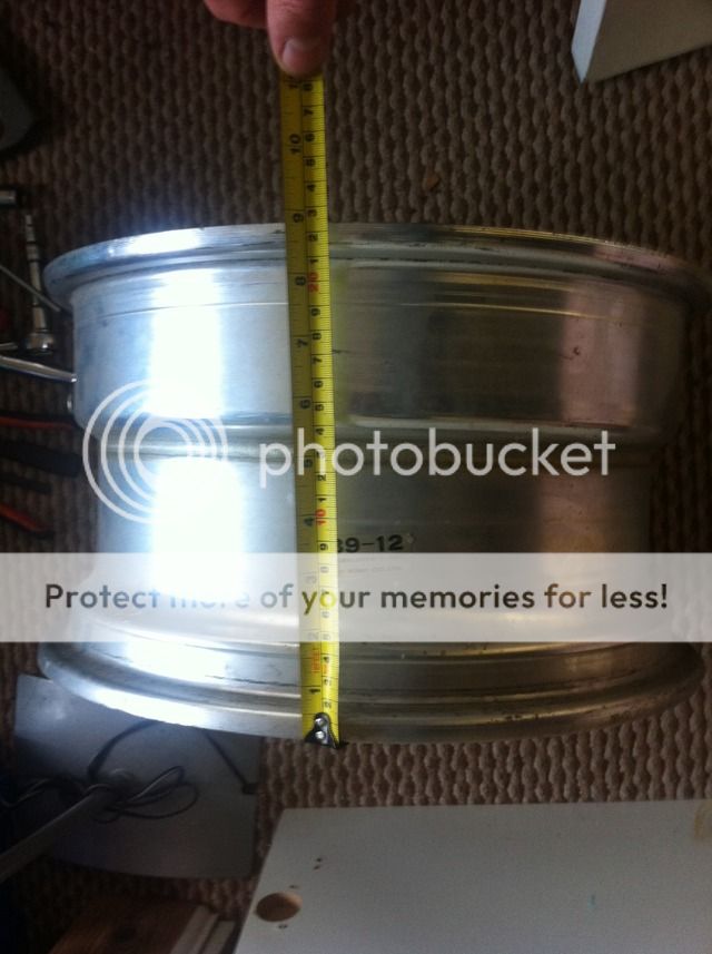

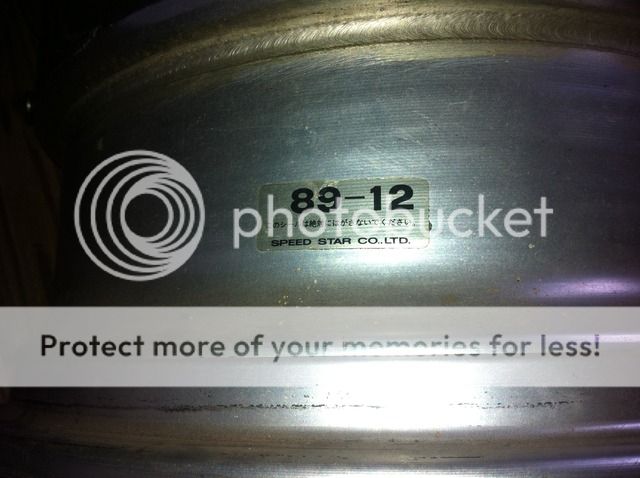

Date sticker on the barrel

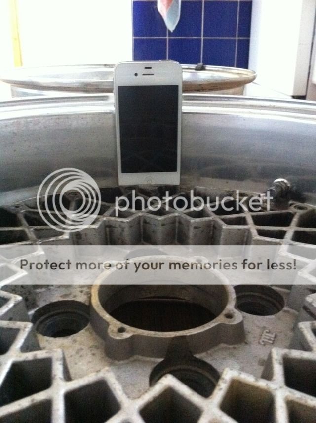

Dish (approximately 4 inches) as shown with an iPhone 4

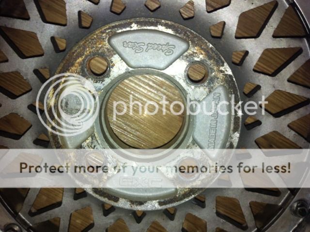

Manufacturer (Speed Star), build date of the centre (89-2), Model (EX-C) and where made obviously

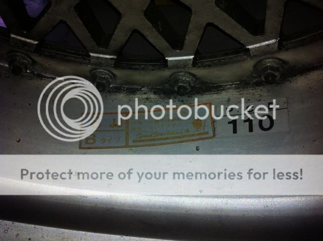

Here's the offset and PCD on the sticker on the inner barrel (note the B)
They are 8J but don't forget the extra inch each side in total as the 8J only refers to where the tyre bead mounts

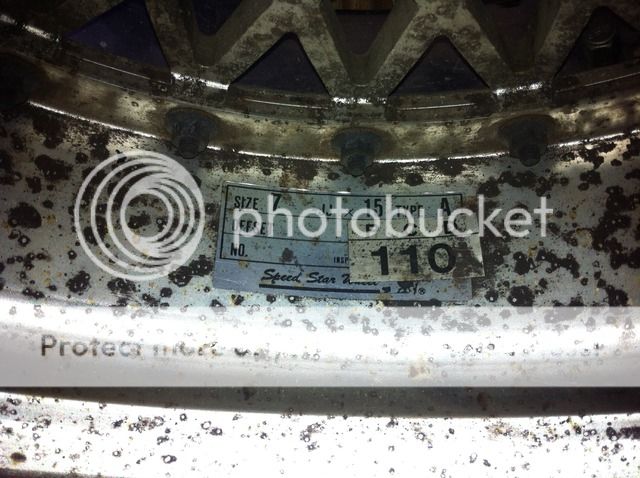

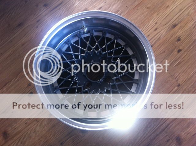

And the fronts (note the A)
It seems quite normal that 110 PCD was not a standard option, hence the extra 110 sticker, which I have seen a few times on wheels on the net.
These wheels are supposed to have a 3 piece centre, with a plate, a collar and a cap. I didn't get these with the wheels so am now on the lookout for some. Most likely place will be the US.
Being 0 offset they should stick out quite a bit, as standard offset is +25 so I'm hoping they fit under the guards. Only one way to find out.

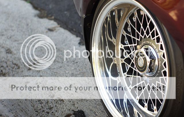

They appear straight and true and will need a good clean, but I'm hoping they will look something like this:
