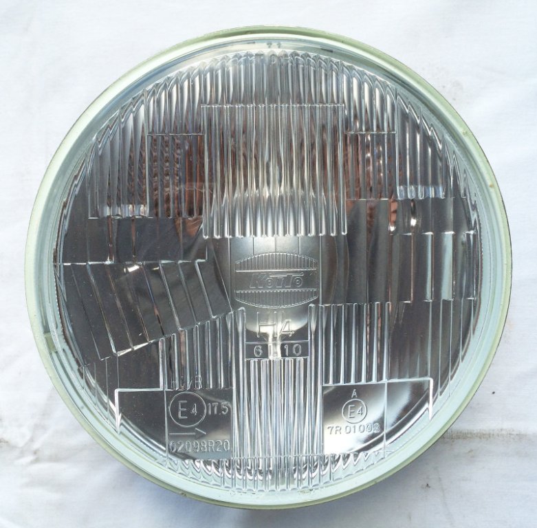

FWIW, I'm yet to 100% confirm, but I think the RX7 headlamps with replaceable H4 bulbs are virtually identical to MX-5 Mk1 items, Mazda part no. NA1051031A
mx5 headlamp new.jpg (114.4 KiB) Viewed 10748 times
These are widely available brand new. Also made by Koito. The main difference appears to be that these are E-marked (being newer items)
There are many other applications for which 7" H4 semisealed globes are supplied by Koito as OEM eg Toyota landcruiser. I've found these brand new for a cheap price pre-fitted with Philips H4 bulbs from Toyota dealerships. However, the globe is completely flat and I believe ours are slightly curved. I don't have access to my car though so I can't check.

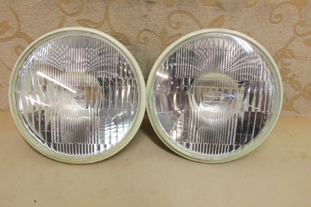

I have found a reference picture to NOS semi-sealed headlamps with the original Mazda part no. for the RX-7 - it is the same as early model stuff. This image was listed for a Mazda Familia though so even though it is the same part number, Koito could have changed the design by the time the RX7 came along.
NOS rx7 headlamps part no. 813451041.jpg (171.46 KiB) Viewed 10748 times
