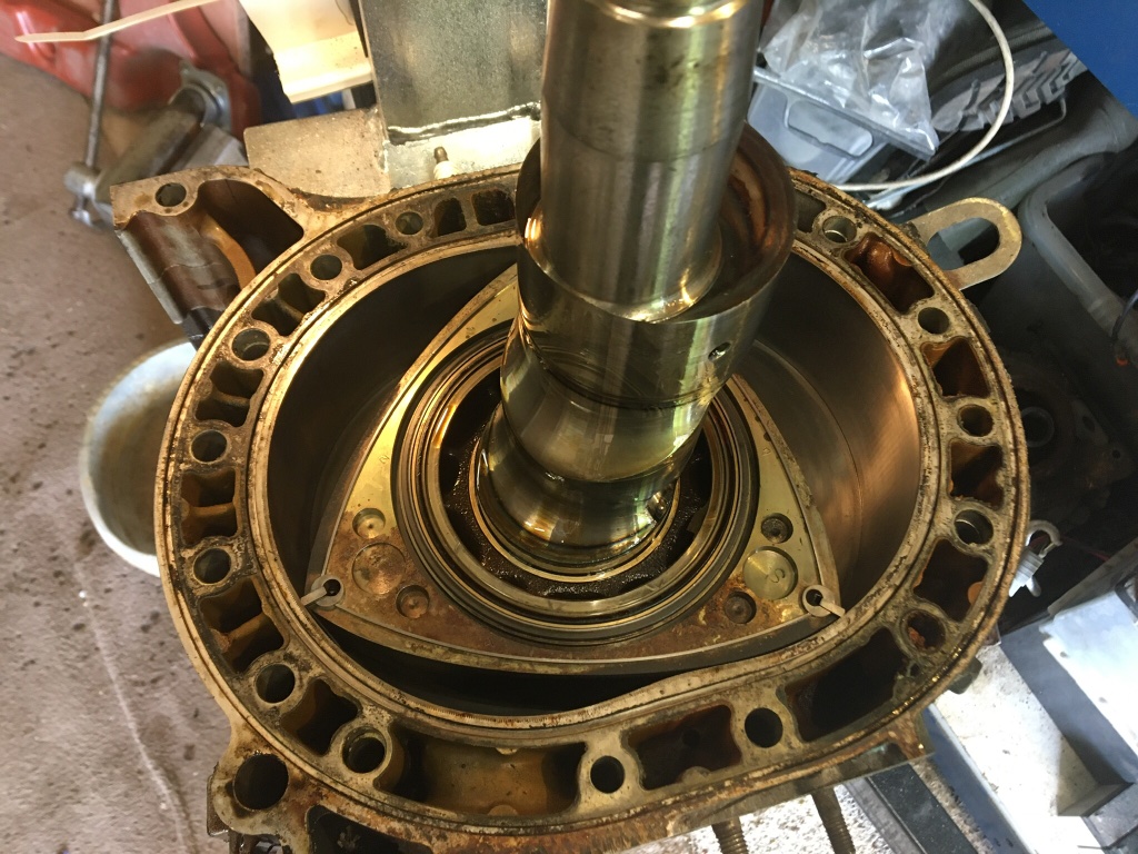

Finally got round to making a start on the engine.
Porters2
Posts: 202
Has thanked: 85 times
Been thanked: 124 times
Re: Very overdue project !!!
Post by Porters2 »
Well lots of fun and memories from the 80s while stripping the engine, last time I started it 12yrs ago it filled the street with smoke so I knew it was in need of a set of o-rings at the very least, as it turns out that was all it needed, I stripped and measured/ cleaned everything and reassembled with new o-rings (acquired from eBay for £100 , listed as for 86-2000 engine but took a chance as I seem to remember them being the same, only one that didn’t fit was the OMP one, could be due to my turbo OMP having 4 ports).
Anyway it’s now running on the test rig in the workshop, as you will see if I can attach a short video, and pleased to say that it doesn’t smoke 😁.
