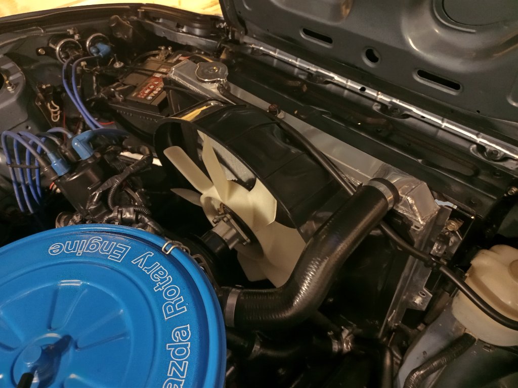

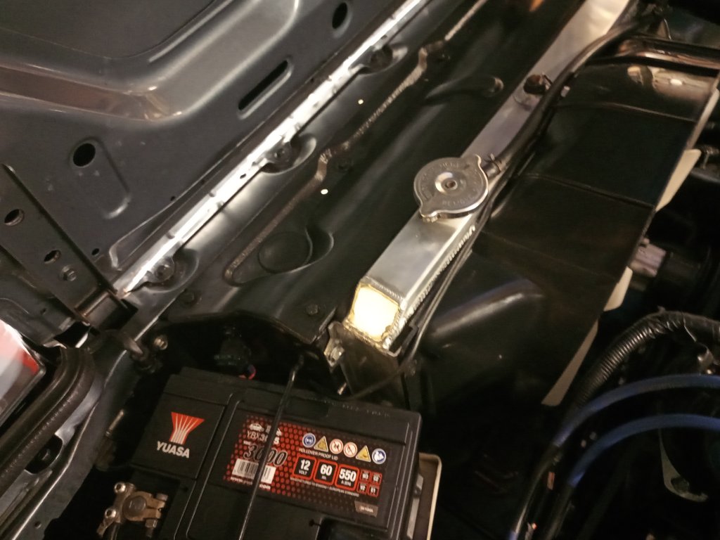

But could do with some help as the cooling system is still not behaving. It had an aftermarket no name radiator on it when I got it. The pipework on the drivers side from the heater looks non standard to me. So bought another newer one from ebay (as can't seem to get a proper one for mine), moved to a Mishimoto fan controller and largest fan from them I could get fitted using metal brackets on the nose side so it looks better. The radiator when it gets up to temp starts to steam from the lower heater join pipe fitting (I've tried a number of different jubilee clips and placements) and I swear it also steams from the radiator cap - this is a new one that came with the radiator, have tried the one from the other radiator.

Does anyone have the original heater pipework drivers side for sale (I'm sure it hard a hard pipe in part of it and two rubber hoses on either end). Would you up the radiator cap to a 1.3 rather than the 1.1 bar, or a good explanation why it might be steaming from there (over-pressure) or just not sealing ?

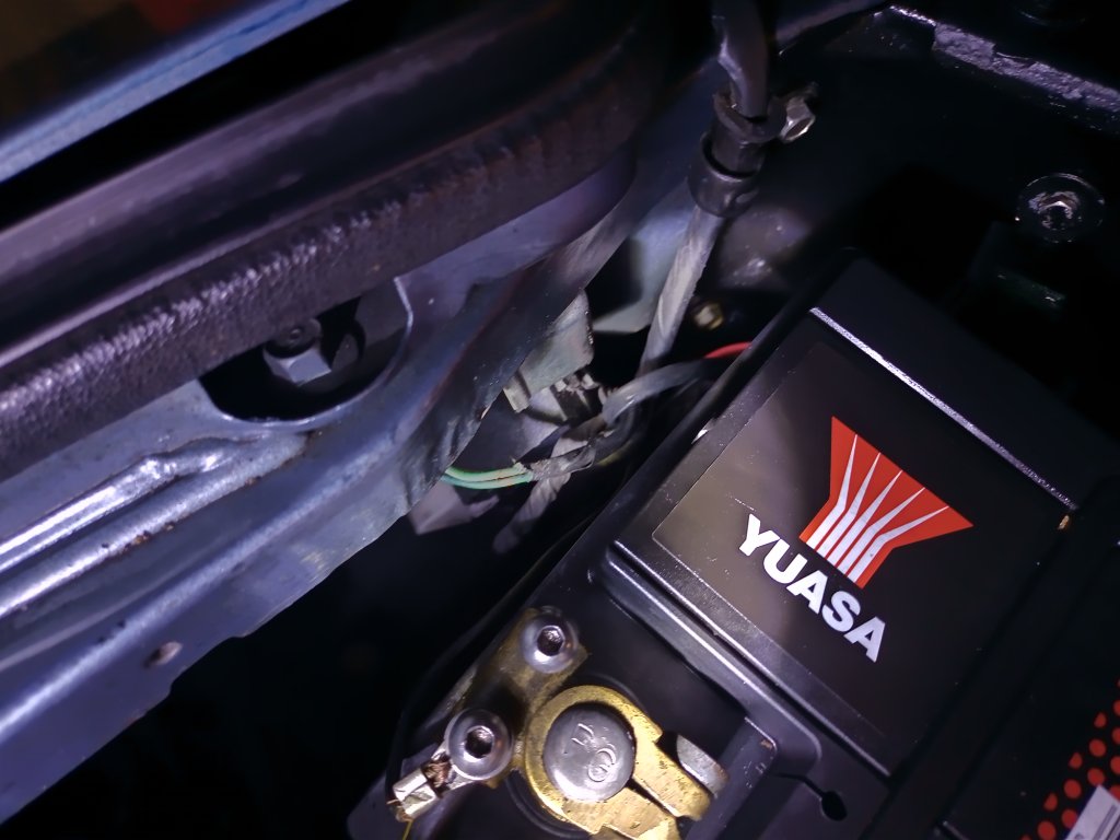

Here are a few pictures showing the location of the Low Level Cable that might help.

I believe the coolant level sensor uses a single brown cable. Coming from the area Pete showed in his last post :thumbup:
