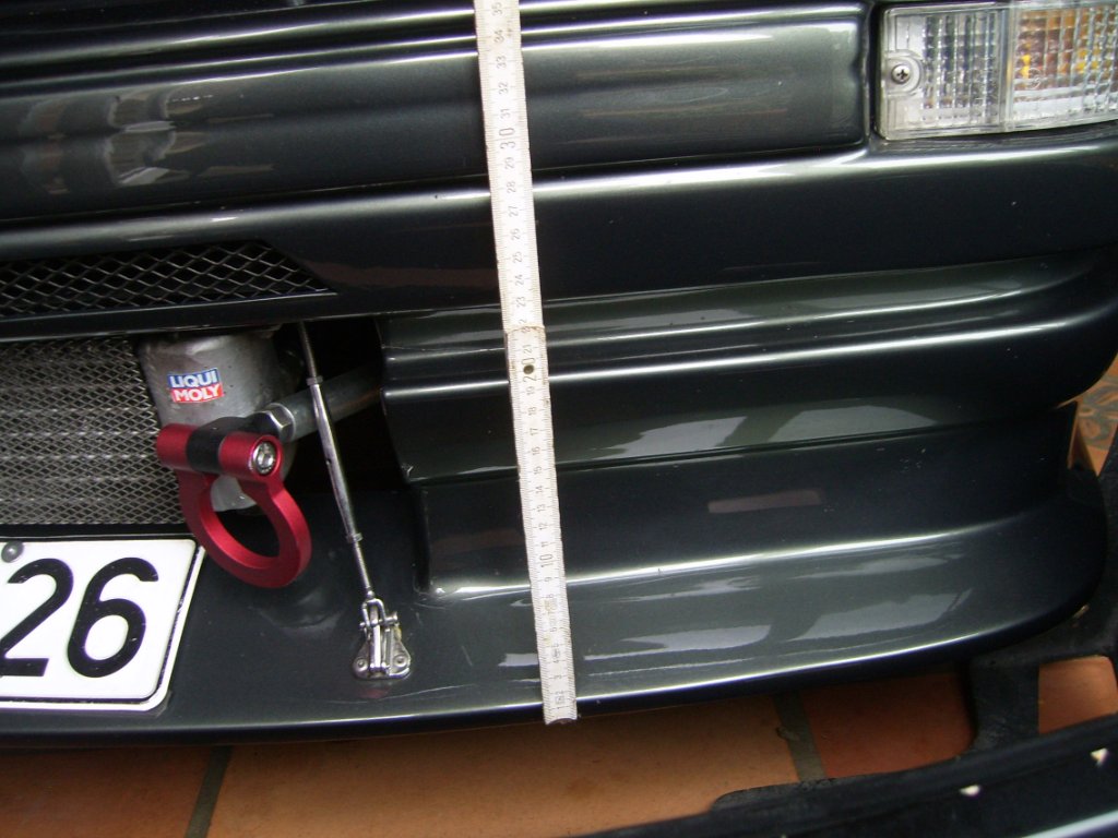

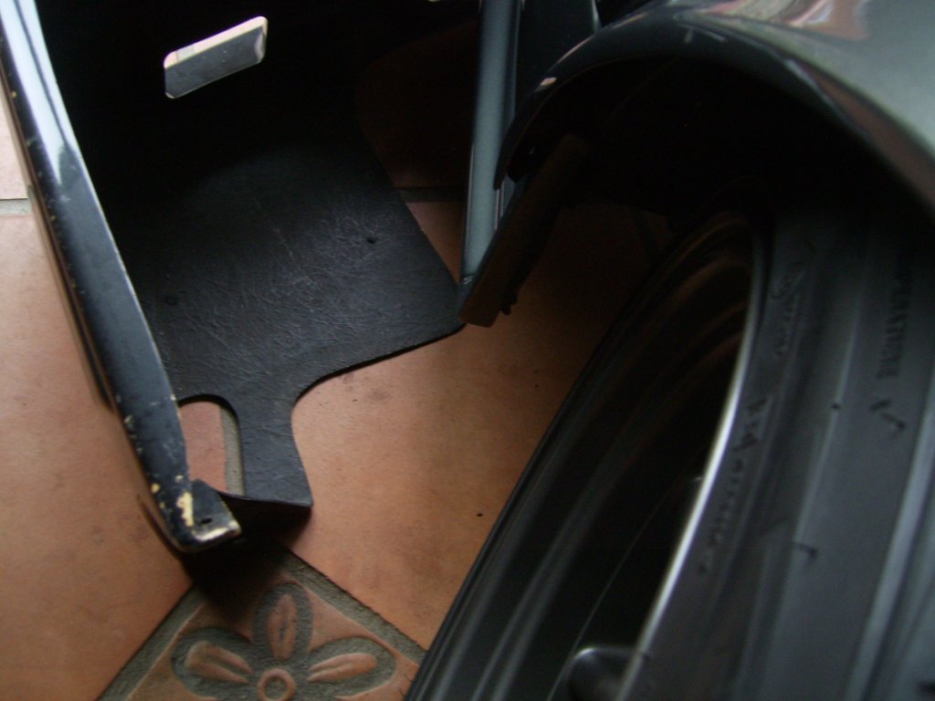

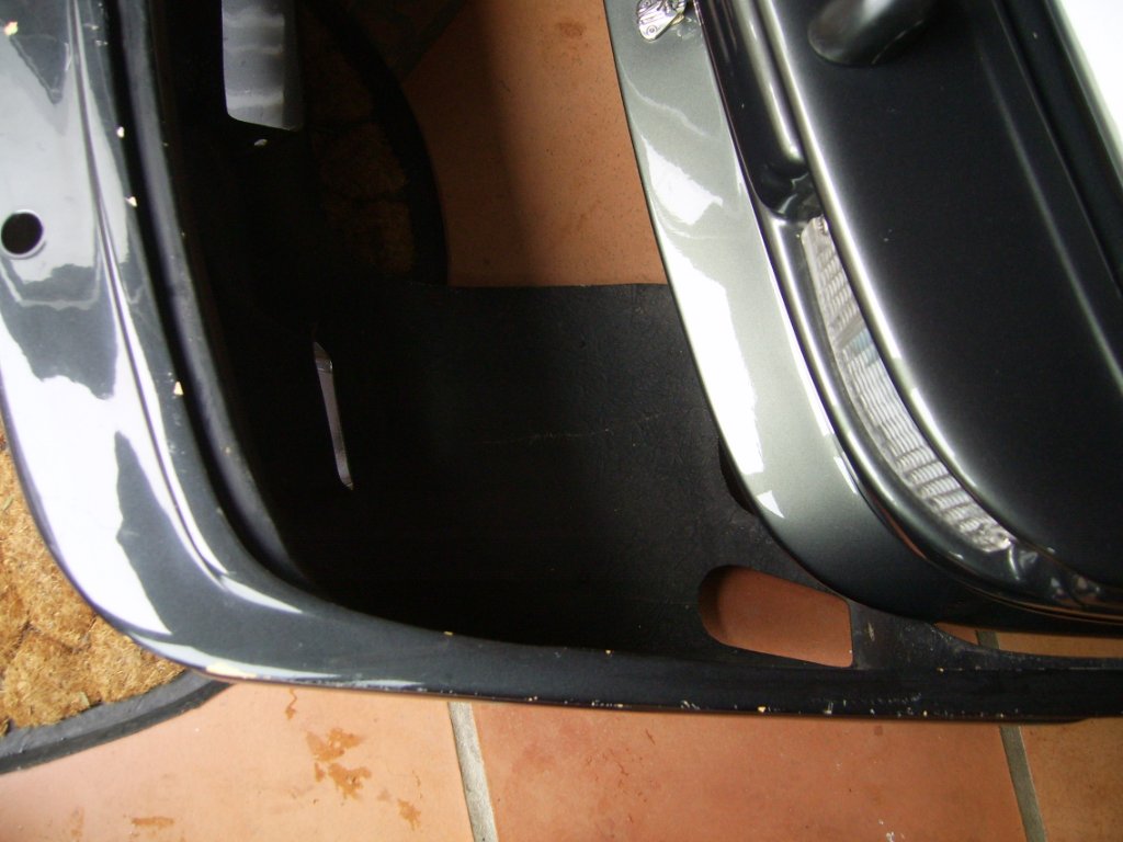

Some Pics TWR vs KÜWE front. I can see two fixing holes more on the TWR.(last picture) Hope you can get an idea watching these pics Dave.And Yes you have to remove the whole assembly.
