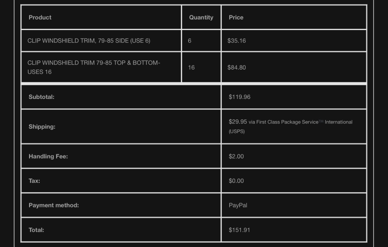

I got my clips from Mazdatrix. Not the cheapest by far.. but was painless to order and arrived pretty quickly

Phils Rotary in Aussie sells clips. Make sure you don't buy from one of the scam pages that replicate them though. IIRC, Phils is all on ebay
https://www.ebay.com.au/sch/i.html?_dkr ... x7%20clips
If placing an order. It might be worth grabbing a bunch of goodies from them aye. They have a lot of clips/trim/rubbers etc
