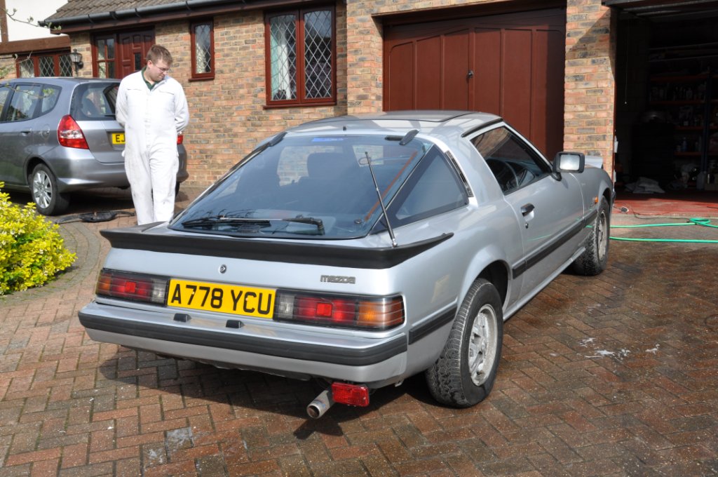

The project started on 2nd April 2011 when 3 of us; I, Will66 and Seanp spent 4-5 hours cleaning her inside and out, plus a quick cleanup in the engine bay. We took out the back seats to give them a thorough clean and inspect around the inside of the wheel arches. Thankfully, there was only a small trace of rust on the nearside arch, the offside looked like it just left the factory!

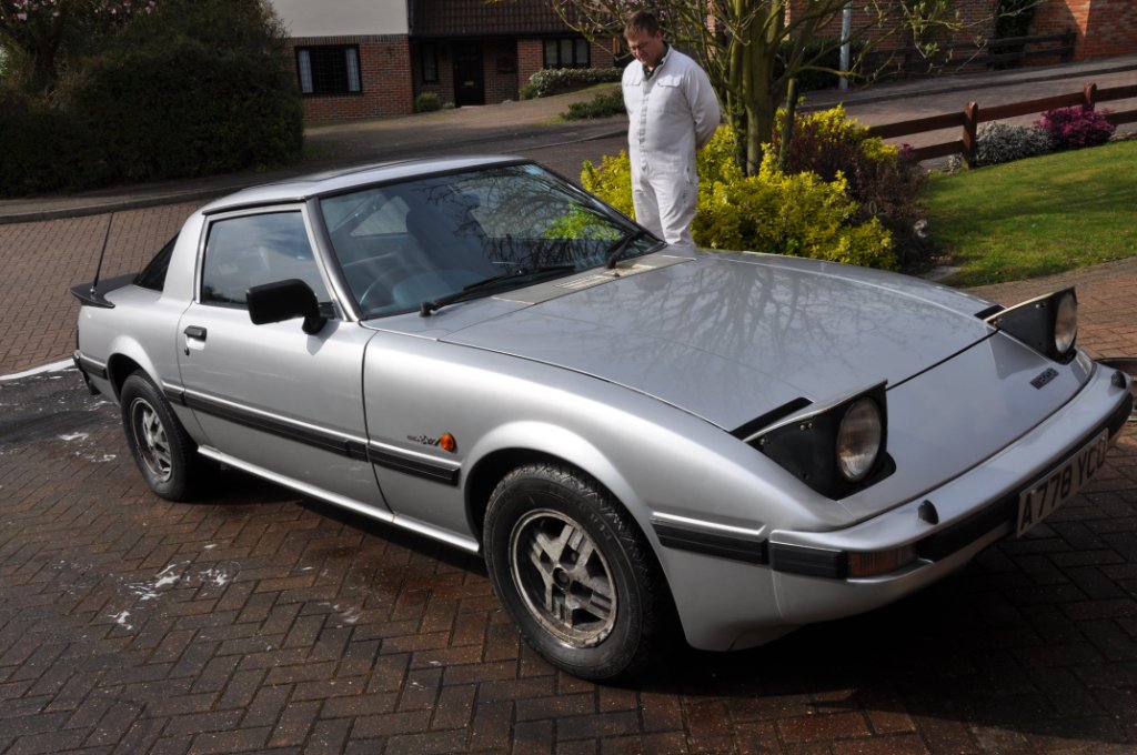

A few pictures after the first wash, no claying or waxing at this point......that's Will66 in his Navy issue overalls :D

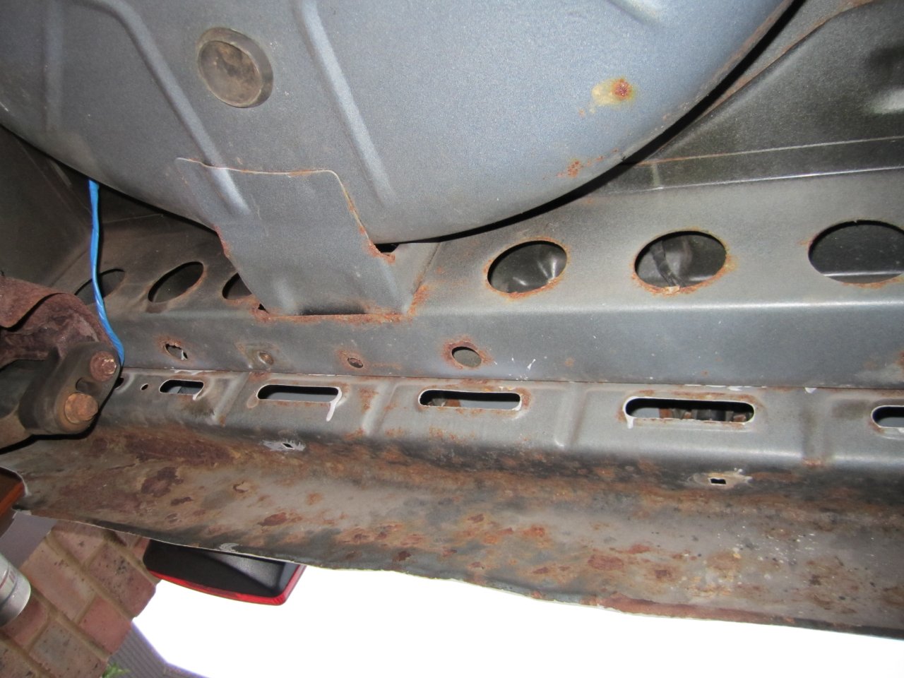

Control from inside the car where the REAR seat belt are fitted. if there is rust.

Thx Thomas - yes there is some rust inside and it's on the list for treatment. It doesn't look too bad, so hopefully treatment, rather than welding will be all that's needed.

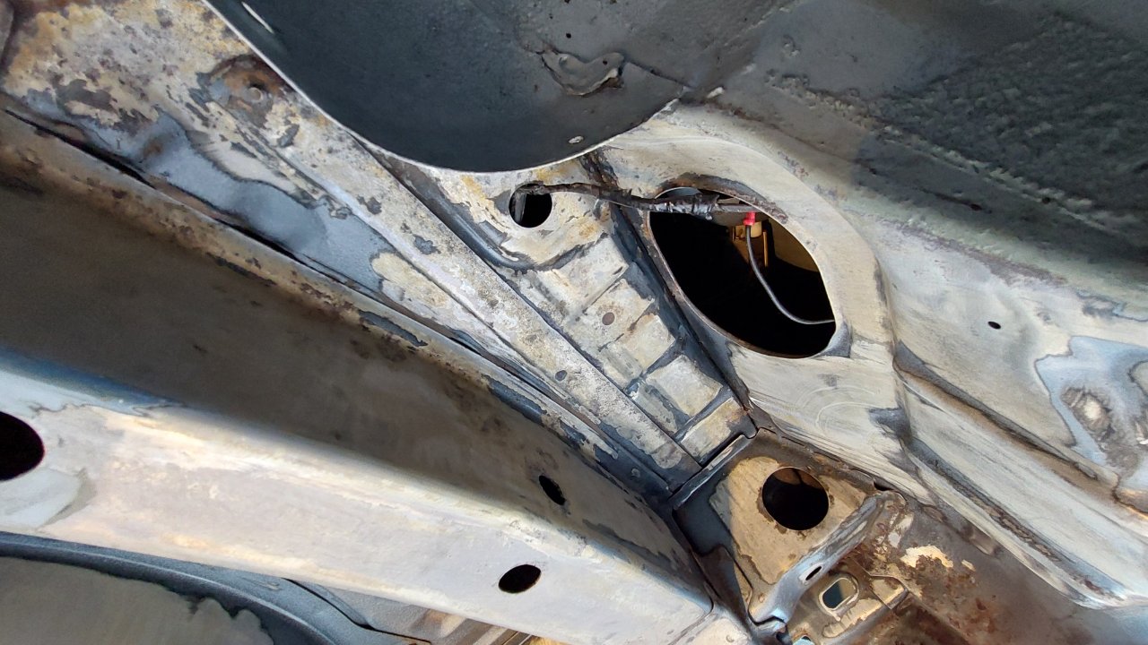

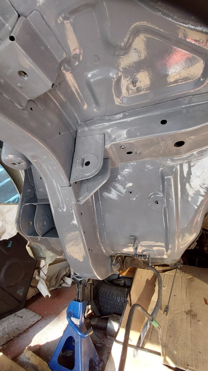

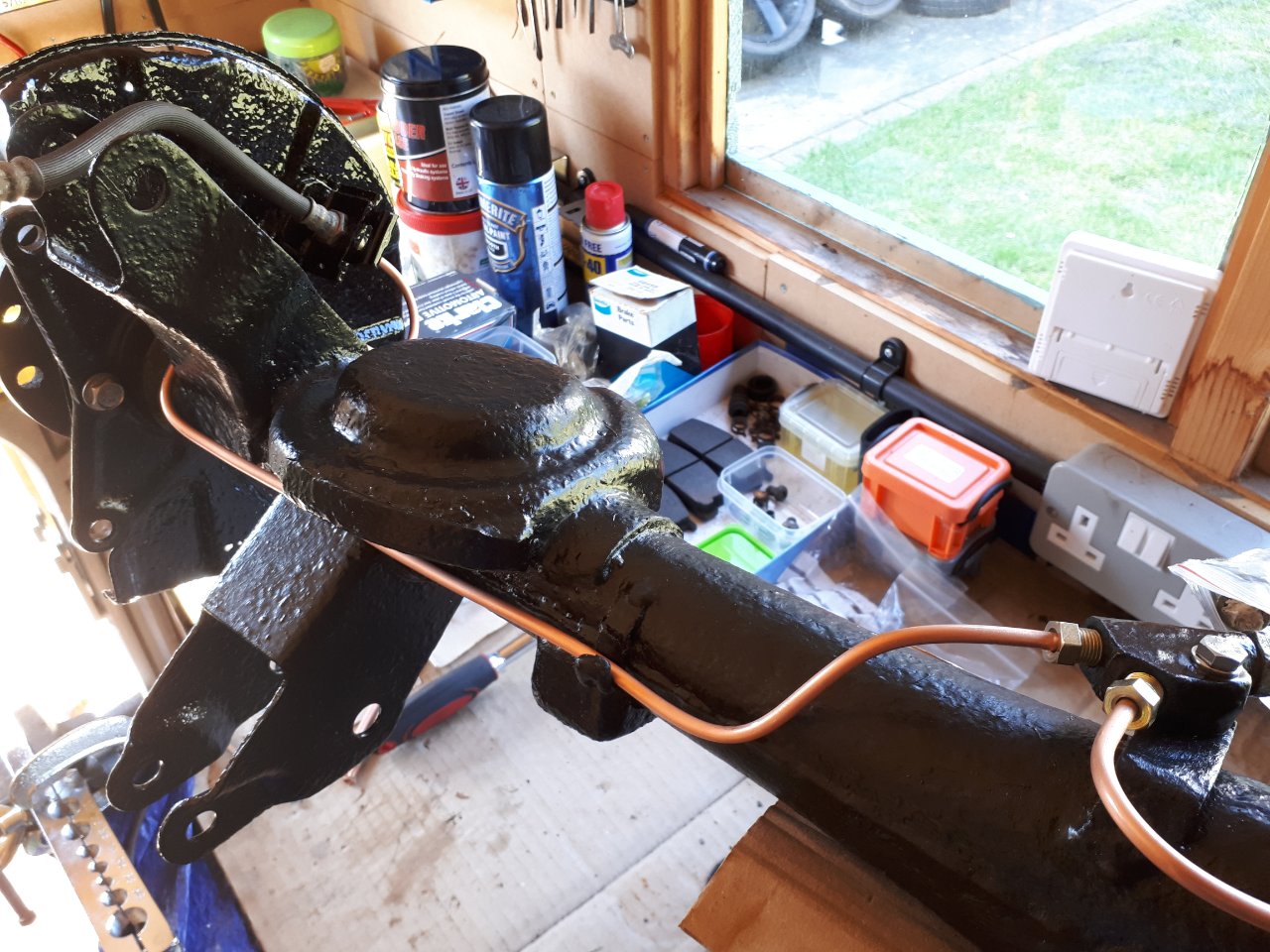

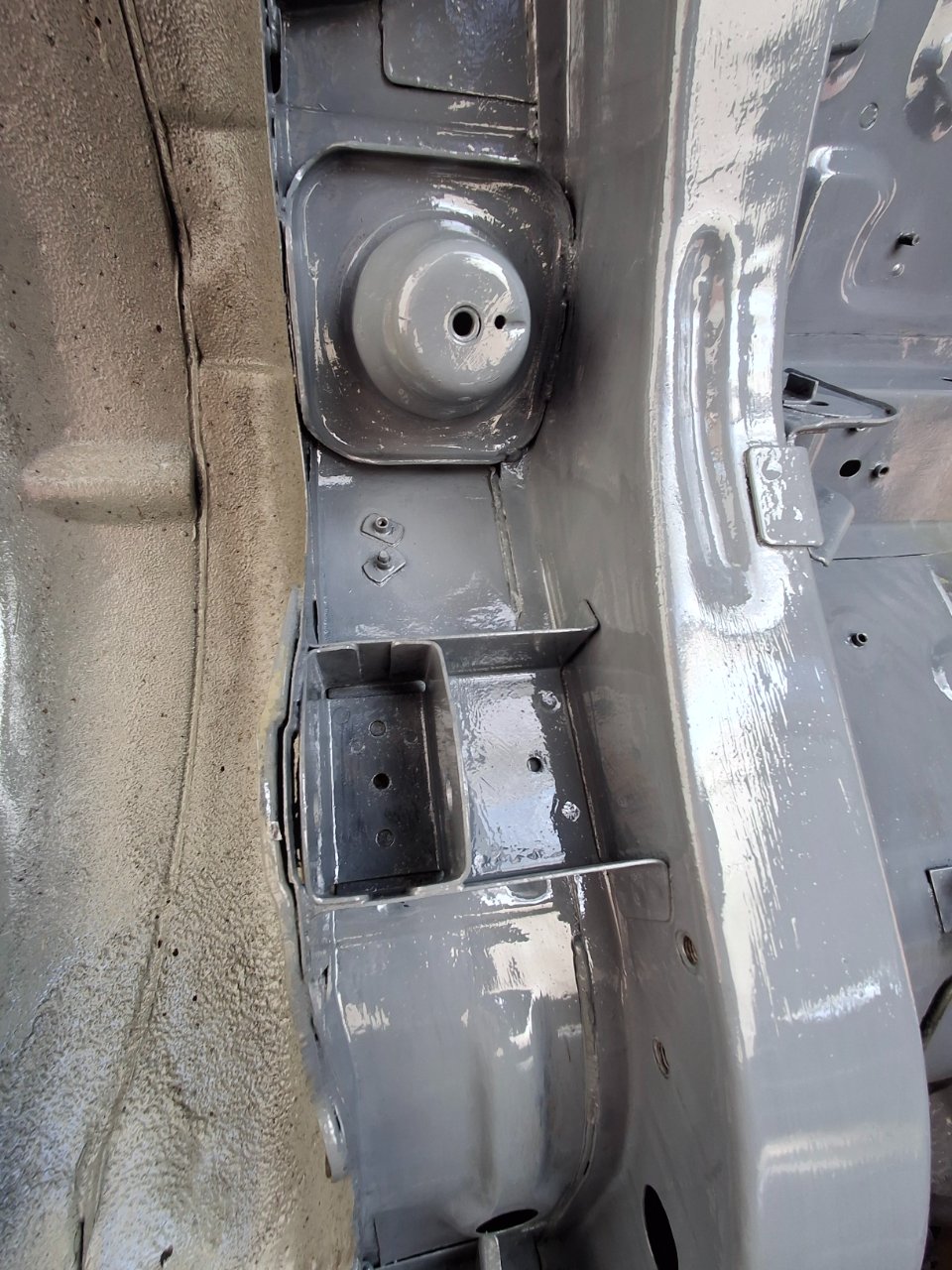

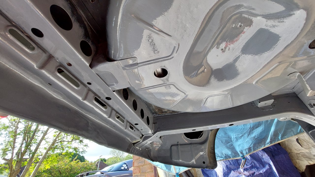

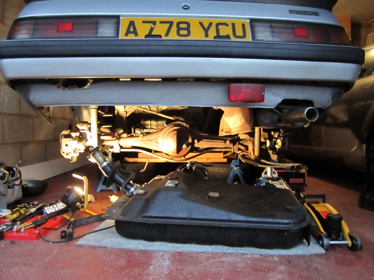

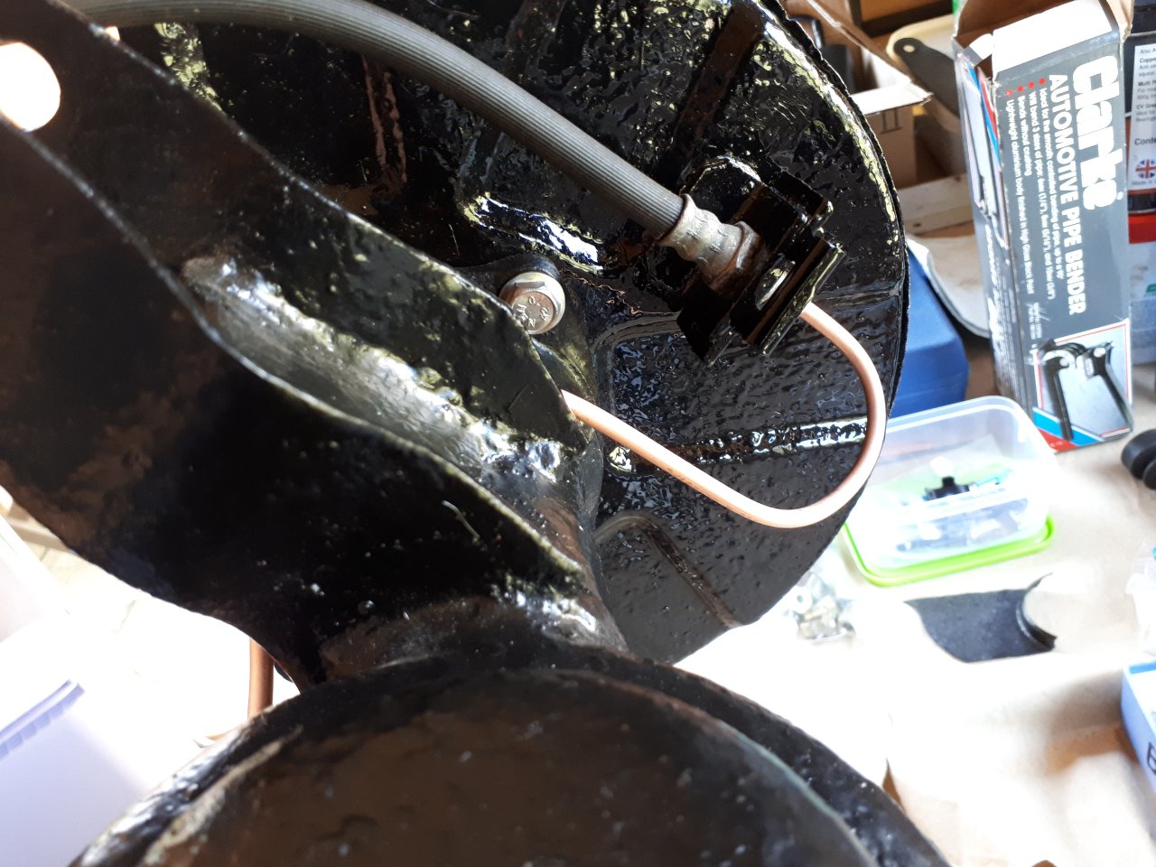

Sadly, life (and 2 other rotaries) has severely impaired my progress on getting KIMI back on the road. However, she is stored in my garage and I have been making very slow progress with getting the back end in good shape.
Though tit was time to bring this topic up to date;
Rear end stripped and full POR15 treatment to 80% of the area.
Fuel tank out and checked. Outside rust stripped and repainted. Faulty ender fixed.
Axle rust treated and POR15 coated.
Calipers refurbished.
New hard brake lines.
Racing Beat springs ready to fit.
New dampers, ready to fit.
All suspension arms stripped and Energy Suspension bushes installed.
New fuel lines.
Stainless stell exhust ready to fit.
It's only taken 13 years since I took her off the road!!

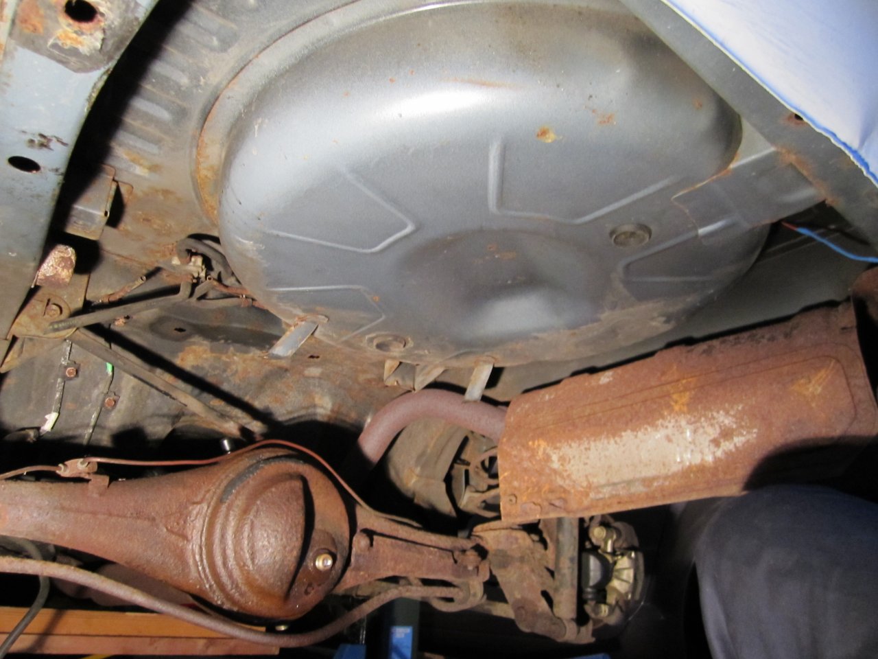

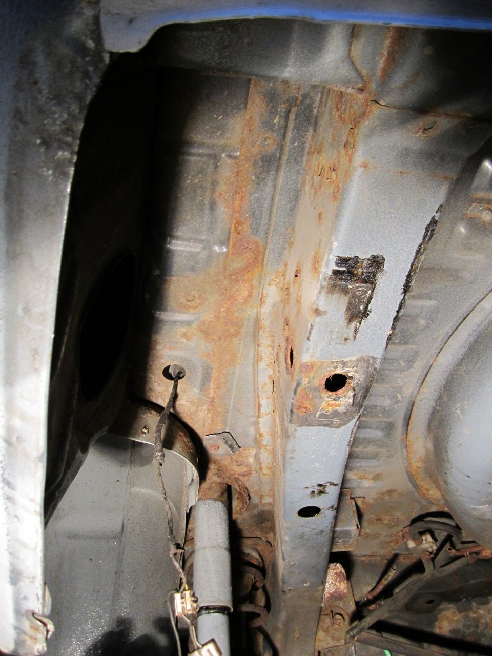

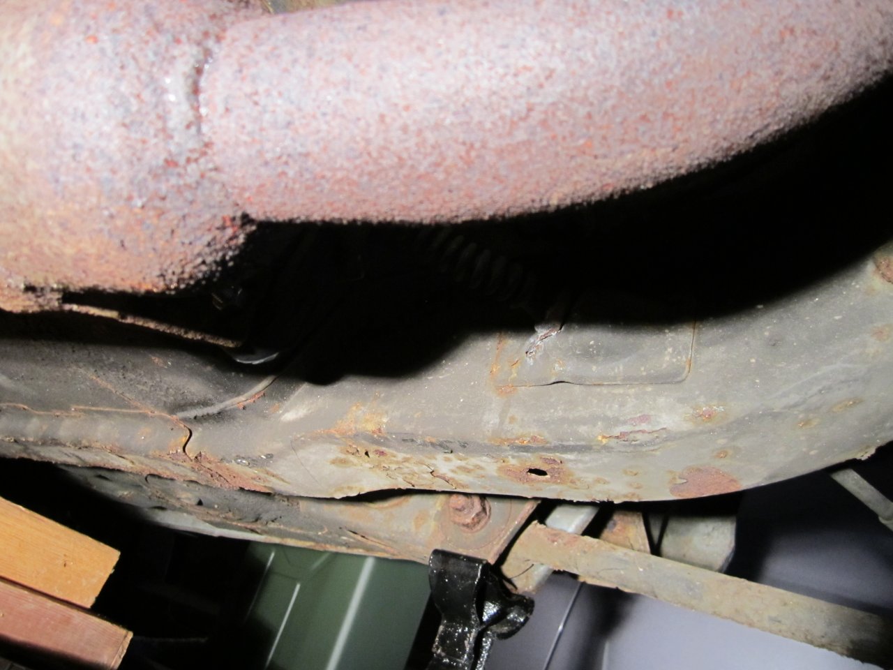

This was the start, in 2012:
KIMI 022.JPG (235.79 KiB) Viewed 4408 times
KIMI 015.JPG (188.76 KiB) Viewed 4408 times
KIMI 016.JPG (226.6 KiB) Viewed 4408 times
KIMI 020.JPG (166.97 KiB) Viewed 4408 times
KIMI 006.JPG (183.61 KiB) Viewed 4408 times
KIMI 007.JPG (242.55 KiB) Viewed 4408 times

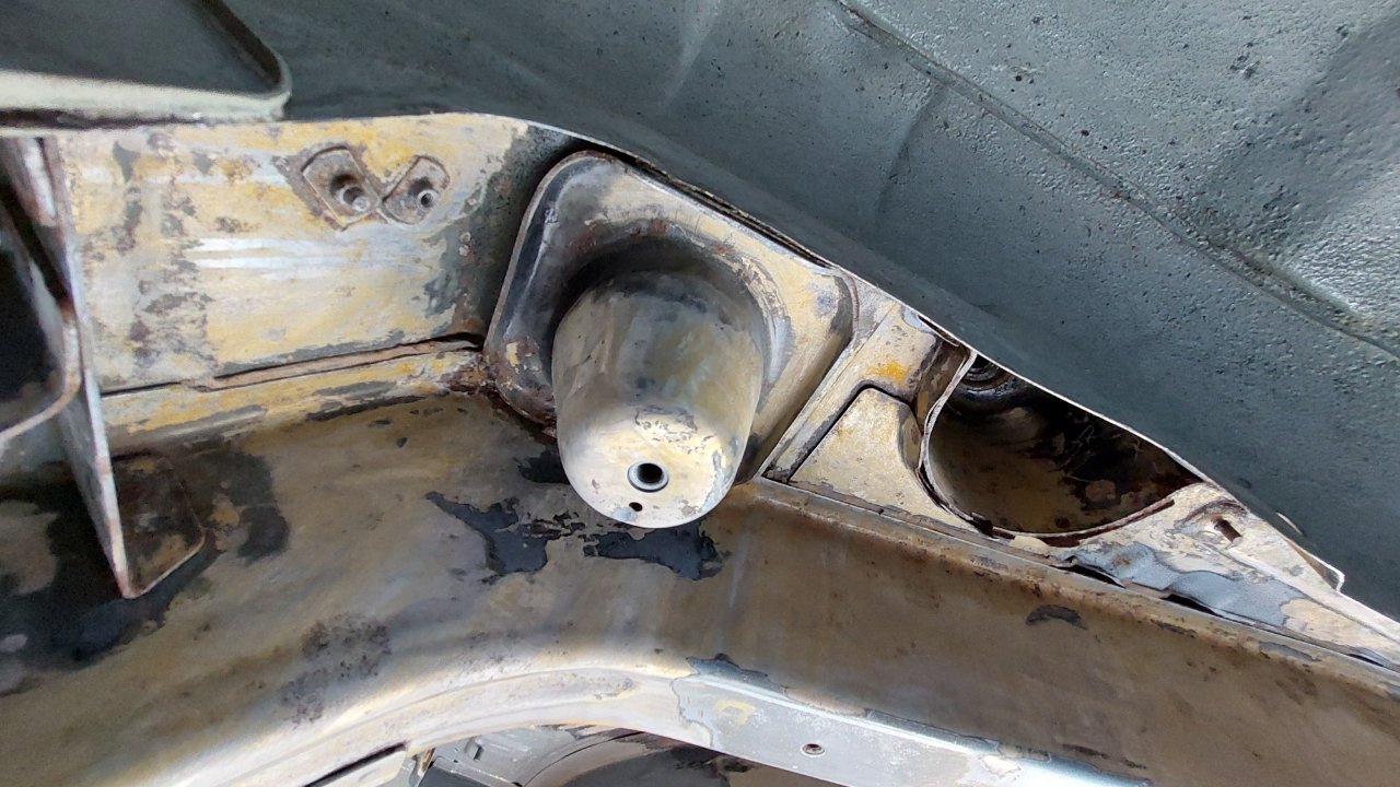

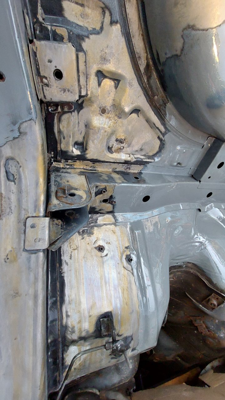

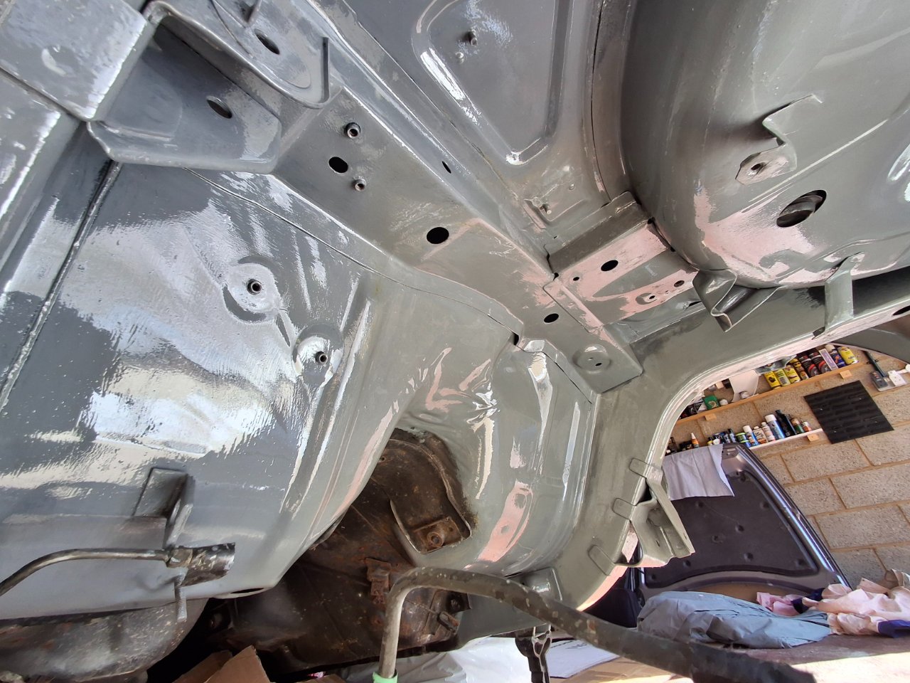

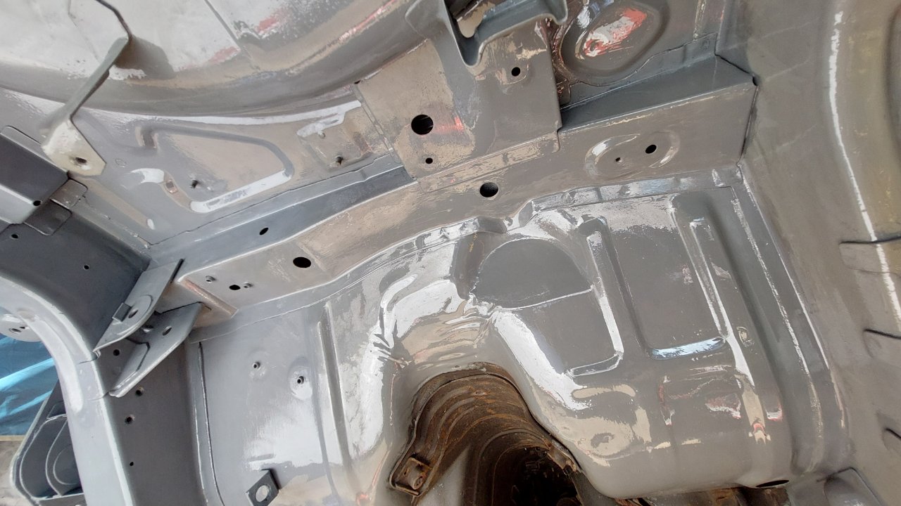

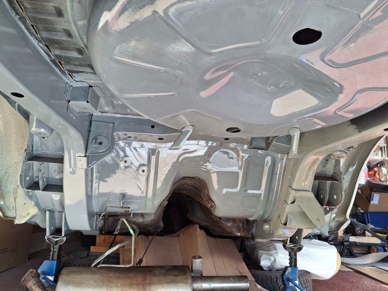

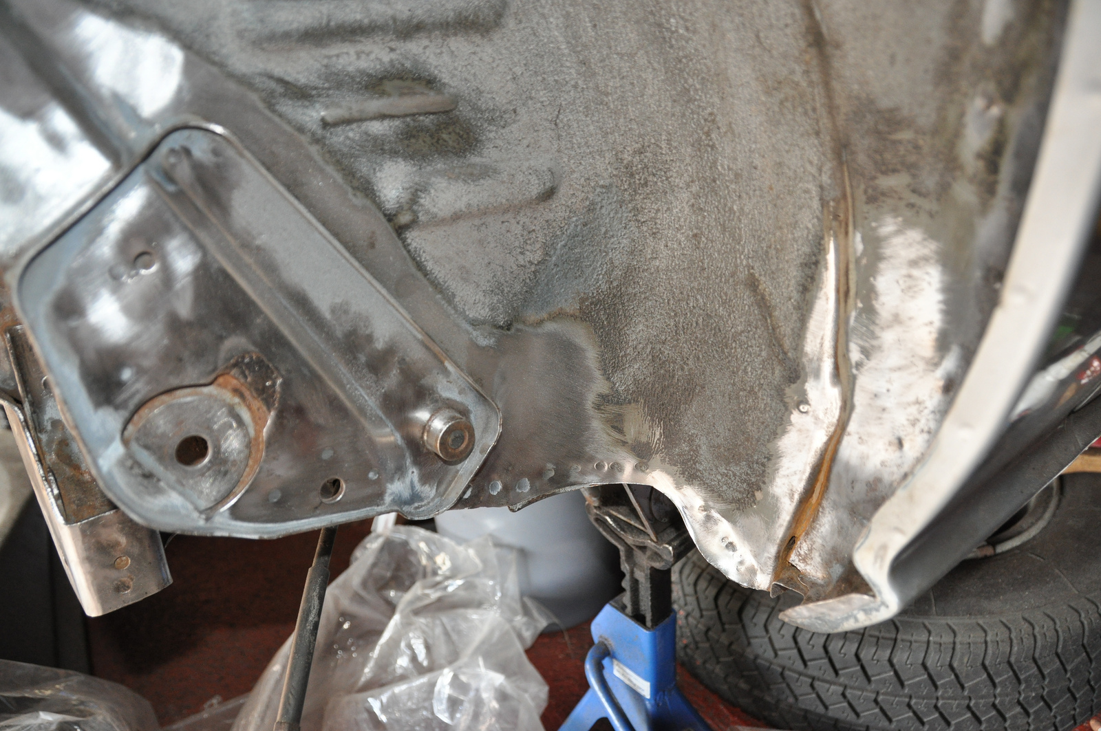

Bodywork de-rusted and POR15 pre-treatment:
Posts: 1346
Has thanked: 443 times
Been thanked: 324 times
Re: KIMI - Series 2/3 Hybrid

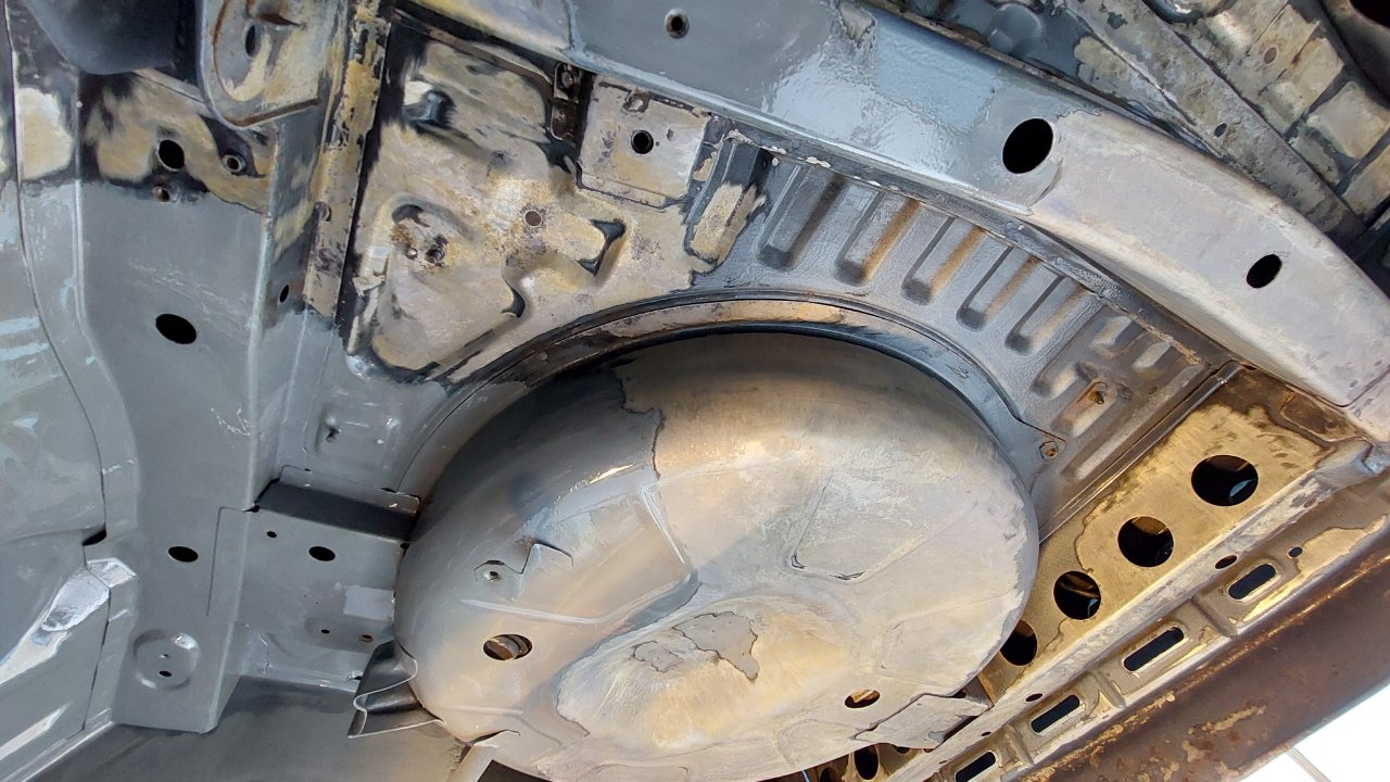

POR15 paint
