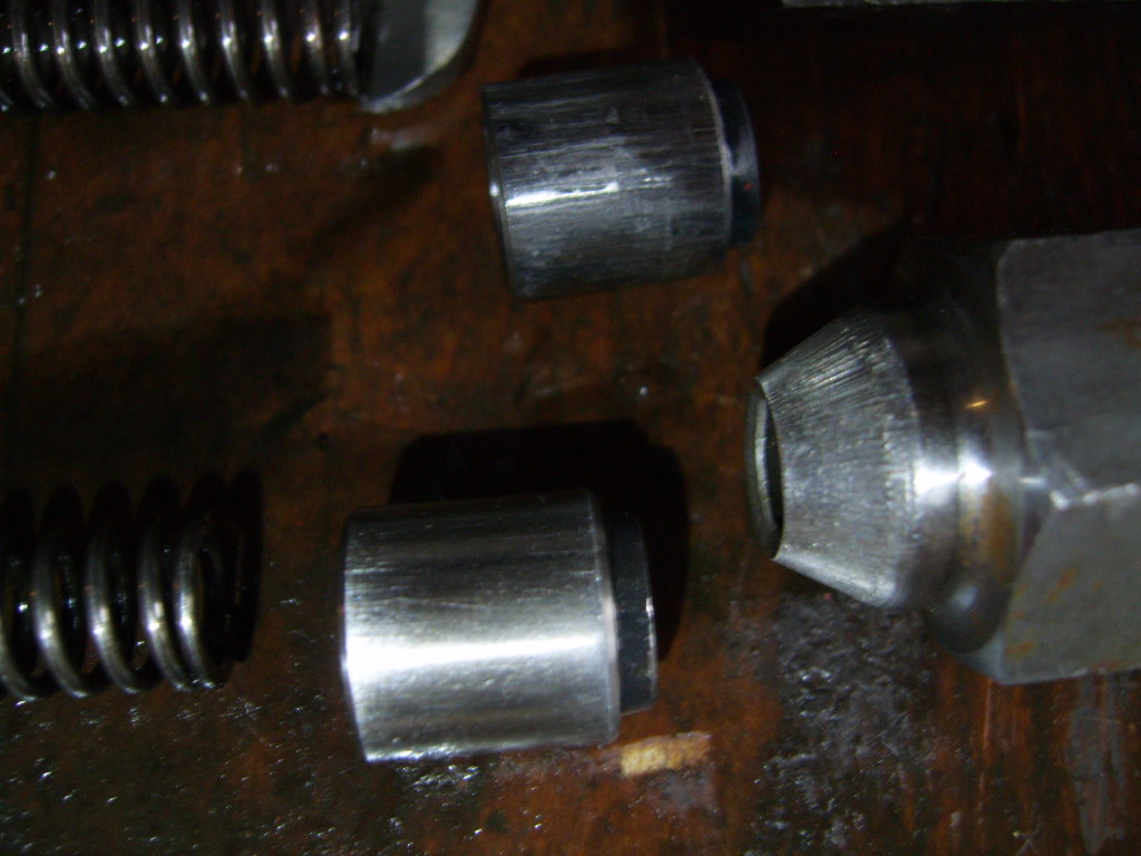

Thank you for the information but how long is the spring (picture) if it is new? It is not the same as the spring from the front regulator. The front spring is longer and looks not so strong.
Re: competition rear oilpressure regulator
spirit r wrote:Thank you for the information but how long is the spring (picture) if it is new?
Ich weiss nicht. Keine ahnung.
Wie lange ist dein? Die vorne und hinten ist nicht gleiche. Das ist richtig.
The washers are used to preload the spring. I've never measured them.
Has thanked: 473 times
oelpressure regulature:
front 73mm new
rear measuring 48,6mm "new???"

I
TOOL wrote:Or just crush it in a press to get the pressure up.
I know these but I don´t know the orignal spring lenght of the rear racing regultor
