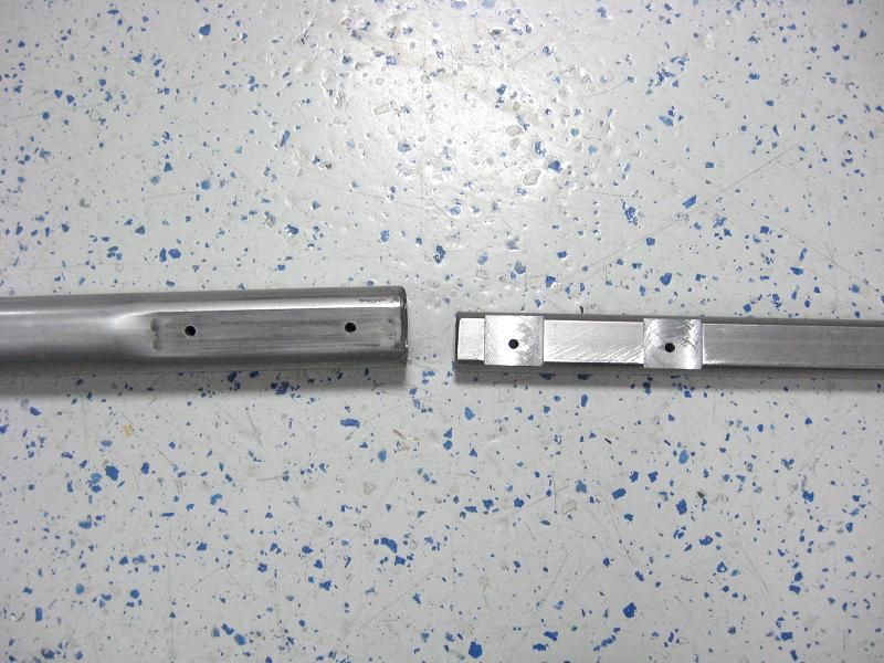

the steering column is designed to collapse during a front end collision to protect the driver and the 2 parts of the shaft are linked together with plastic shear pins that give way in an impact..... it's a bit late now but the column should never be hit with a hammer to remove the wheel as these pins don't take much force to break them.
This is a picture of how the 2 halves fit together ( off another car) one bit slots inside the other and the pins hold the 2 parts together...
The best advice is to remove the steering column / box from the car and replace the entire thing with a known good second hand one ( from a series 2 if poss as they are easier to adjust and don't go out of adjustment so readily in the first place)
You could remove yours from the car and try to repair it but how confident would you be of the repair? You don't want it to fail and you end up doing a Senna.... on the other hand, what if, god forbid, you have a heavy front end crash and the column doesn't collapse because you've used something too strong...... you don't want to take chances with your safety....... get yourself a good second hand column and be done with it.
