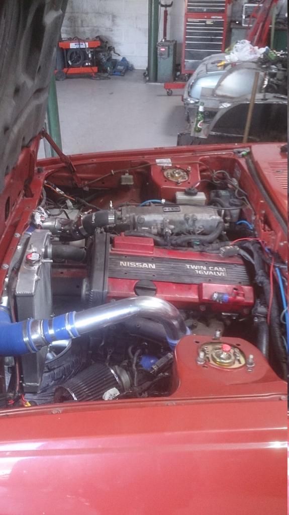

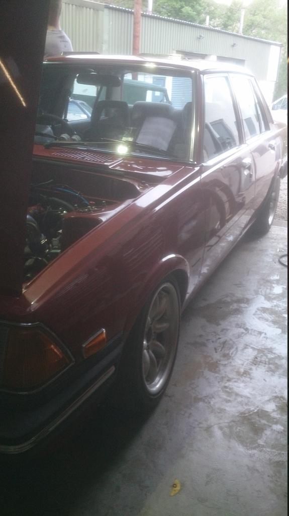

Its a CA18DET with stage one mods. nissan gearbox and custom prop.
Up front iv fitted Nissan s13 coilovers and modified lower arms to fit mazda subframe then nissan knuckles, hubs and brakes too (handily the same 4x 114.3)
kept the mazda steering box and utilized the oem tension rods. removed ARB
OEM setup at the rear, same 4 linked axle as on an fb i think, pretty sure the old front setup was also the same. snapped a half shaft within a month

Bodywork on that top shot (engine bay), could be easily mistaken for 1st Gen RX7.
So as you say, maybe a lot of common parts.

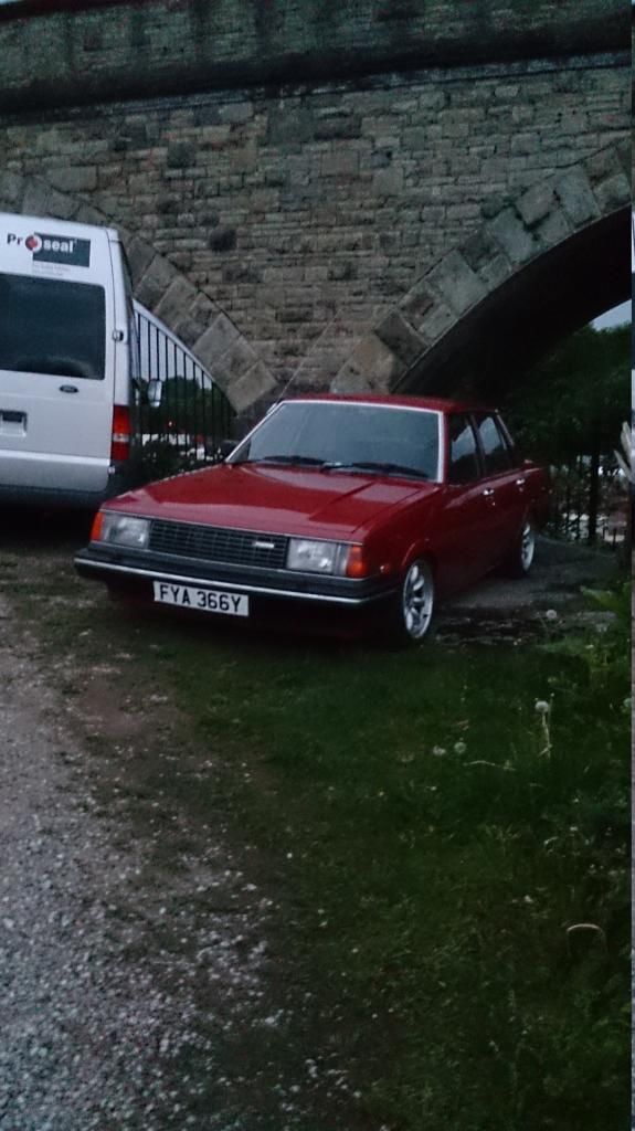

If you car is 1982 that equates neatly to a Series 2 1st gen production year. Your colour also looks like Renaissance Red, which was a Series 2 colour.
