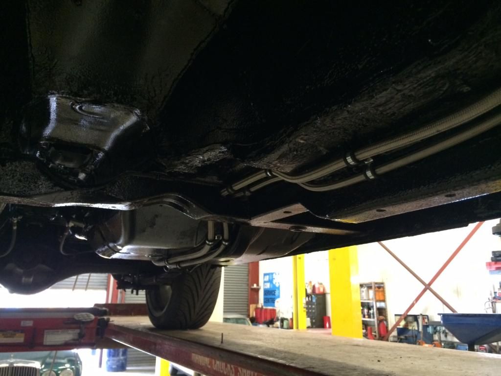

For some reason when I bought my project 1985 fb the entire fuel return line from engine bay back to tank is missing just the flexi bit left with a screw jammed up there?
Does anyone know if you can buy these ready made or will I have to get a roll of pipe and bend it myself

It doesn't have to be a hard line under the car afaik.
Re: Fuel lines
Good point I was thinking of running a nice braided steel one all the way for both lines anyone else done something similar

I have rubber fuel lines under one of my cars, tucked up against the chassis rail. Never had it mentioned in an MOT.
Held in place with cable ties even.
