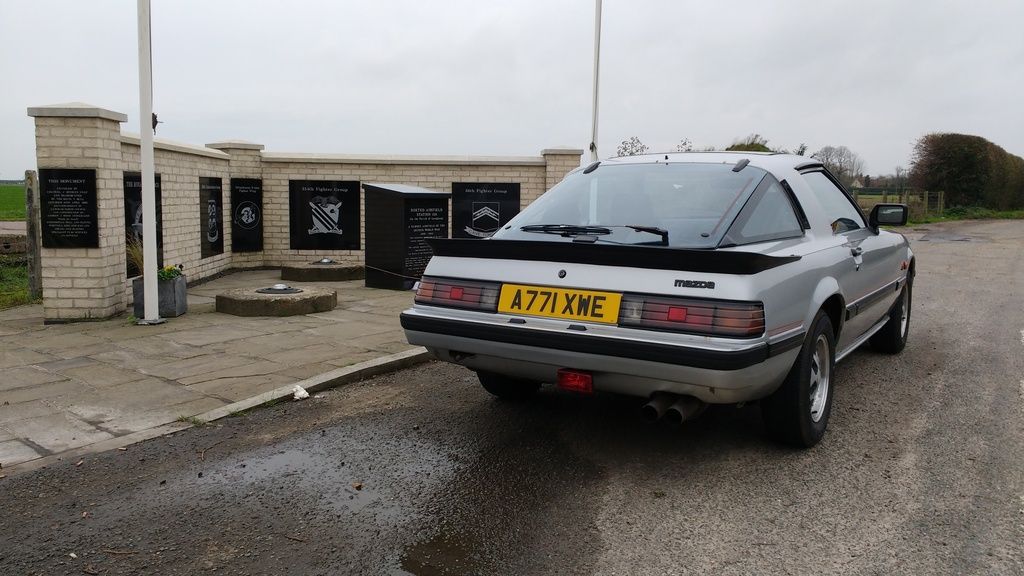

A couple of photos taken at the Boxted Airfield RAF Station Memorial earlier today
First proper drive today after she was laid up by the previous owner in 2005. I did an ~30 mile journey and took her to the buzzer a few times when warm. She felt good, no issues to report, so I'm really pleased! There's a long list of non-urgent work to do over the winter and then hoping to take her to a few events/shows in 2016. As mentioned above, Retro Rides is in my diary as a start

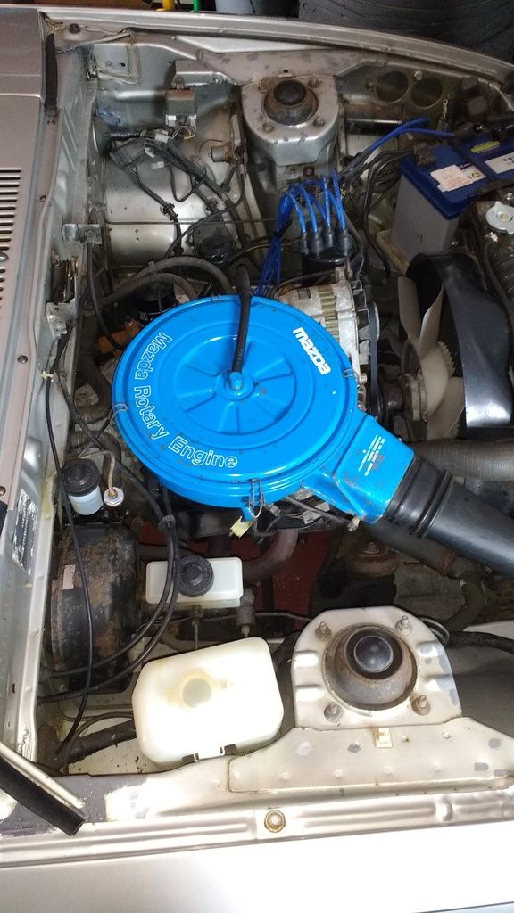

Tarted up the engine bay with slightly less rusty air filter cover plus new NGK ignition leads
refurbed vacuum metalwork (POR15) and silicone hoses (they are BLUE, but flash males them look them purple
Slightly better than when I bought her - but still WIP

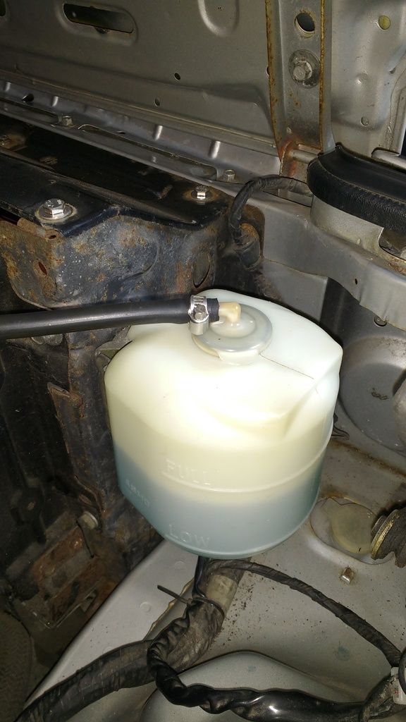

thorough clean out of horrid deposits in the expansion tank and new S/Steel clamps to hose;

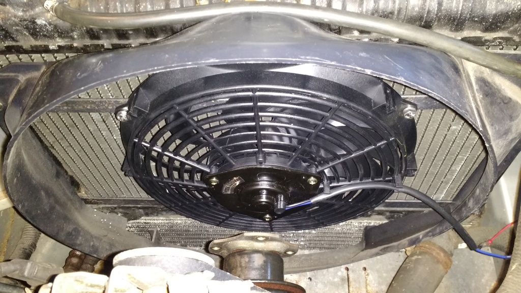

....to enable fitting of 12" (largest that would fit) electric fan. The viscous fan wasn't working (no surprise there) and was causing a huge darg on the fan belt and irritating squeal above 3,000rpm. A lot quieter now!
I managed to retain the shroud to keep a little OEM look. I will now remove the shroud for a good clean and to treat the fan mounting bars with POR15. I also have a thermostat to fit, along with new top and bottom hoses, so I'll remove the rad to give it a good flush and POR15 that at the same time.
