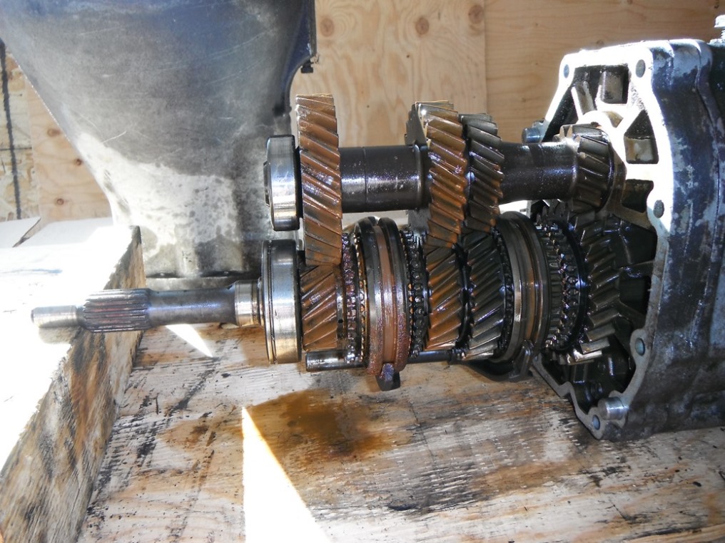

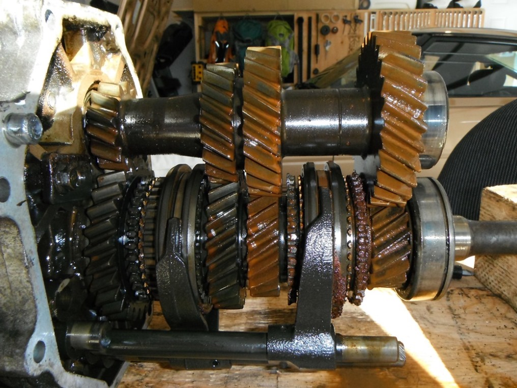

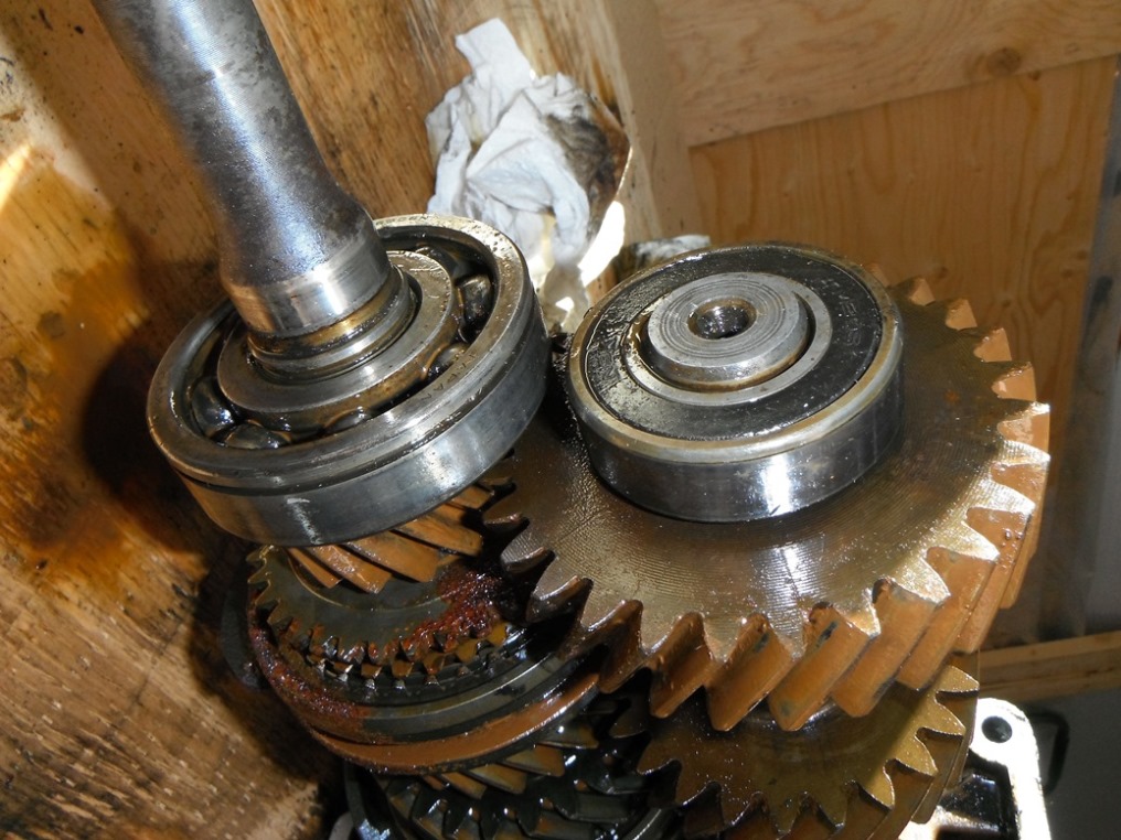

When trying (oh boy was this painful) to separate the front bell housing from the middle housing the Haynes manual says to "tap on the shafts with a plastic hammer" and they will come apart.....well mine did not!
I checked many times to be sure that i had removed all bolts and snap rings and after a good soak in deep creep I (rightly or wrongly) took a bigger hammer and a wooden block to it........
the result is as follows:
Gearbox Rebuild - Main Bearings Stuck on Shaft
tomsmy

So does anyone have some advice as to how i can remove the bearings from the shafts?
I was hoping they would stay in the front cover......
I would also appreciate if anyone can tell me what I should have done to avoid this rookie mistake......
Let the mocking begin!
thanks
Tom

Re: Gearbox Rebuild - Main Bearings Stuck on Shaft
From the pictures above the box has had a fair bit of water in there which is the cause of your problem, you will need a puller to remove the bearings probably easier to go to the local garage and get them to remove them but that box will need a full strip down to check all bearings, i doubt it will be the release bearing as that would generate a noise when pressed,
