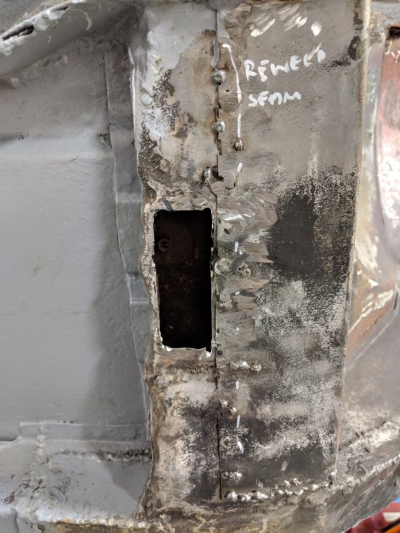

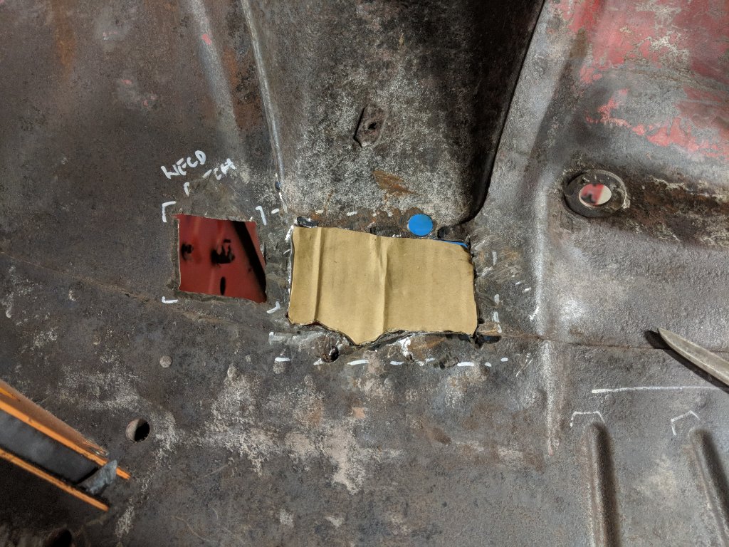

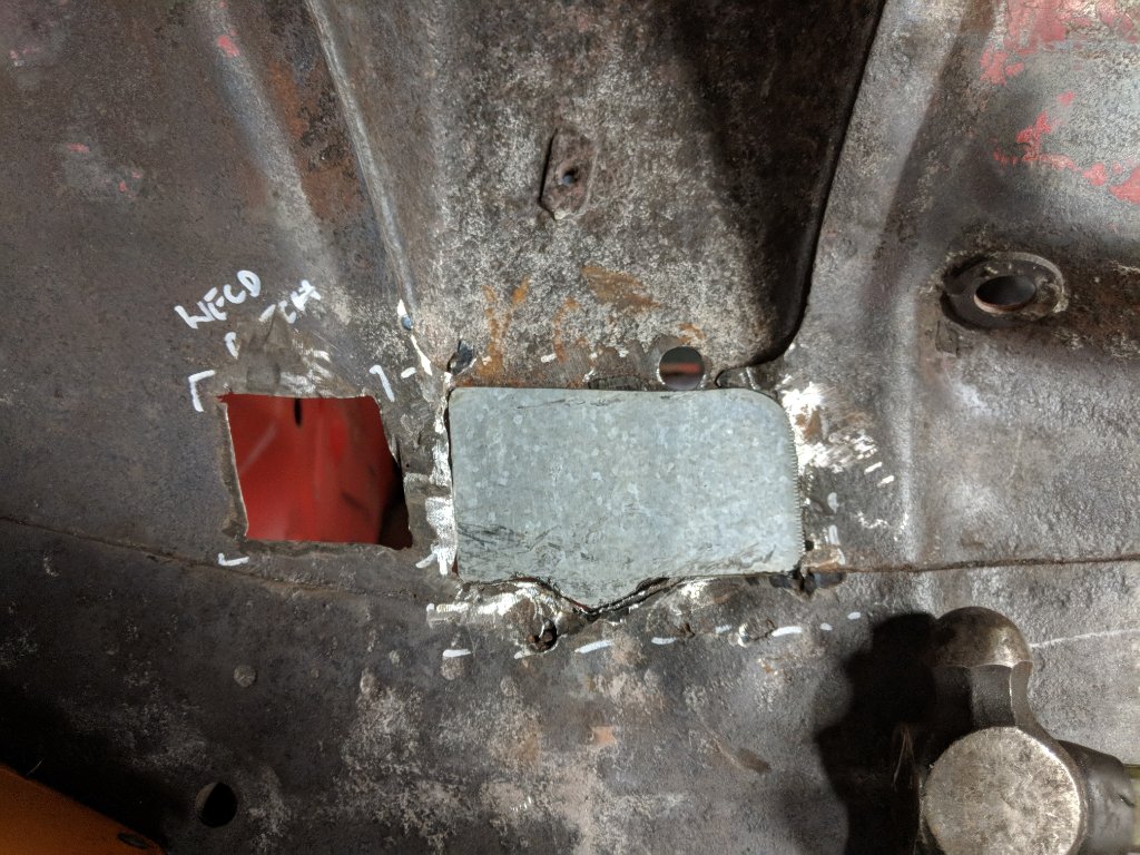

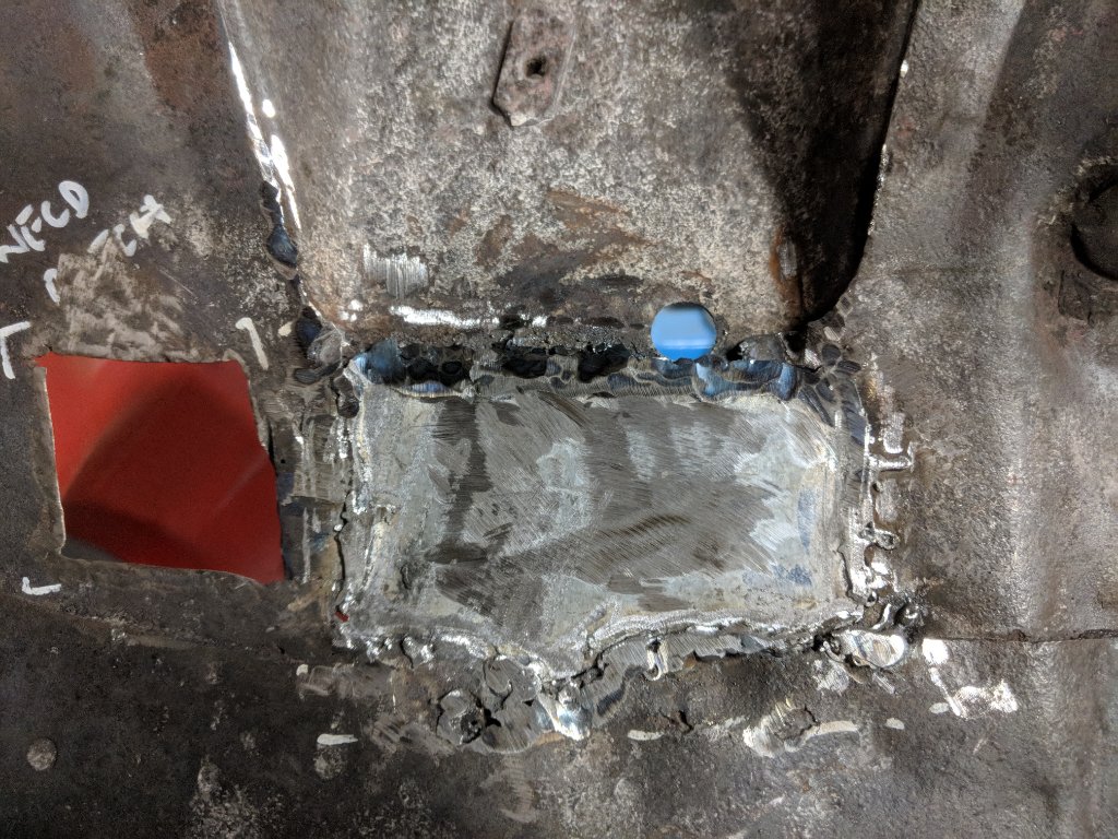

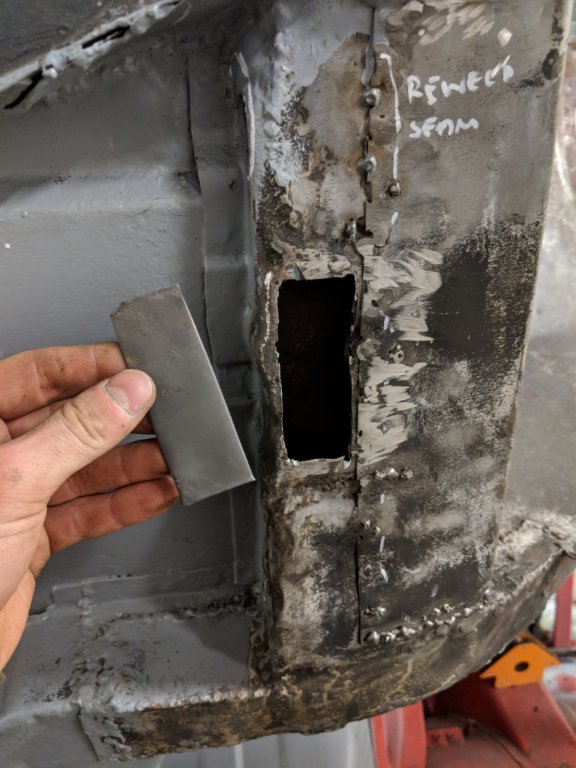

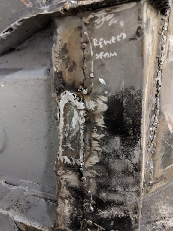

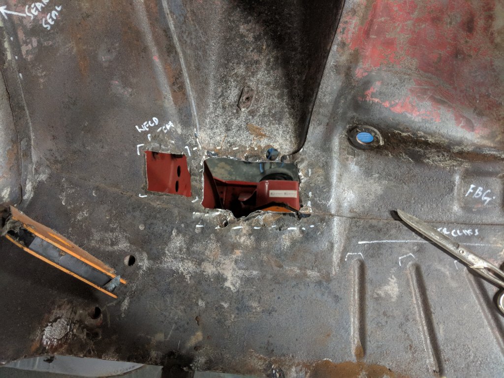

So to that end - I worked all of yesterday in my mates body shop and then went to the garage till 0230 and tried to get all the welding done. I've also found out the the dockyard does acid dipping and sand blasting so I'm getting all the bits acid dipped tonight (will take a couple weeks). I don't really like the look of all that hammerite I put on the engine mounts etc so I'm going to hibuild and block them down and then spray a satin black which will give it a smoother finish!
Yes I'm going to have trouble getting all these metric fastners for the build anybody got any ideas what I can do? Maybe redrilled alot of the holes and re-tap? But that may be alot of ball ache.
Here's some pics of my welding I did this morning, it's really not the best but fiberglass will be going over it and there's no more rot as such!
Used the old carboard cut out trick - works a treat!!
Jake

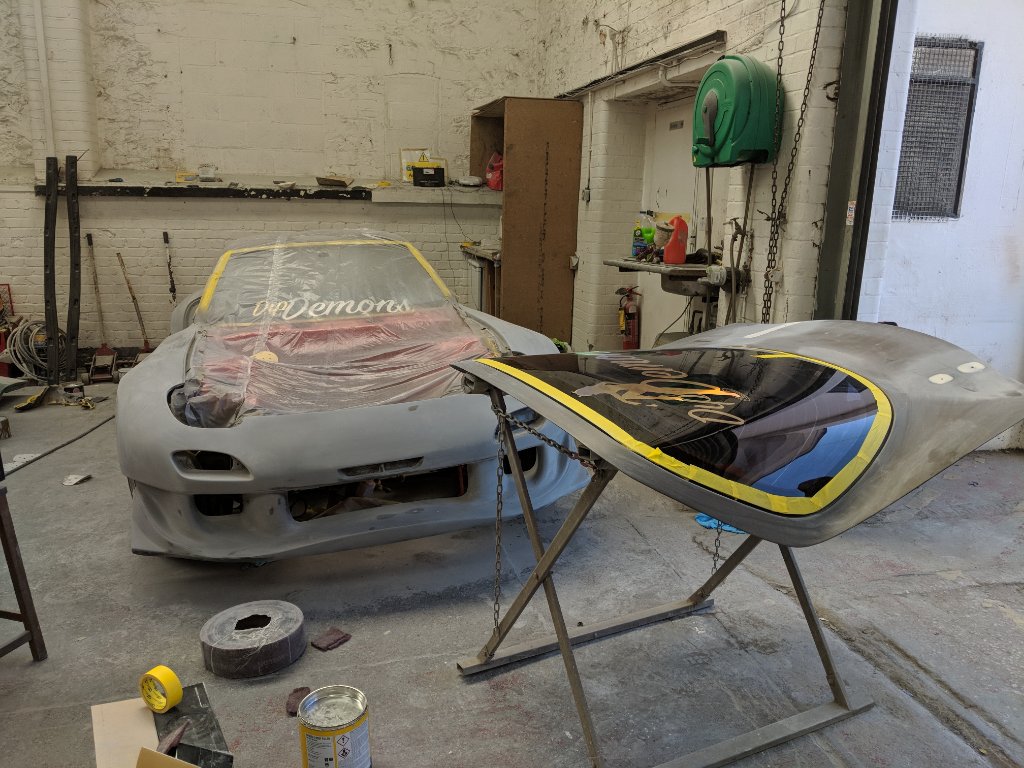

Here's a quick pic of my friends car I'm currently helping him with (a little off topic!)
