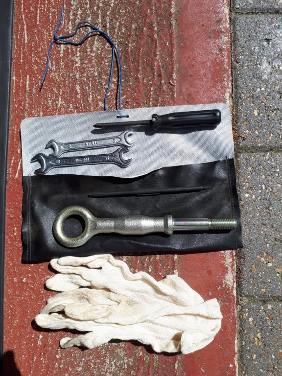

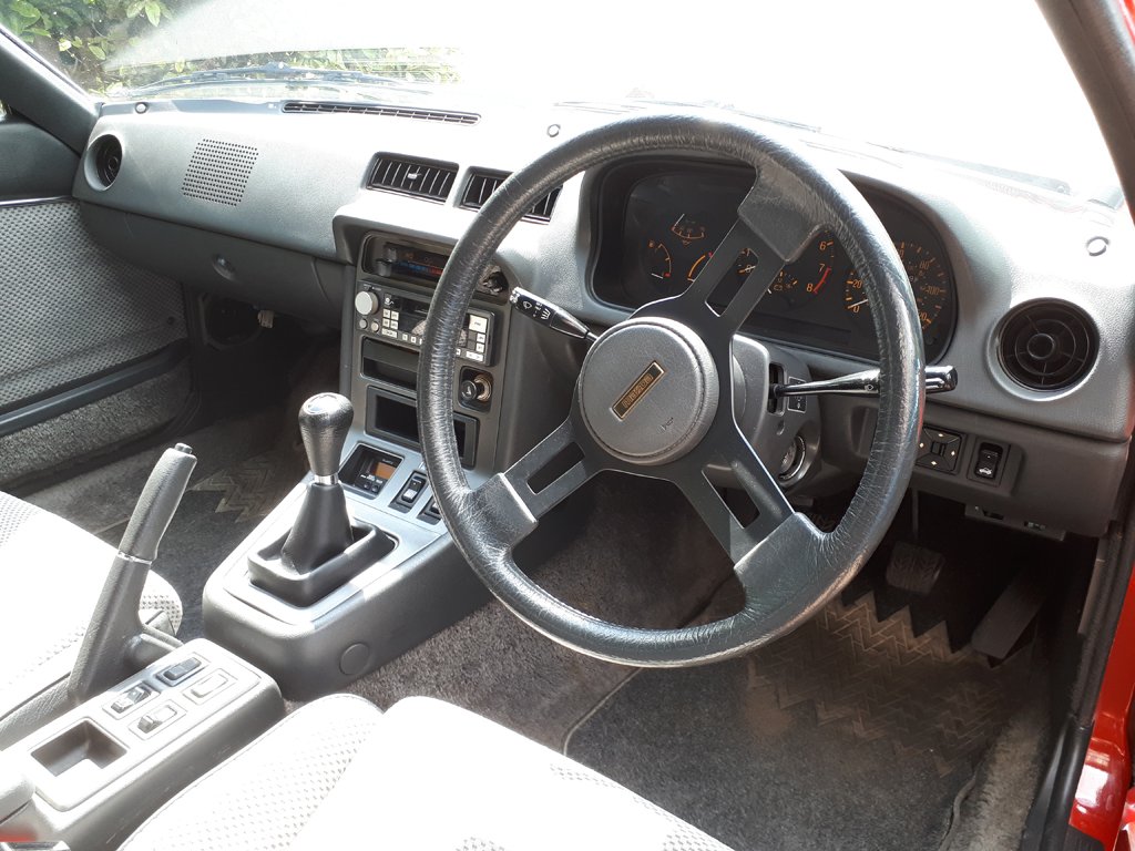

Forgot to say I picked up KIMI 3 a week ago, pics below taken the day she arrived at my place. I haven't had much of a chance to drive her much, especially with the lousy weather! However, I did a 40 mile run and she was a delight, but I do have a strange "rubbing" sound to sort out from the rear, on left turns mainly. I was aware of it before I purchased, so reflected in the price I offered.
Interior is immaculate, apart from some wear and tear on the driver's doorcard vinyl Factory fresh toolkit and towing eye - were the gloves in there too from the factory??

They certainly look like TWR. Need to look at another set to be sure. Front unfortunately damaged long ago and lost....

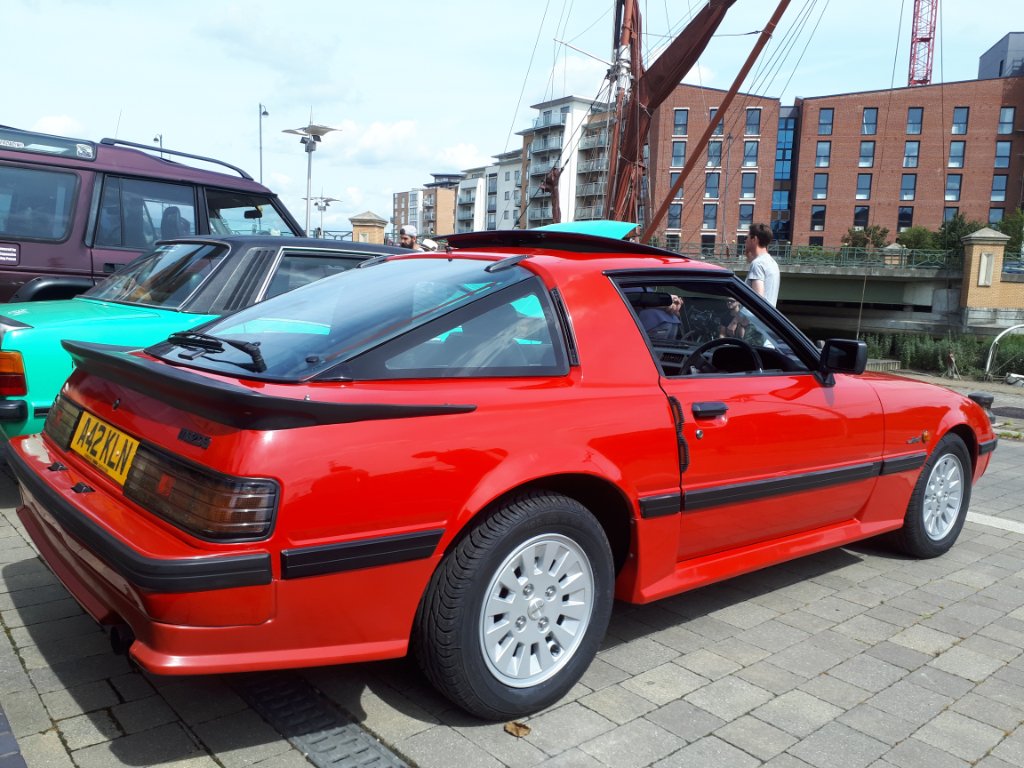

Lovely day here for a run out to a local show, "Cars on the Colne", hosted by "Roman Roadsters". A wide rnage of vehicles on display and quite a few people stopped to ask questions about KIMI 3
- 2019-07-21 11.06.26.jpg (269.32 KiB) Viewed 13600 times
- 2019-07-21 11.08.10.jpg (209.95 KiB) Viewed 13600 times
