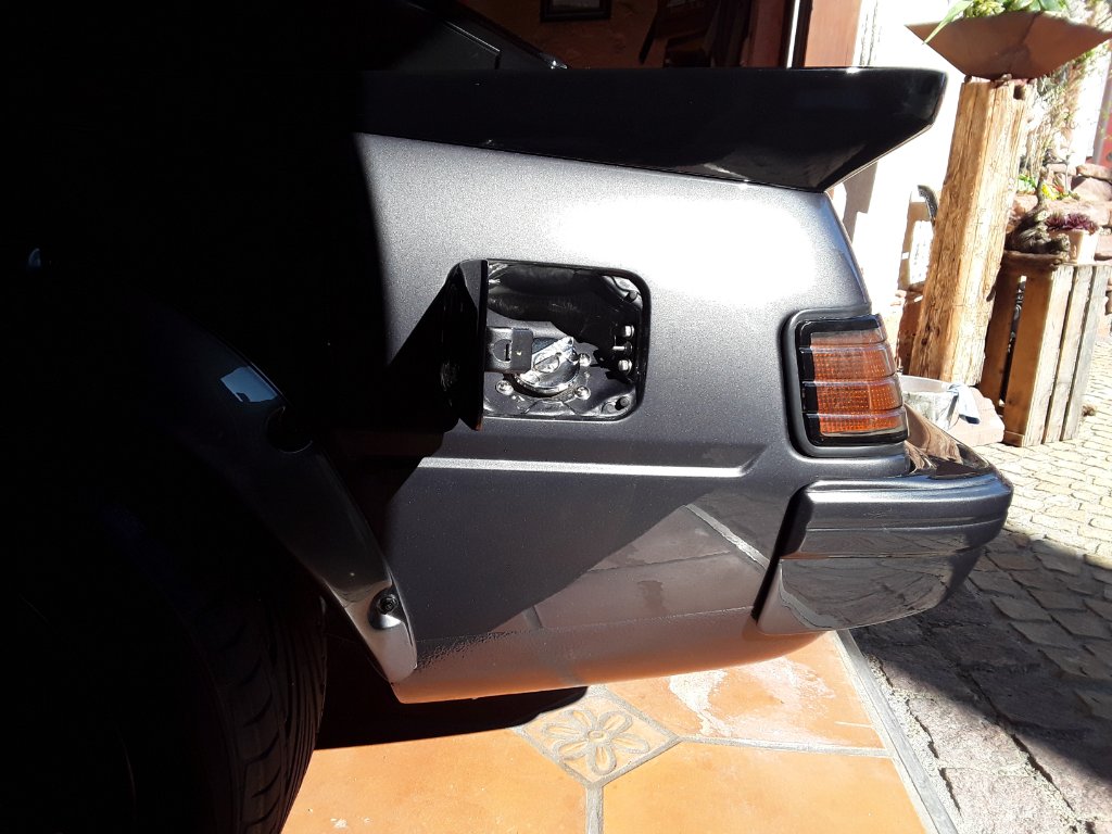

I forgott to tell what i found out! All the modern E10 compatible cars got a plastic fuel cape and fuel inlet. So look out for yours! Very aggressive these fuel.
Stainless steel screws and chrome will help a lot.
