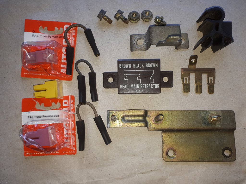

2nd little job was to tidy up the fuse block near the battery.
Removed and dismantled:
Cleaned up, lacquer applied to metal bracket, PAL fuses (bargain Eurocraparts "end of line" items, about 65p ea)

I just cleaned and lacquered the fuse holder bracket as there was zero corrosion and the passivation looked OK.
On the previous page, for the carb parts I plated & passivated, I used a "fish tank" heater for plating, but not passivating. I found that leaving the parts in the passivating solution for a bit longer gave a very acceptable finish. I must admit, it's a bit of trial an error when plating, but the more I do, the better the results are getting. However, a great idea, I'll try heating the passivation solution next time and see if that improves things further
