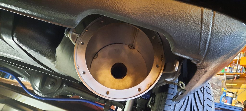

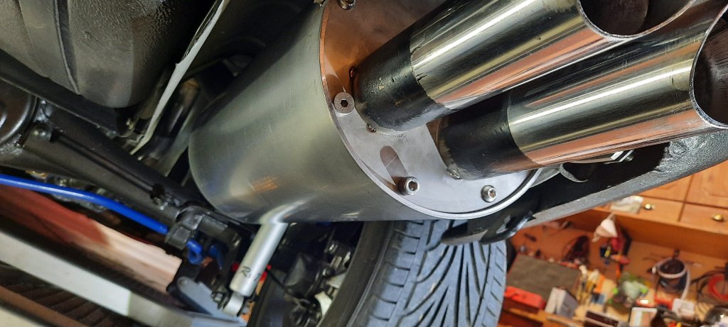

I just test fitted the muffler and without anything inside it Sounds better then the old one.. Next all fixed parts where welded to the finish and will have to built up with stainless steal wool and a special Material out of a AMG Mercedes race muffler.
Also i will have to decide what are the best looking screws. My daughter like the left one most.
Looks very nicely made, and I think the button heads look best!
gt_james wrote: Fri Mar 19, 2021 9:21 am Looks very nicely made, and I think the button heads look best!
James i am with you. Japanese tests prefer big mufflers 20x 8 zoll quiet down a open exhaust port without restrictions. Thats what i did.
500 x 230 mm will be the absolutely maximum when you did not want to destroy the rear design.
You can see the small place welding the entrance of the muffler then. I am be able to open both sides and delete all parts together inside for repair or sound change with different wool/stones inside.
