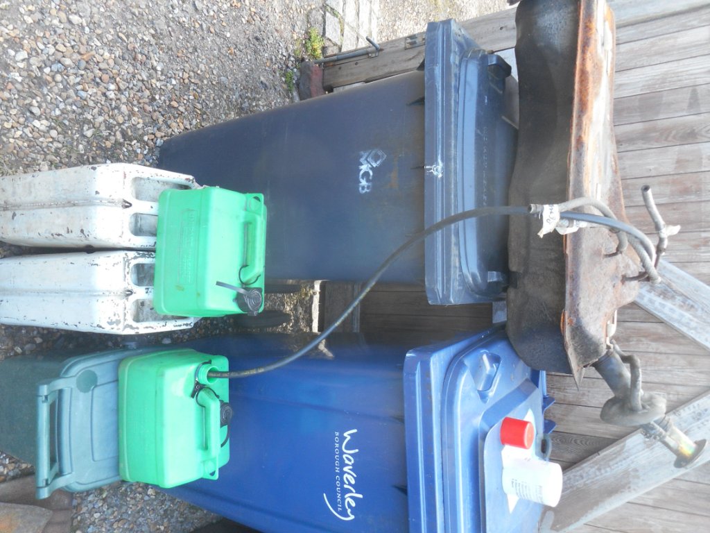

well it seems not to leak.....I had no idea how much fuel was in it, lowered out on a jack, plugged pipes and rolled it around, no leaks, it was heavy, very, and I got 46 litres syphoned out of it!

That's great news.
If you can, I'd try and take a peek inside with one of those cheapo miniature USB cameras to see if there is any rust inside, particularly on the top of the tank. I did that with mine and was amazed to see only a few spots of surface rust. From what I've heard the tanks tend to rust from the inside out, especially where condensation can gather on the inside top of the tank.
This sort of camera (Windows & Android version: £5.39): https://www.ebay.co.uk/itm/USB-Endoscop ... %3A2334524
The tank being left with a full of fuel may have been a good rust prevention measure
