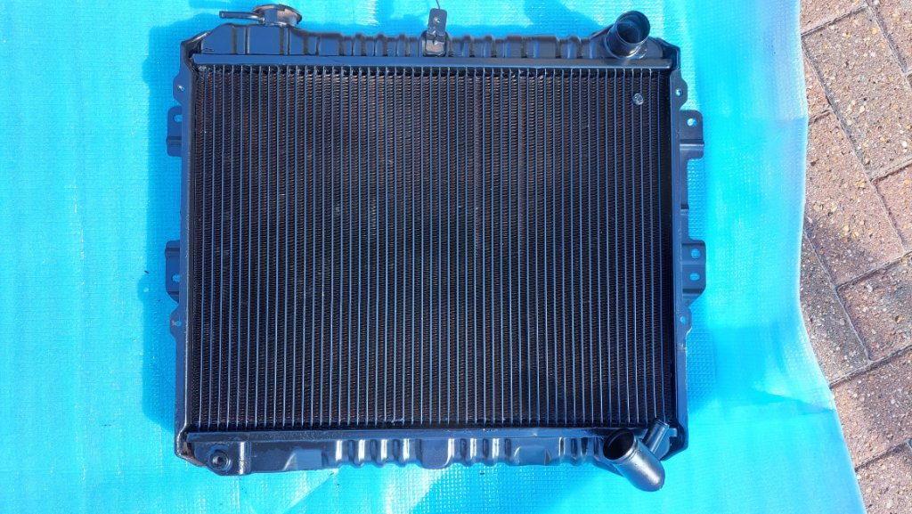

Re-cored rad looks good, upgraded with 3 core, but still looks OEM :thumbup:

Looks like it was done in the right way. Congratulations! Keep your car jdm not chinese :lol:

Looks lovely. Is however the overflow from the cap not pointing in the wrong direction?
I am running a Chinese ally one. Might have to get the old unit recorded before Colchester radiators goes out of business!

kenwhiteside wrote: Mon Oct 04, 2021 8:22 pm Looks lovely. Is however the overflow from the cap not pointing in the wrong direction?
:o It does look like you are correct :(

Casey wrote: Mon Oct 04, 2021 11:59 pm
Well spotted :thumbup: - I would have missed that until I was just about to re-fit the rad and it would have held me up :thumbdown:
The radiator is now back with Paul at Colchester Rad Specialists for corrective work. It's not holding me up as I have a load of tidying up to do in the engine bay whilst the rad is out and I've not have any time to do anything other than fix the sheared bolt in the thermostat housing :(

Glad to hear it’s being resolved.
