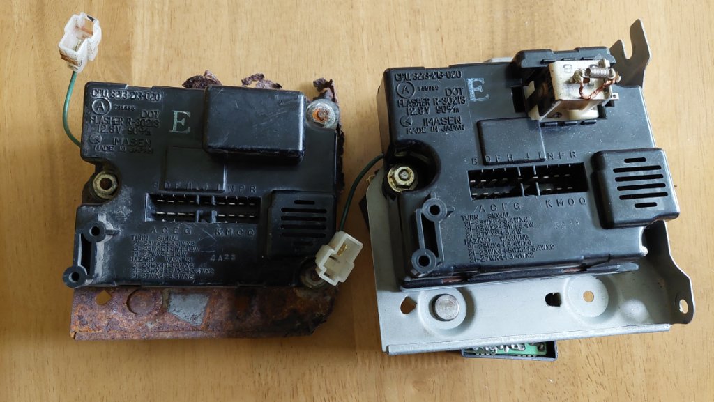

James brought me a couple of "CPUs" to test:
James was happy for me to post up my findings on here.
The one on the right is 100% OK
The one on the left has minor problem in that the ignition barrel light timer isn't working. It should turn off after 25 seconds or so, after the door is opened and if the ignition isn't switched on. It stays on permanently, or until the ignition is switched on, so my never have been spotted. The intermittent wipe doesn't always work either, but wiggling the connector shows it is just a dodgy blade connection, not the circuit board. I'll take this one apart and see if I can locate a fix the faults so it's 100% operational.

Was good to catch up!
That’s weird, the one you have tested 100% ok had an intermittent problem with the indicators not working, and was cured by swapping the CPU to a good one (on loan from Jesse :thumbup: )

It could be the main connector is a bit dodgy, I've found that is an issue with several of these units. I'll look again for an intermittent fault if I move the connector around.

Casey wrote: Tue May 24, 2022 8:55 pm It was great to see gt_james and his white FB on Saturday at the RetroRides event at Goodwood.
GT_James 2 CPU modules.jpg (123.81 KiB) Viewed 10926 times
I retested both these modules today and got identical results.
I tried wiggling the connectors on both units to check for any further issues and, apart from the dodgy intermittent wipe function on the module to the left (solved by wiggling), all the functions on the unit to the right were solid as a rock.
I'll look to clean the connector on the left module, and fix the barrel light delay malfunction. I can then use that unit as a test bed for the "lane change, 3 flashes" add-on module that James is going to send to me.

One of Jame's CPU's had a fault with the ignition barrel light timer, so I took that module apart today to do a visual check. The barrel light should
come on when the driver's door is opened, and go off when the ignition is turned on, or after ~30 seconds. The light was remaining lit, so the timer circuit had failed.
I immediately spotted the classic signs of a blown electrolytic capacitor; the top of the case had bulged slightly and there were clear signs electrolyte leakage. The 3 "score" marks on the capacitor are there to create a weak point if pressure builds up and allow the capacitor to bulge and leak, to prevent it exploding.
On checking my circuit diagram, this component is a critical part of the barrel light timer - bingo, hopefully an easy and cheap fix!
I also spotted some green verdigris on the connectors blades, which you can see in the photo, and would explain the intermittent operation I spotted. Those blades should clean up OK.
