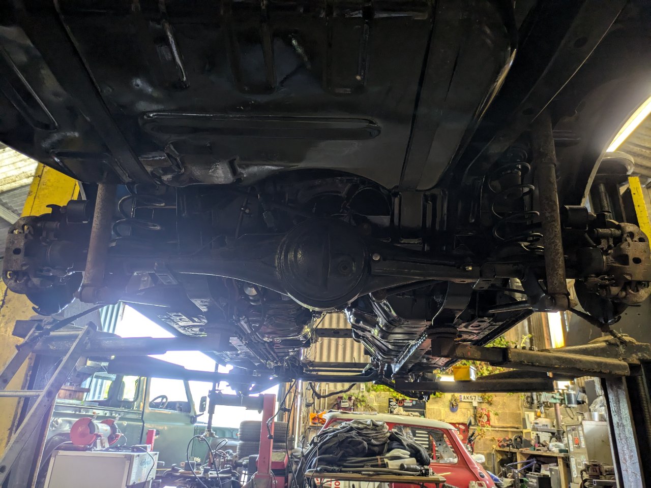

Hey, it's been a while...

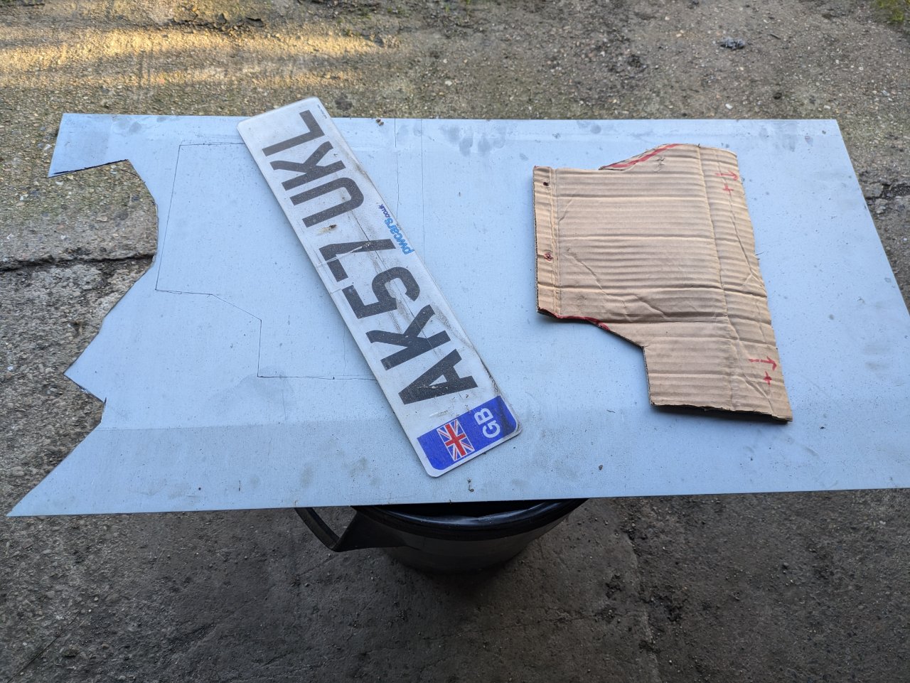

The car has been exactly as left in my last post for the last few years - the lift it was on died, leaving the car stuck in the air and I got distracted by work, renovating a flat and loads of other stuff. A few months ago I got the news that we need to leave our current workshop, which gave me the kick in needed to get on with the RX7 again. So I fixed the lift, and got stuck in. A lot of this is just going to be a picture dump as I've got a reasonable bit to catch up on, it seems like the order of the pictures is a bit jumbled up as well. Sorry!

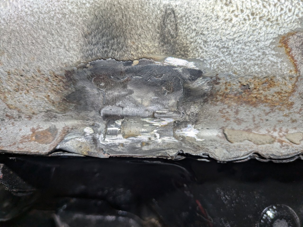

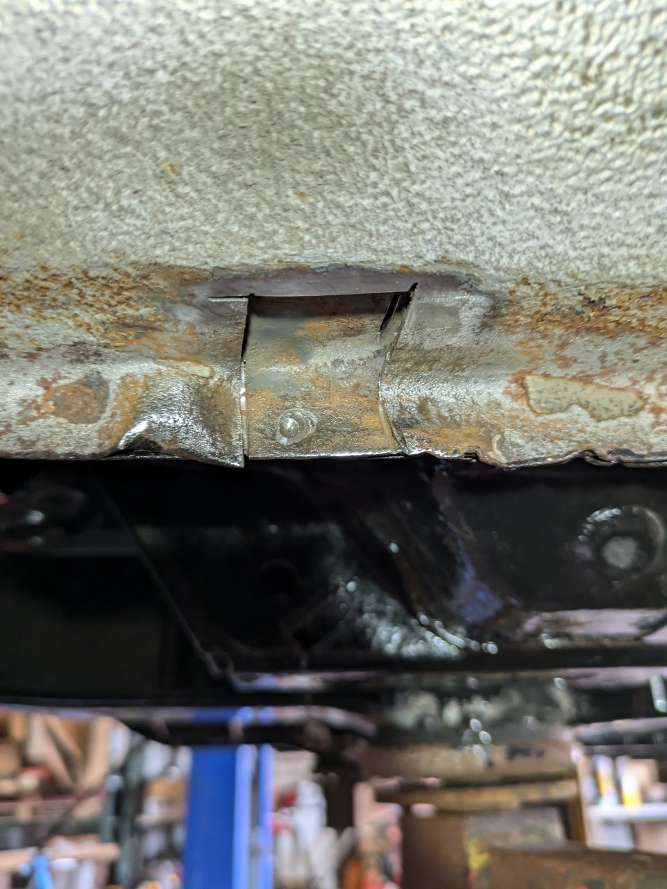

Welding first (I've done a few welding projects since I first looked at this, so was a bit more confident taking this on now):

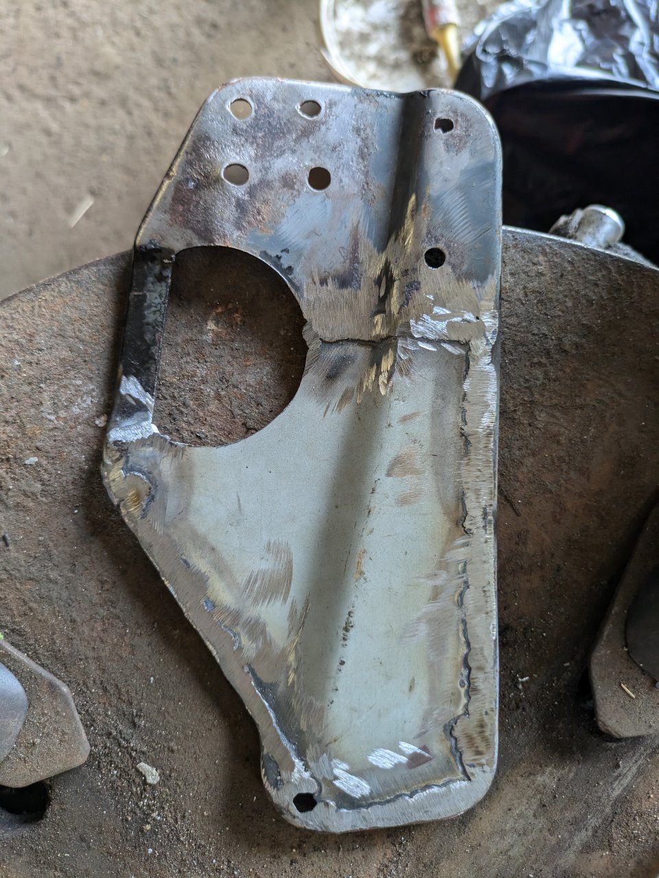

More welding:

One more welding picture, driver's side finished and in zinc primer:

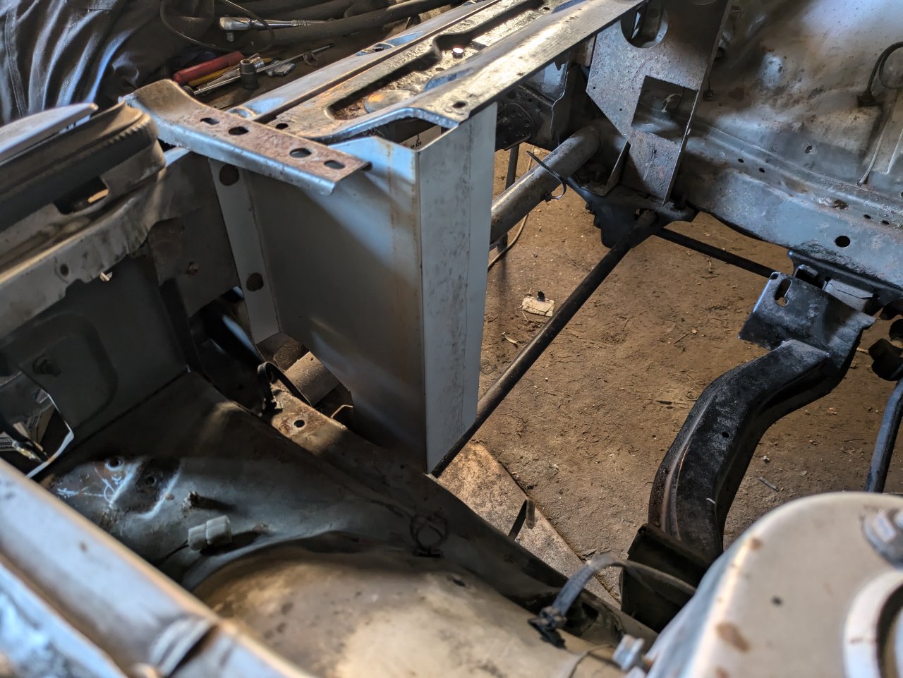

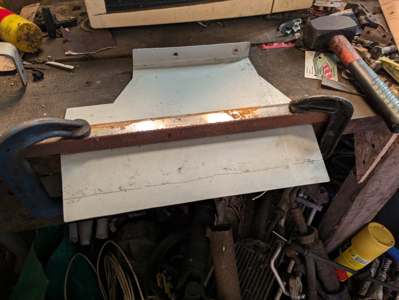

Right now I'm stripping the engine bay ready for paint and also sorting out brackets for the new radiator and intercooler I've got to go in. Some seriously high-tech fabrication here... What I need to do is make the cowling in front of the radiator a bit wider to accommodate the intercooler, I'll also need to move the battery to make room for the pipework.

Solid suspension mounts come in handy aye :lol: . Nice work! Colum seems like a pretty good fulla. I keep meaning to go and see him as he is just down the road from me. Look forward to more updates :thumbup:
Posts: 1336
Has thanked: 511 times
Been thanked: 454 times
Re: 1983 RX7 S2 - Flo
Great to see the updates. Some solid work there :thumbup:
