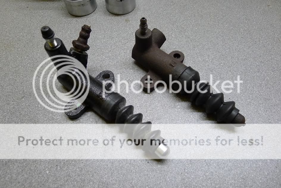

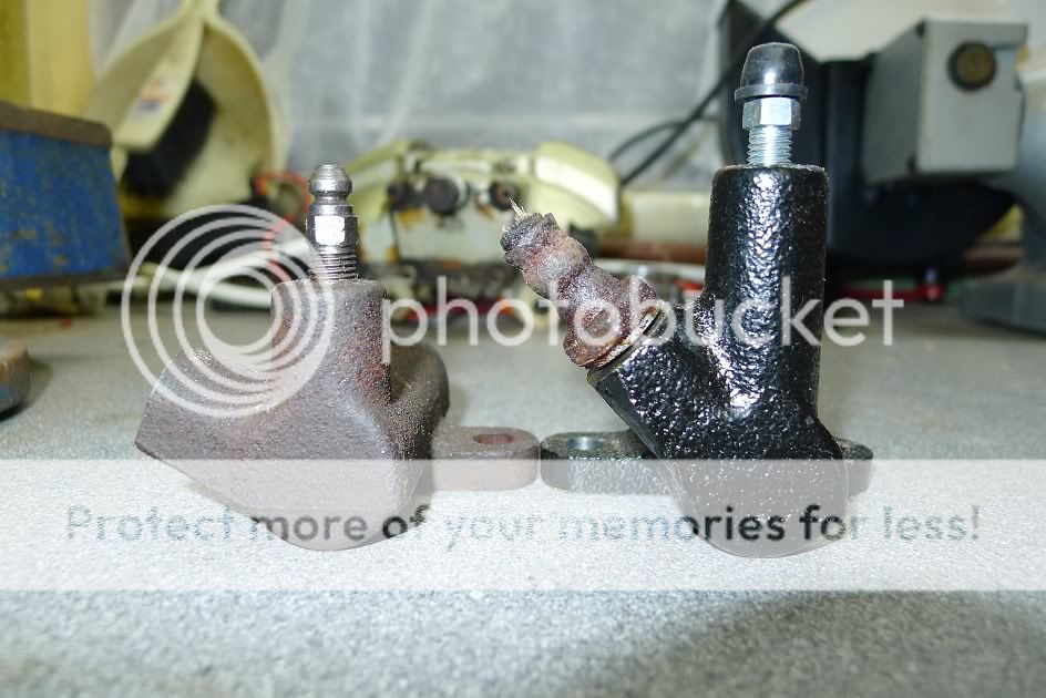

I'd previously guestimated that the slaves are internally the same as the mk1-mk2.5 mx5. Today I tested that, as my slave died.
Left is rx7 s2 right is mx5 mk1. I'm now running the mx5 piston and seal in my s2 body and its working fine.
You can buy 'repair kits' for the mx5 slave consisting of piston, spring, seal and rubber boot for about £15. Compared to £60 for a brand new master and salve that Ian found up there it's not too much use, but if you've got one kicking about the garage floor it certainly is a saving if its just the piston and seal that are damaged rather than the bore.
