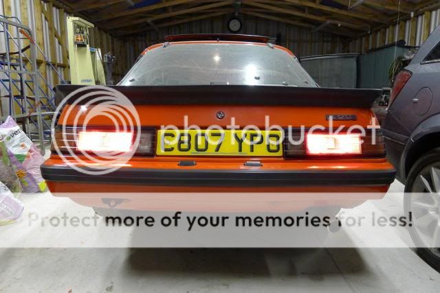

Done a couple of jobs this week, the rear lights always bug me so I pulled the single bulb holders and replaced them with stop/tail holders, looks better i think.
Side lights.
Brake lights
Also took the dangley fog light off and used the reverse light instead.

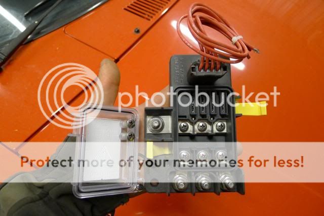

Next job, pull the fuse links and holder out and fit this midi fuse holder.
Its actually for a boat but it has 3 midi holders that will cover the fuseable links and 4 blade fused outputs to.
Top work on the rear lights, Keith, it looks so much better 8-) . It's something that always annoys me, too, that one-on, one-off arrangement. I've been trying an LED conversion but it keeps stalling as other things push to the front of the queue.

But looks good and symmetrical. th:

myatt1972 wrote:Next job, pull the fuse links and holder out and fit this midi fuse holder.
hi M8 does this replace the old style fuse links box that ive seen in my haynes manual? as mine uses the newer blade fuses like my T2 & FD! CHEERS
