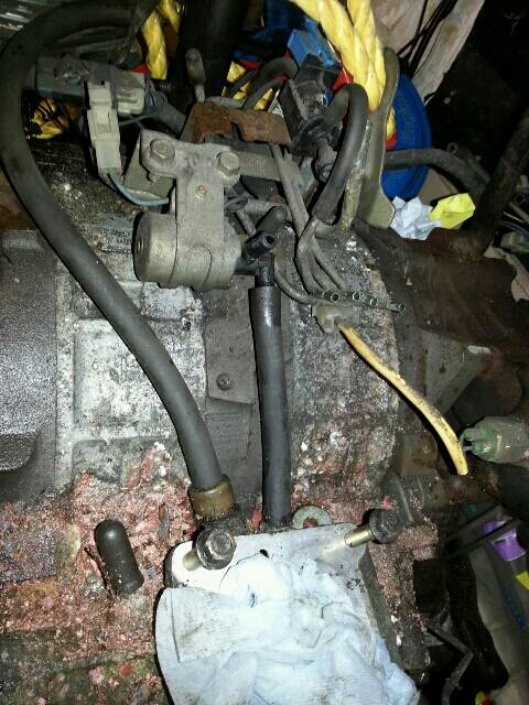

Hi guys
Some more advice saught, ive removed my engine from the car, hoping to give it all a good clean and find any faults, looks like a new clutch, pressure plate and bearing already. .. on the airpump/ inlet manifold ( above the thermal reactor) there is a hell of a lot of crystallised pink fluid, which looks to be coolant.
Ive attached a pic, looks to be alot there built up over a long g time, is this likely to be coming from a leaking gasket? I'll be removing it tomorrow for a better look and anyone whos removed it, is there 6 bolts holding it on?
Sorry for the poor photo, the gunks at the bottom of the pic
Rich
richrx
Posts: 569
Location: Glasgow
Has thanked: 31 times
Been thanked: 31 times
Re: cooling system refresh....
Post by richrx »
Possibly a better photo..
Chances are it's the inlet manifold gasket and the 2 rubber orings on the housings are knackered.
It should be 6 studs holding the manifold on. 2 on each end plate and one on each housing. Nothing on the middle plate.
If it's not that, check for leaks on the thermostat housing as water can dribble down from there an pool on top of the manifold.
X 2 for that, The inlet manifold has a hidden screw underneath. Not obvious and at first you wonder why the manifold won't come off the engine.
Where's this screw?
