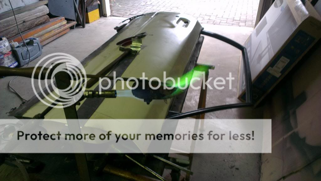

The next big project on the car was the only bad rust on the car.... The Drivers Side Door.
The view after sand blasting..... :shock:
Some old school hand bending in progress :lol:
Rust cut away and test fitting the new panel
Finally at the point to start bringing it all together
First pieces fitted
Sorry for so many photos of the door but this was quite a project for me and I took about 400 photos so filtering it down is not that easy....

Stage two for the door.....
Old school joints..... Has made the door a lot more rigid.
Finally coming together....
Ready for some paint

Thanks but it took 4 full weekends of work and several late weekday evenings to get it right. But I am really happy with the results, well worth the effort. I was fortunate that my first job was working in a sheet metal fabrication shop so got to learn a lot of tricks when it comes to projects like this.

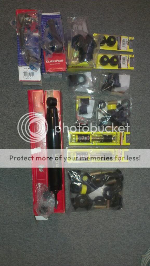

Here is the rebuild of the rear suspension (D)
This is what it looked like at the start. The watts link had seized solid.... Took me 4 hours to get if free. Ended up drilling the old rubbers out and using a wire buff to remove the rubber that remained.
The new bits waiting to be fitted, including a full energy suspension bushing kit.
Ready for cleaning and primed
Rebuilt out of the car and ready to be installed. All new brake lines including custom stainless braided lines
Installed and ready to run
All I can say is, the energy suspension kit and a new set of shocks was the best purchase I have made so far. It has completely changed the handling of the rex. And the all new brake lines are really worth it.

Do I take it you have fitted rubber bushes or are they black Poly bushes ? I used poly bushes myself.
Nice resto work on the suspension - powder coated or simply painted items? Not that it matters either way as the finish is cool.
