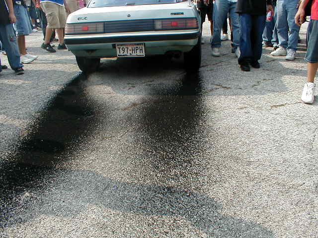

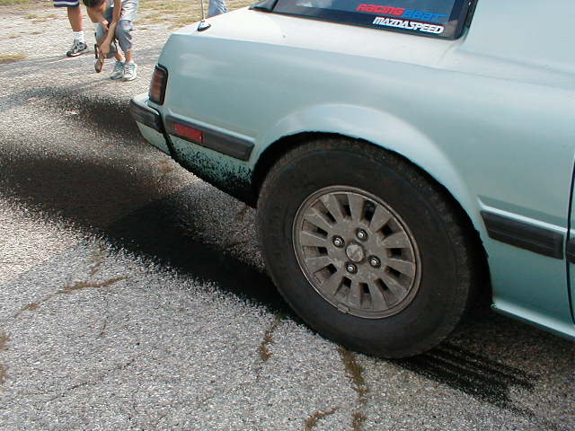

The aftermath. At least the kids liked it!
This was the 85 GSL that had 84 GSL-SE running gear.

Corrected me if i fault: 12A Engine+ Racingbeat exhaust = 136RWP
I love the small racingbeat decal, cause they are a great company since a long time testet their parts.

It's a fix :evil: Burnouts are soooooooo easy on a bike; two fingers for the clutch, two for the throttle, two for the brake. Even Stephen Hawking could manage it :lol: You were robbed! And who's paying for the tyres, lol :shock:
Re: new member
Hahah nice work on the skids there! Welcome to the forum aye 0-0
