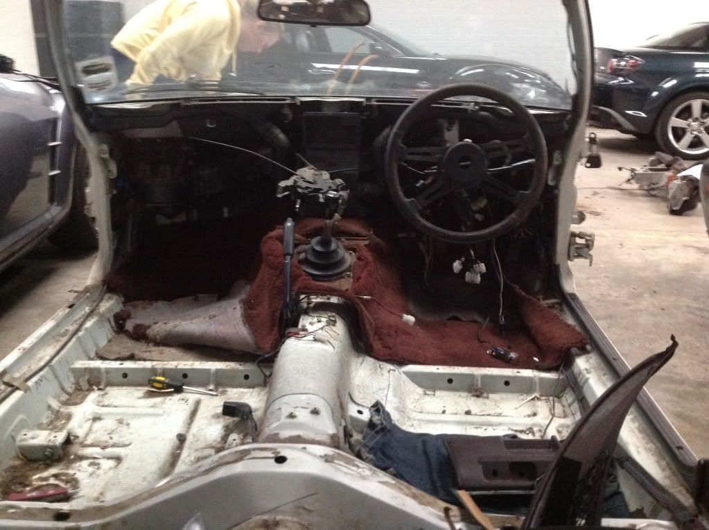

So I managed to remove the dashboard, some stubborn other pieces of interior and started on the loom and fittings in the engine bay. When I have finished removing all the final loom, fittings and interior, the bodywork will begin. Which if I'm honest I can't wait for as my SA does look very sorry for itself every time I get to work on her.
There is rust on the bulkhead under the windscreen behind the dash. Not sure how bad it is but will have more of an idea when I have removed all the heater piping and parts. There is some rust in the footwells and at the base of the b pillar on the drivers side. Around the rear windows there is quite bad rust and the panel is going to need some extensive work. When the car is stripped fully, I'll take photos of the rust for a proper before and after when the bodywork is done.
More photos to come when I have uploaded them all. I am trying to photo document as much of the build as I can for my records and help in the rebuild.
