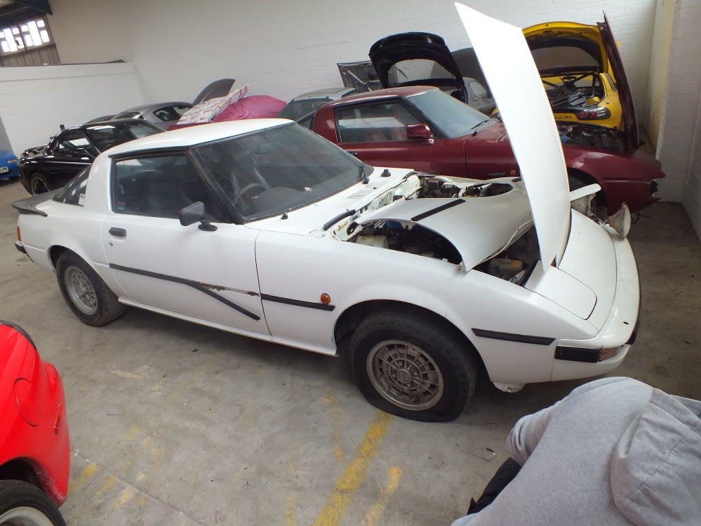

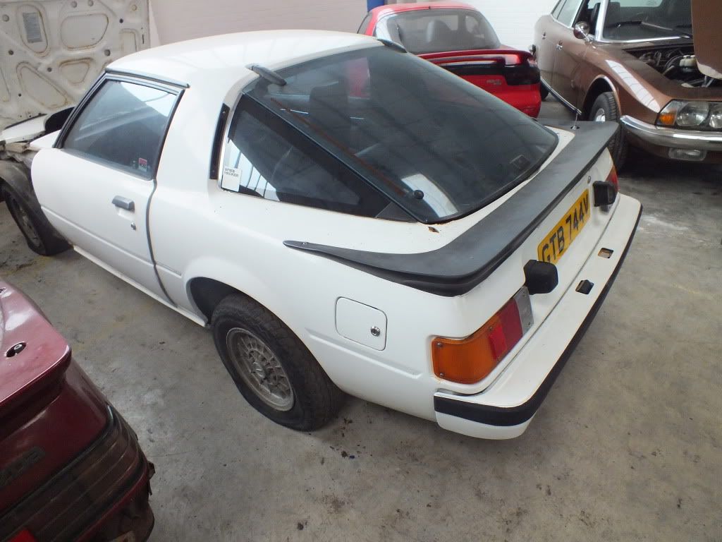

So as I promised I have some photos of work so far, not very interesting as its just taking parts off at the moment but then every project starts somewhere.
this is how it started. I plan to take her down to a bare shell.

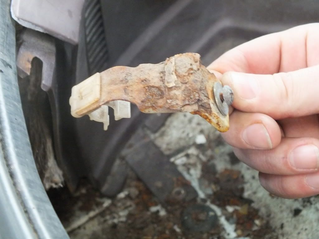

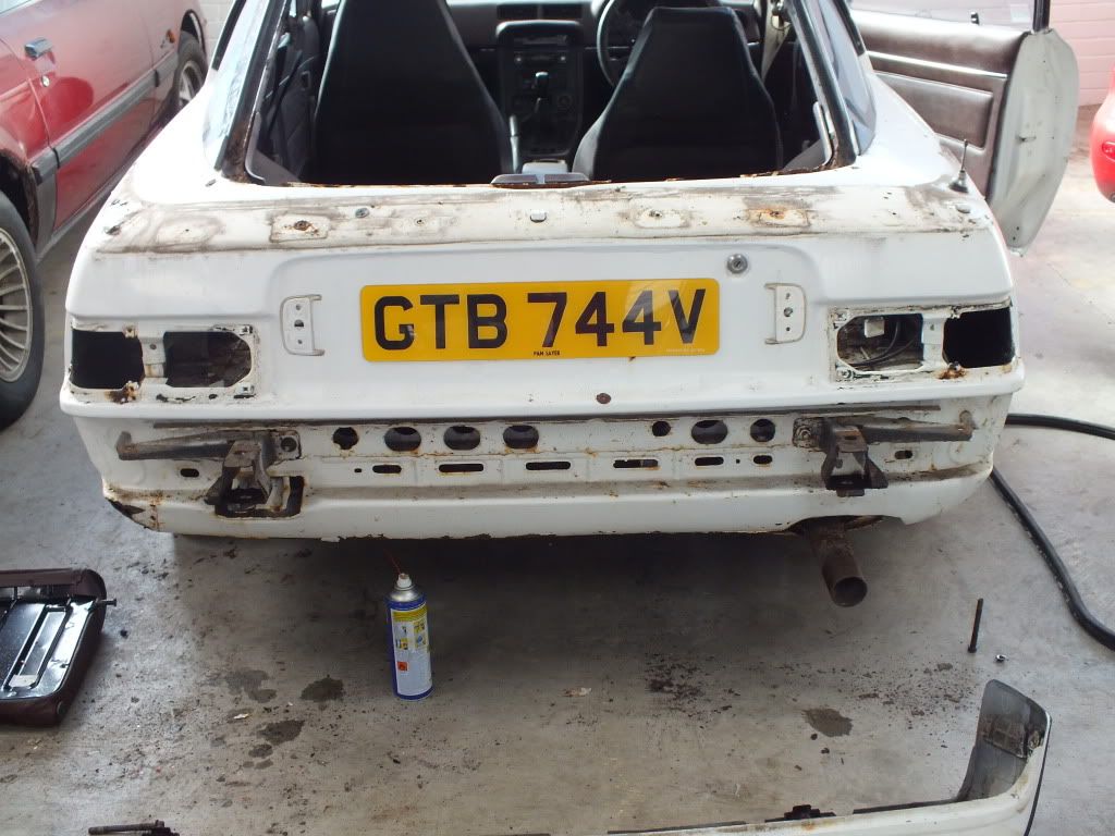

the boot area is really bad and as I want to remove the spoiler this is where I started. Most of it came away surprisingly easily, unfortunately so did some of the metal fittings ;)

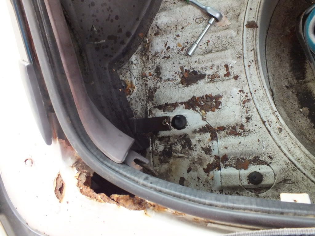

the edge for the seal is in a really bad way as you can see and to be honest the bodywork is shot on the passenger side, its going to be a big fix I think. I can put my hand through it and I will try and remove the side windows but worried about them cracking.

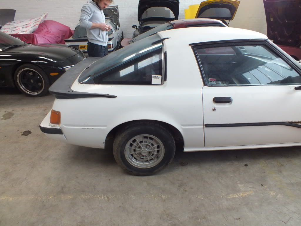

The bumper, lights, fogs and spoiler are off, rear seats out and some of the rear trim including the carpet which unfortunately is shot through and rotted so will need to find a replacement :( . The last guy to have the car also cut the fake rear speaker pods and fitted some rank speakers over the holes, great. They too have gone but will prob have to find some new/old trim pieces or fit speakers??

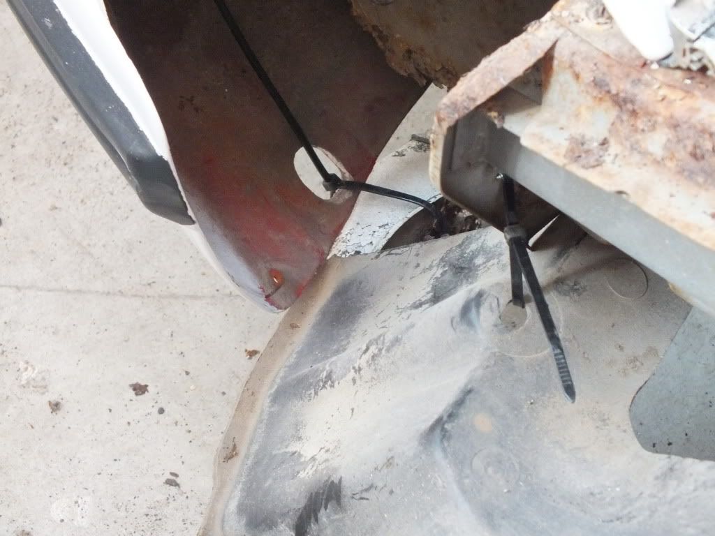

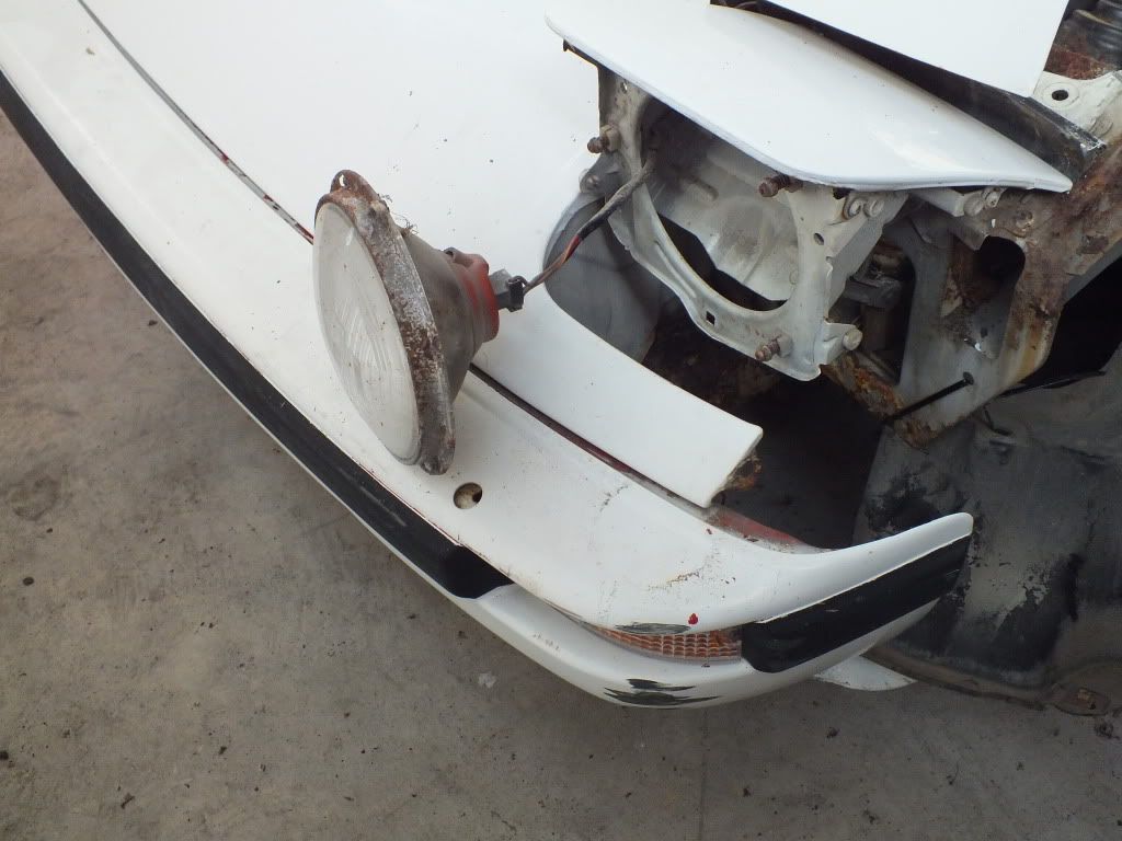

Just a couple more bodge photos, the front headlights have white paint spray covering them which leads me to believe they were sprayed the same time as the car, without covering them. Awesome! I think the S2 bumpers may have been red originally.
Also, taking the wing off I found that the front valance (rotted and hardly attached itself) was holding up the inner wing plastic with cables ties, the same technique for holding the oil cooler from hitting the road :roll:

What's the underside of your bodyshell like?... these cars hide their rust very well and by the time the outer panels rust through, the chassis rails, floor plan and a,b, and c posts are usually shot.
The rear deck on your car looks pretty crusty.... my advice ( for what it's worth) is to cut a section out of a scrapper then scribe it into your rear deck after cutting out all the rot.... much easier to do than to try to make a panel up and get that profile right.
