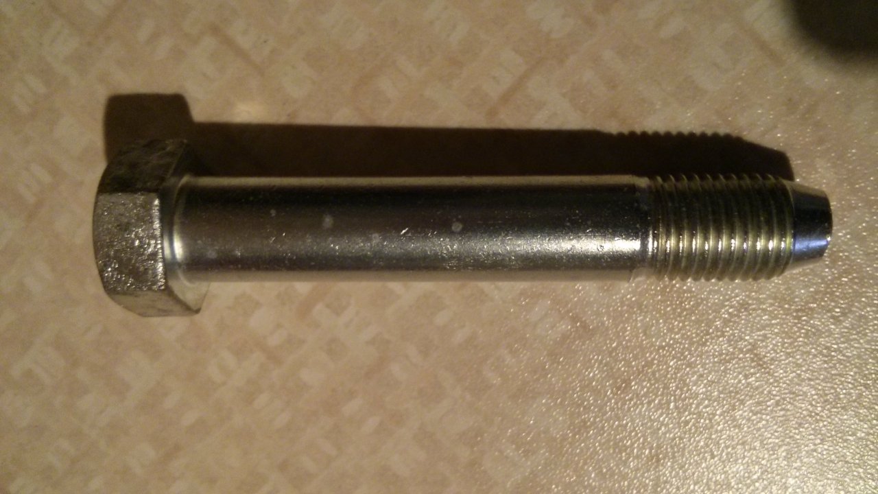

Suspension bolts re-plated using a "Gateros" kit. These were the first few I did, not perfect, but I got better at the process with the later bolts.
2015-01-09 15.29.37.jpg (208.49 KiB) Viewed 8407 times
2015-01-09 15.31.27.jpg (156.73 KiB) Viewed 8407 times

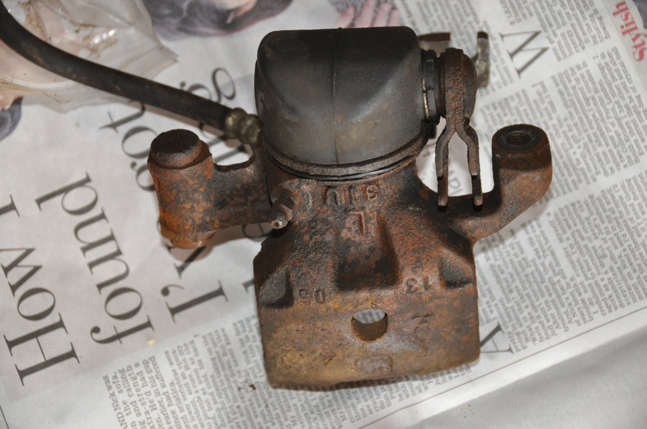

Rear brake calipers:
One before:
DSC_0027 (2).JPG (235.15 KiB) Viewed 8405 times

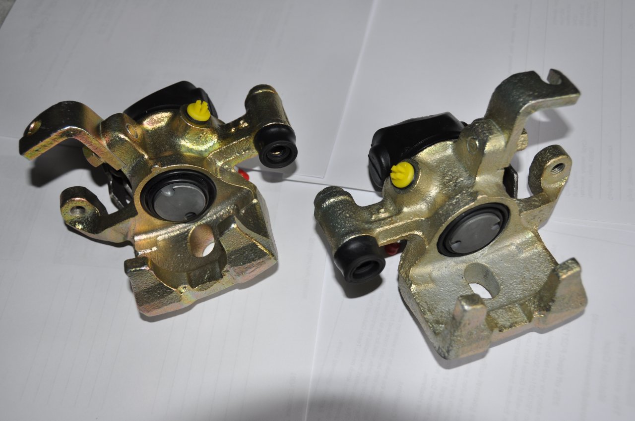

After Bigred refurb:

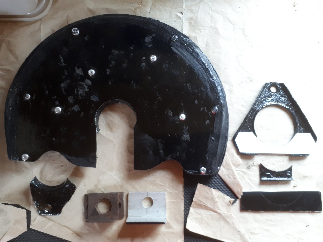

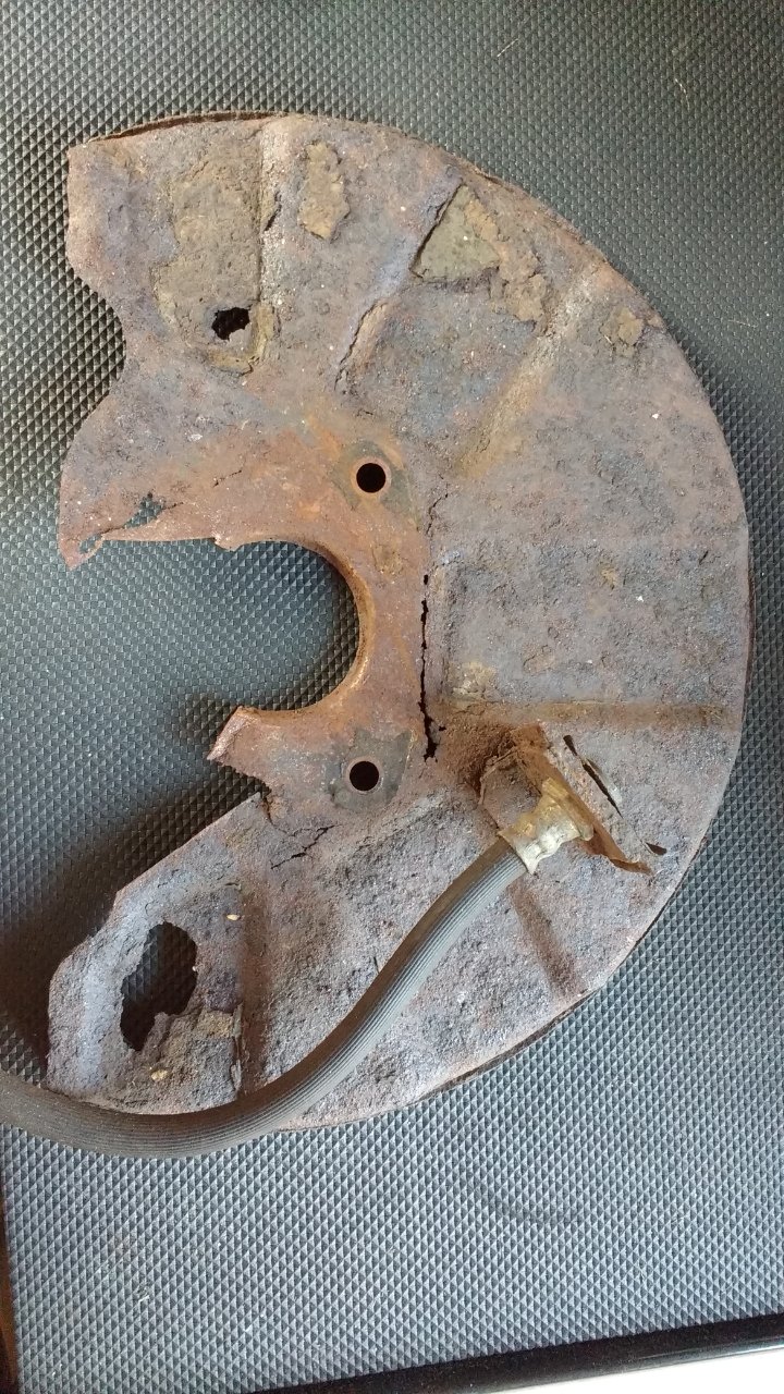

The rear brake stone guards were in a bit of a state, with missing bits and holes. I'm not too proud of the bodge I have made to make them at least functional, but at least they are not easily visible and will do the job.
Before:
2017-04-07 16.57.45.jpg (629.59 KiB) Viewed 4137 times
Aluminium plate cut to size:
2017-08-22 17.15.23.jpg (486.03 KiB) Viewed 4137 times
Replacement parts made. Ali shield pop-rivetted on, stainless steel strip curved around edge, POR 15 and sealant applied:
2020-05-18 19.20.19-1.jpg (168.84 KiB) Viewed 4137 times
Mounted back on the axle:
2019-04-19 13.50.10.jpg (242.84 KiB) Viewed 4137 times

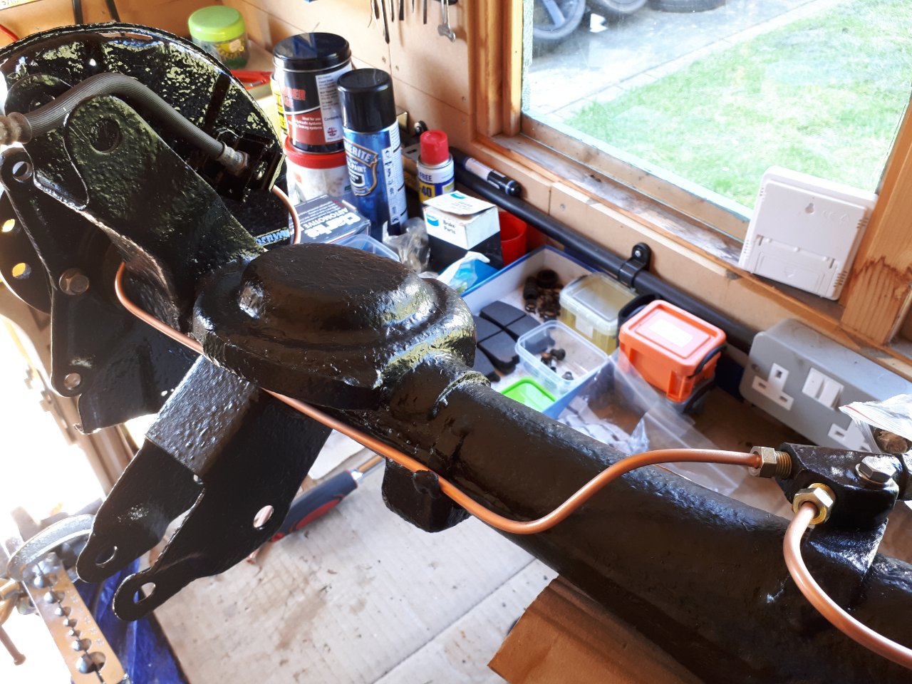

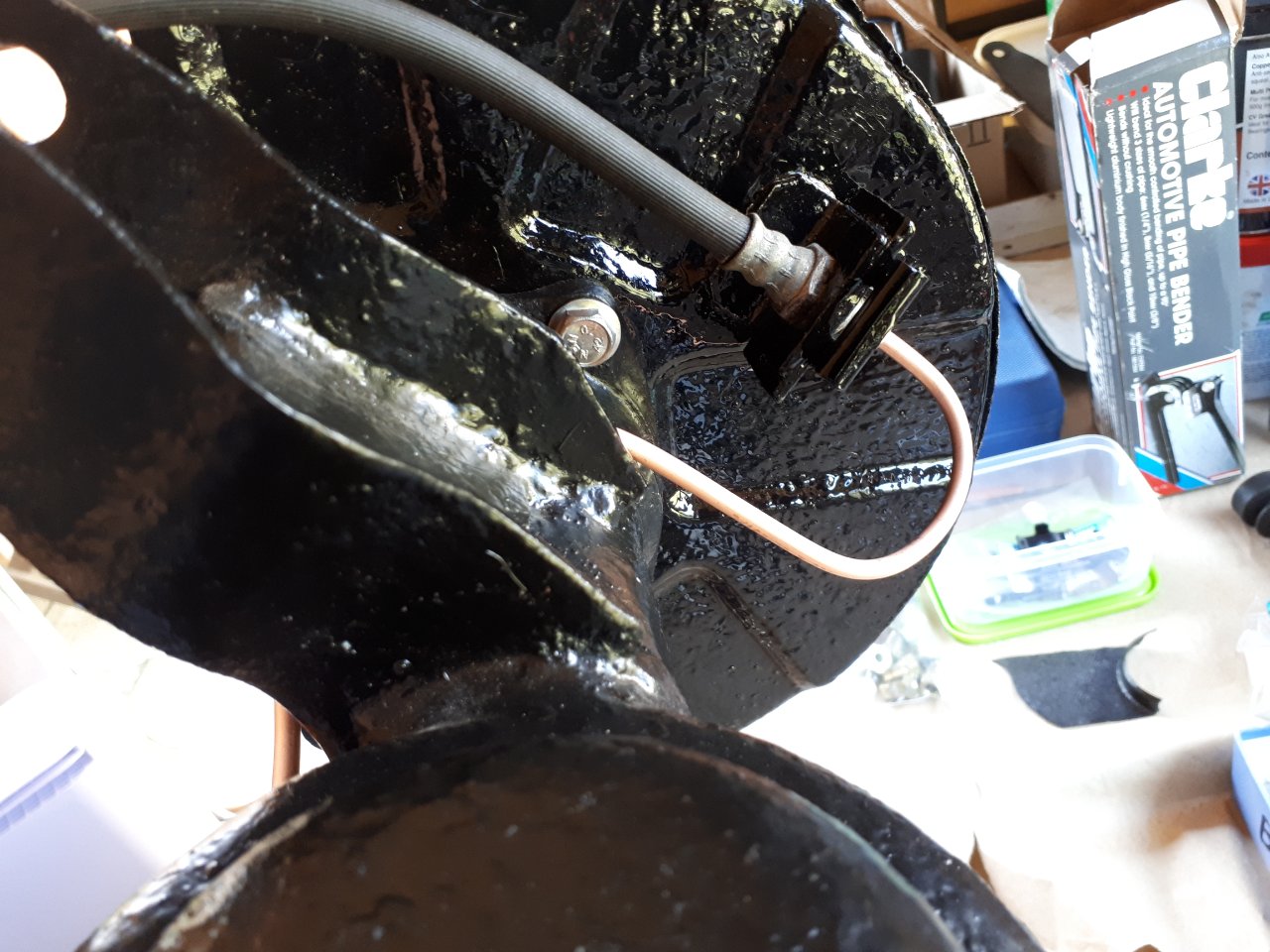

New brake lines installed:
2019-04-20 15.11.35.jpg (289.93 KiB) Viewed 4137 times
