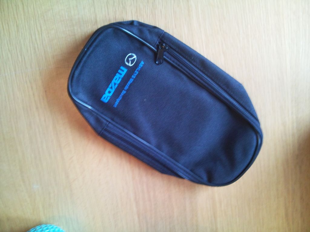

Aquired another handy gadget for the car, a mazda bag to hold my pre-mix bottle in, no more spillages in unwanted places.
'Dont fear the rotor'
there's a cool black with blue mazda logo clear plastic front bag for a one litre oil bottle i have with my rx8.
i keep it in the boot as it has some velcro to keep it attached to the carpet in the boot.
it'd be handy for any litre oil bottles with premix in them, as it would last you a good while.
