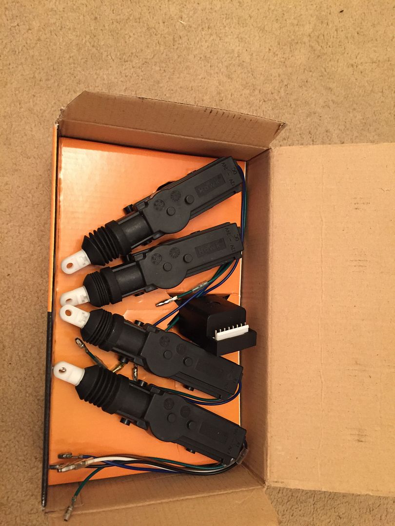

my central locking kit arrived today
looking forward to fitting this....

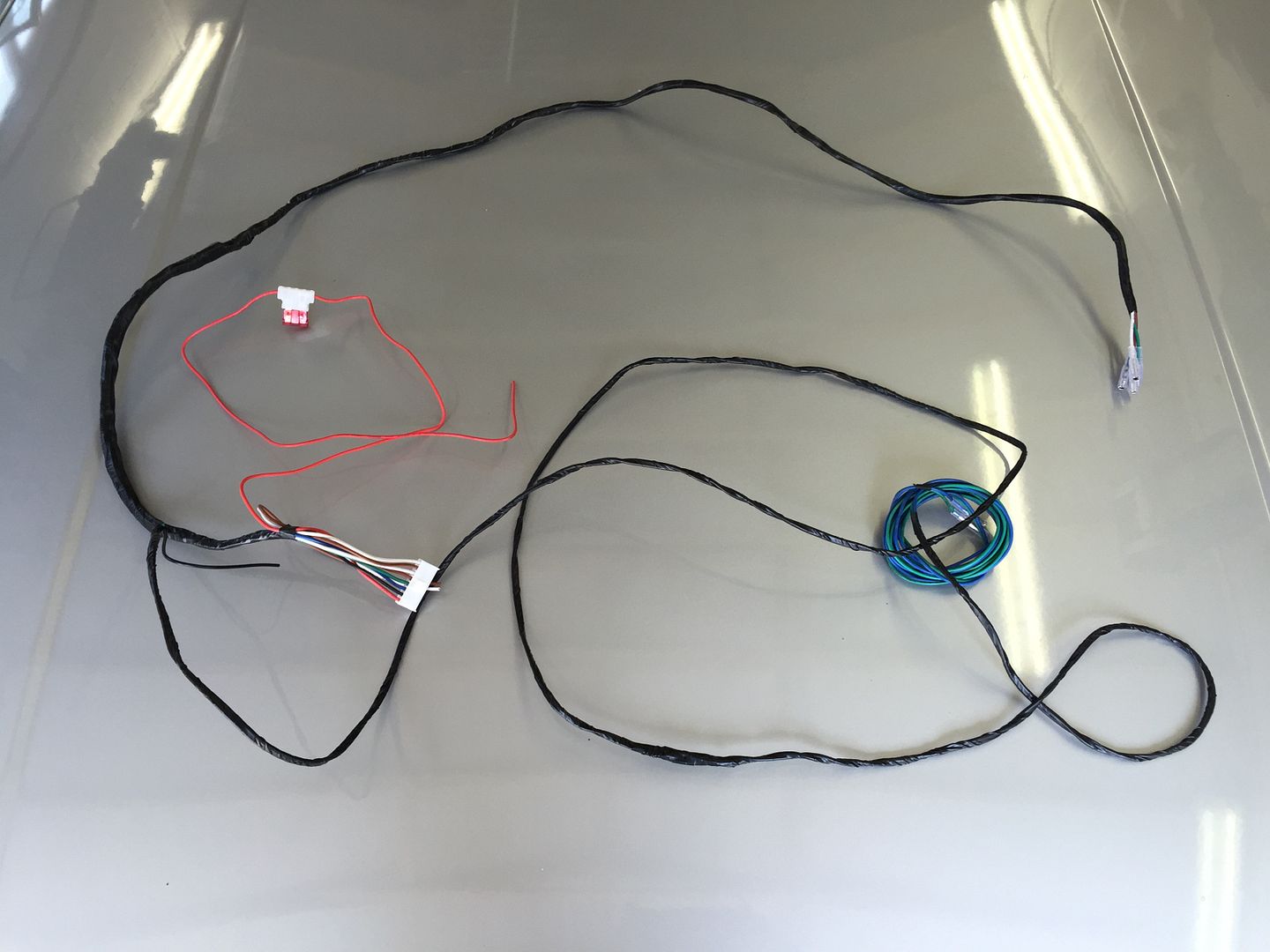

By following Keiths excellent writeup I Installed this central locking kit today and it's the business........ can't believe Mazda didn't install C/L from the factory......I didn't take many photos as I was too busy working on it....
it was time consuming because first I had to adapt the loom from a 4 door kit to a 2 door by removing the actuator supply wires that I didn't need and then binding the loom which took a while...
from this...
to this...
from this...
to this...

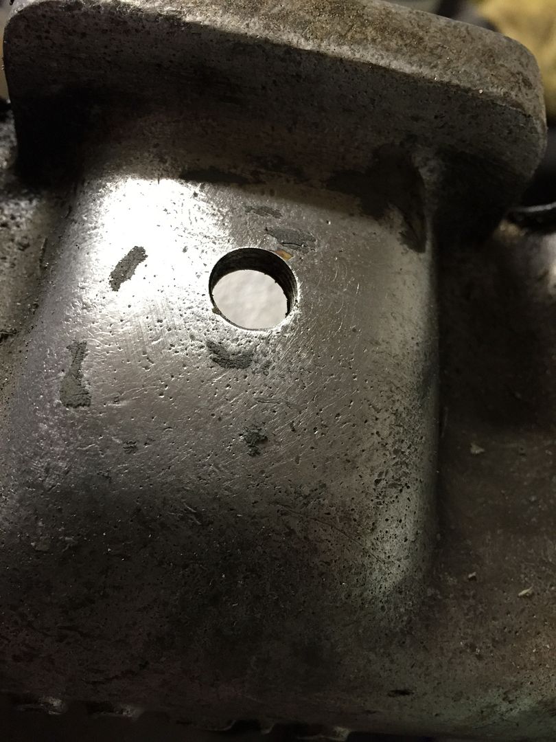

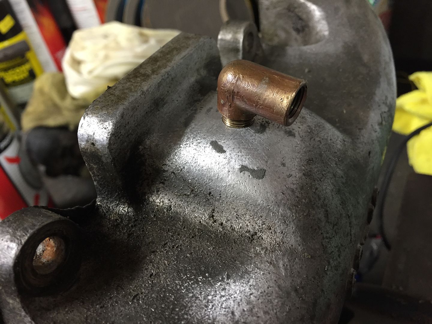

In my rush to get this car on the road for Retrorides Gathering after it's 20 year lay up, I made a couple of mistakes whilst putting the turbo on. First, I used a S3 exhaust gasket which didn't suit the Elford Turbo manifold and didn't cover the emission ports on the engine so the manifold gasket leaked.I swapped it for the proper gasket but again did a rushed job to get it mot'd and within a few days, it leaked again. Next, I had a leak somewhere on the inlet which produced a loud whistle.
I've lived with the annoying whistle and the fumes from the exhaust manifold leak coming into the car since last summer but as my Jaguar yet again needs open wallet surgery and I need to use the RX7 as a daily for the next few weeks, I thought I'd better sort these issues out.
I bought yet another exhaust manifold gasket from Rockauto, an inlet gasket from Mazda, some Garrett turbo gaskets and 20mm stainless core plugs off Ebay...
and tonight I stripped the turbo, carb and inlet off the car...
fitted the core plugs to block the unused water gallery...
there's a fuel drain on the bottom of the compressor that goes to the inlet and this was loose.... don't know if that was causing the whistle but it can't have helped.... put it back in tight now...
