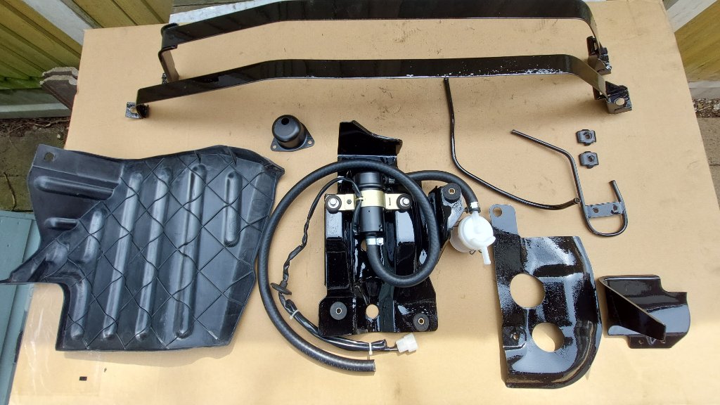

Cleaning and refreshing parts to go back on continues. I'm also treating some surface rust on the bodywork, only accessible with the tank out. Luckily there is not much there, so better to sort it now.
Progress so far:
Dibs' NOS tank with a spray of Hammerite satin. New sender, new hoses, new screws. new jubilee clamps.
Most of the remaining bits. Most metal parts have been painted with POR-15:

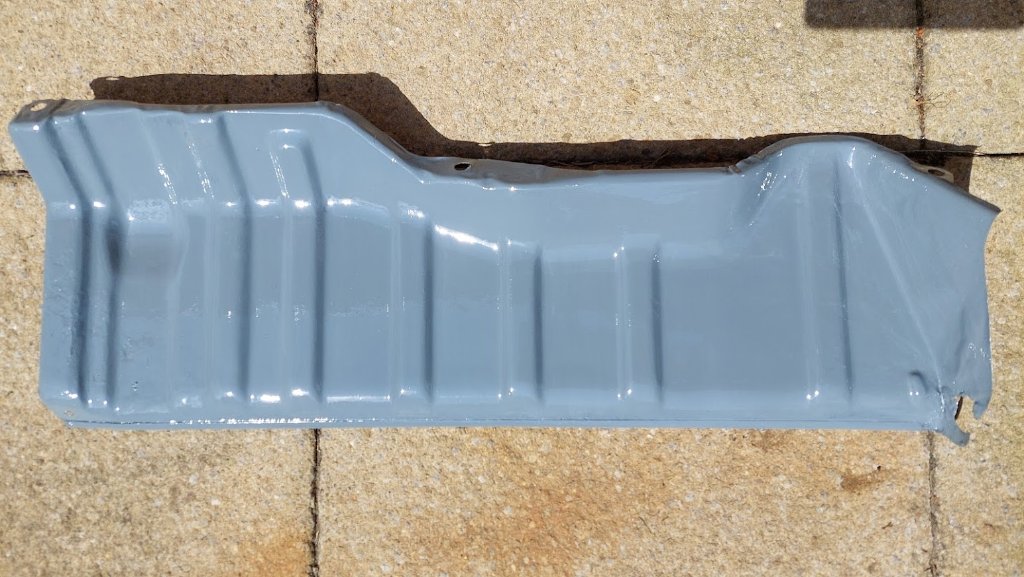

It was looking very tired, with some surface rust evident to the rear of the fuel tank.
So, a full POR-15 prep treatment and 2 coats of POR-15. I would have liked to have done more (like the axle!) but I know from experience how "job creep" extends the time off the road! This started as a simple, tank out, replace fuel sender, put tank back in. It has already extended well beyond that!
