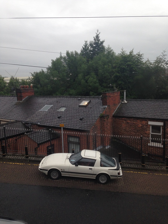

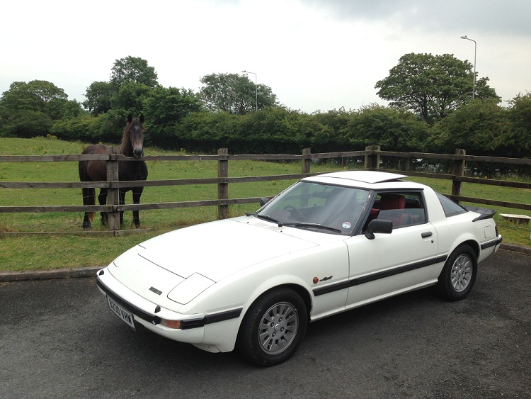

I know I've been quite on this recently so here's a quick update!
Rest assured that the car is still in my care! I moved to NYC rather abruptly with work for 12 or so months. I was driving the car for a couple of months before I left but it's now in dry storage with cover (courtesy of my dad). I took a few pictures but the photo's of the nitty gritty work are on my hard drive in the UK so I'm afraid you'll have to cope with my exterior phone ones for now.
I know how much everyone loves photo's:
So; it had a new gearbox from 'shaunwil' which is an NA S4 with S3 tail section. Fitted perfectly however 1st gear seemed quite short (probably the shorter ratio of the NA box vs. 12At). The car drove very well and the engine is exceptionally smooth. The only hiccup I had was the idle control cable popped out of the throttle body and caused a stall when rolling up to a red light. In all honesty though the throttle and idle cables do need replacing - the throttle cable more so as it has started to fray. Also, the gearbox has a slight leak. I don't know where this is coming from but it'll have to wait for now. She'll get turned over every fortnight and pootled up and down the drive.
Work and updates will resume when I'm back in blighty!
