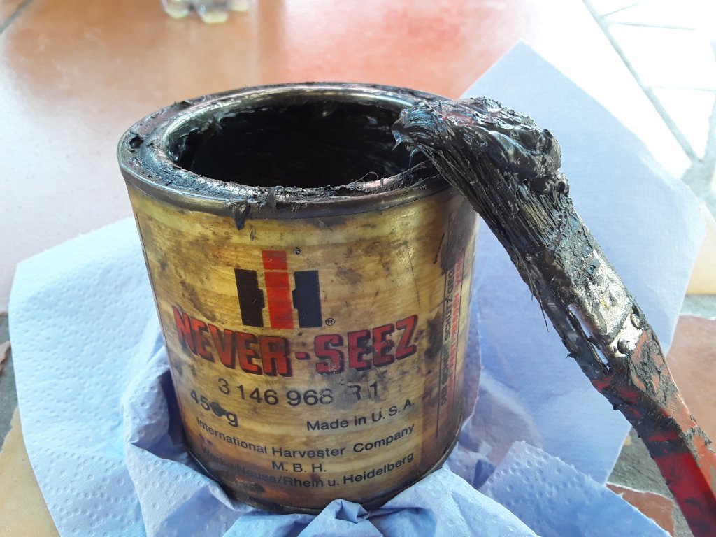

Thomas .....I use a special additive in the Bearings........you can see the Yellow & White (Gelb und Weiss) splatter on wheel arch, comes in special containers :o

"Yellow" your bearings will corroded more quick then ? I only can see the standard red grease in your bearings and the rest of the old gold spray can you've smeared everywhere..?.... -haha-
My mystic grease help with the extremly wheel set up dishes -6mm on my car. :lol:

Gotcha Thomas............My "Mystic Grease" yay yay
Senf und Mayo
