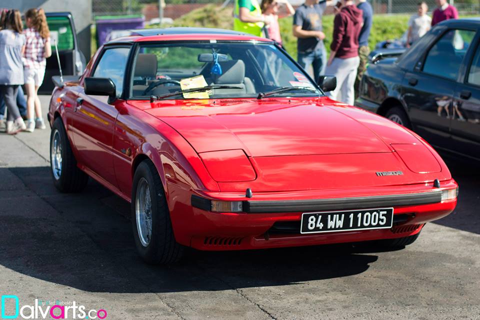

Ireland need a lot of signs on the license plate.Big country, isn't it?
Mesh wheel are my choose.
Colour called "kirschrot" in germany with grey interior
Re: '84 FB
Ha, yeah, its YEAR - COUNTY - NUMBER, but imports start off at 11000 for pre-90s I think, and 120000 for later years! The plates get pretty ugly!
