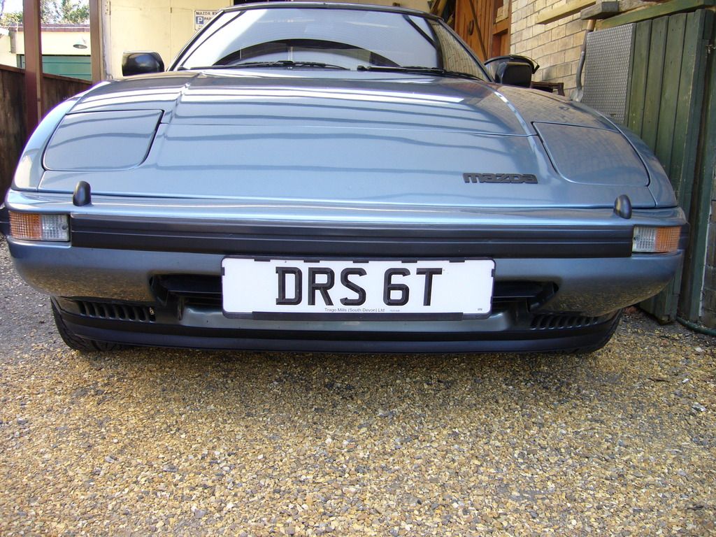

Finally I fitted a rubber (self adhesive back) mini spoiler to match the rear
