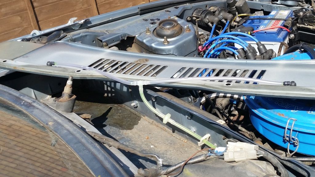

I popped into Waitrose in Malvern a while ago and tried to clean my windscreen but nothing came out. I could hear the motor and I knew the bottle wasn't empty - weird. Took off the cowling panel thing when I got home to find this :o
That Y connector was extremely brittle and must of finally given up and exploded. The tubing was pretty nasty also. An hour out at the car on a sunny afternoon was plenty of time to get it done in between chatting to the neighbours and people walking past :lol: Ended up looking like like this
I ordered 2 meters of 4mm of PVC tube, 1x 4mm T connector and 1x 4mm one-way valve from this seller http://stores.ebay.co.uk/pvctubeonlineltd/

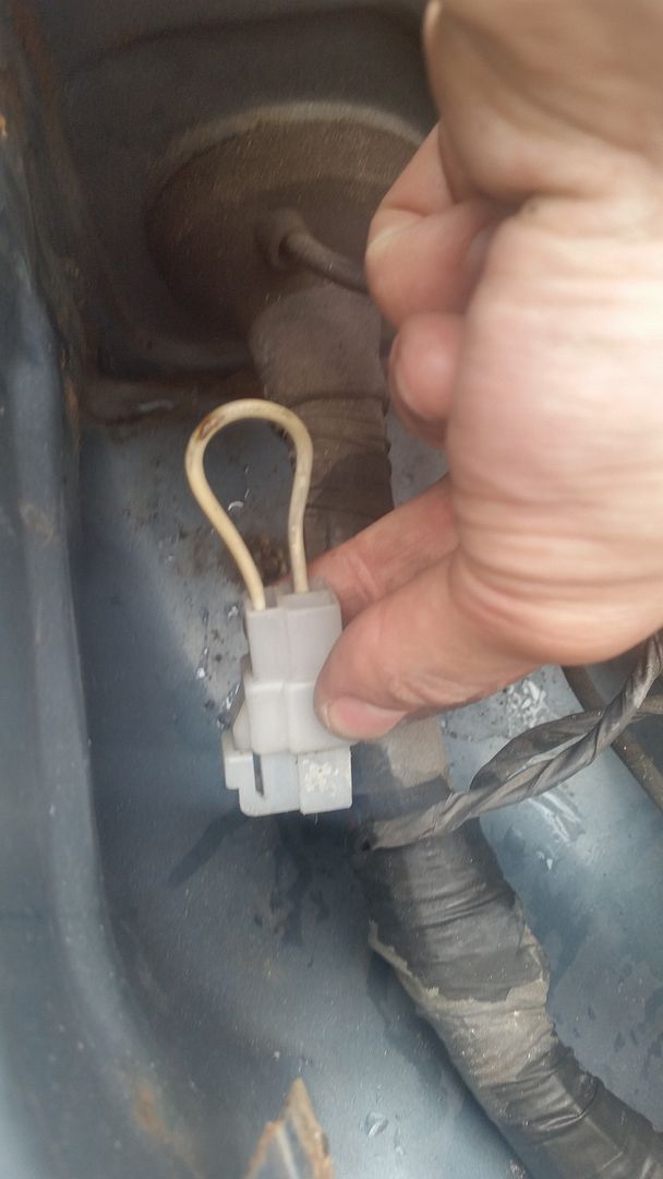

Also this plug just has a wire looping from one hole to another. Any ideas? This one is at the passenger side firewall :?

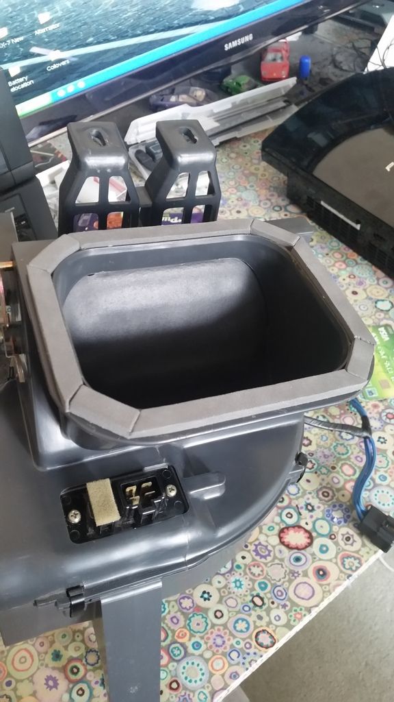

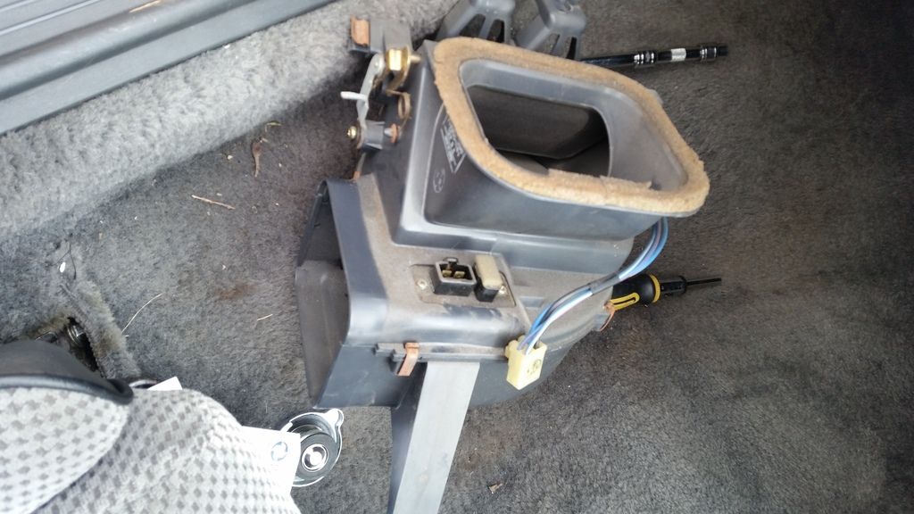

Went out to put something in the car and ended up taking the heater blower motor out. As you do :lol: Ian's heater rebuild thread gave me a bit of inspiration to clean it up. Although I have the dash in which is why I only done the blower motor :D
Caked in dust. Touching that top bit of foam permanently squished it flat :shock:
All cleaned up. The flap that goes inside was in pretty good condition so I just gave it a wipe with a damp cloth and it was fine.
I replaced the foam with 1m x 10mm width x 6mm thickness from the following link. Seemed to seal up and fit really nice when I put it all back in. :)

The blower motor is easy as to remove. 3 nuts, wiring connector and the cable that moves the flap. 2 minutes later and a little wiggling then it should be out. The main heater controls on the other hand :shock: Can wait 'til I have the dash out ha.
